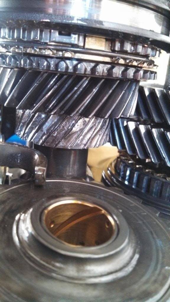

    Got this pic earlier today
    I kinda wanna get an ep3 5 speed gear set have it shot peened and put that in, but I'm not sure if I will have enough time for that. Maybe that can be a summe project and for now I just get the car running.

    Thats a good looking 2nd gear you have there. Did it break any teeth off of the gear on the countershsft or just the main?
    s4 petefromthestreets
    I think the counter is ok. But I didn't take this picture nor have I seen it in person. Hopefully will know some more today.

    Bringing some good discussion over from 8th.

    He didn't break just "2nd gear" The mainshaft needs replaced. 2nd gear doesn't come off of the mainshaft its one solid piece.

    which includes the gear right? since its one peice? it looked like just the gear was damaged in the picture doe.

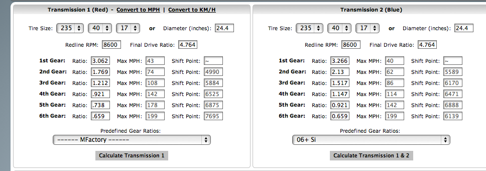

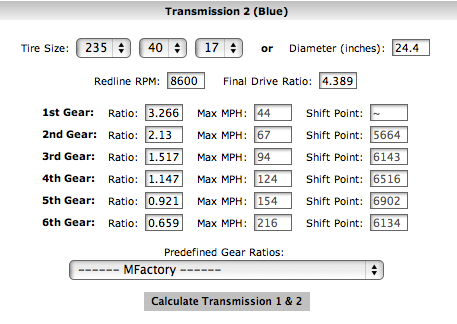

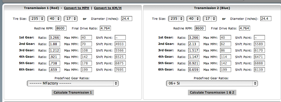

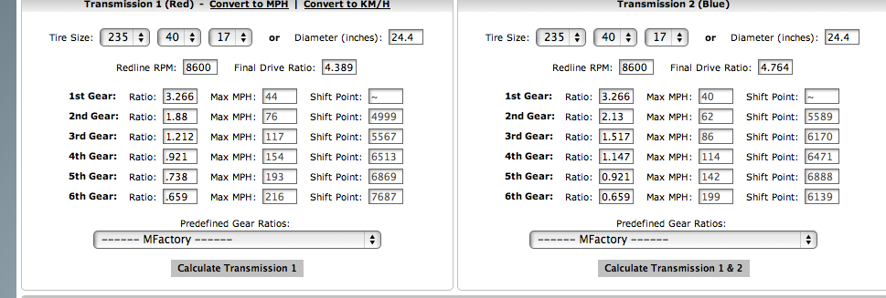

    Here are some charts I made up. Ryan the rsx base and ep3 are ALMOST the same but slightly different ratios for 1st and 2nd and the rsx using a 4.7 fd and the ep3 is a 4.3 fd. I think either one would work fine, but I would use the 4.7 for both. I would not want the 4.3 that comes in the ep3 as the gears are just a bit too long for my needs. Hell even with the 4.7 they are pretty damn long.
    Here is the rsx base with our fd (would reuse that from my case probably) next to our stock transmission (this one and the next are very very similar)
    Here is the ep3 trans with its stock 4.7 fd next to our stock trans
    And here is the rsx trans with its stock 4.3 fd next to our stock trans (way too long imo, I def do not need 4th to go to 150+)
    LMK what you guys think!
    This is our trans with 4.3 fd. These are some nice ratios, but I need to consider the cost as well. The rsx trans is much cheaper.

    There is a gear for 1-6 on both the main shaft and countershaft. They mesh together. The mainshaft is spun by the engine, it transfers that energy to the countershaft which spins the final drive spinning the Axles.
    You broke the mainshaft 2nd, which doesn't come off.

    Ya I agree with you to a point, but I intend to be around 420-450whp and that's good power, with gears this long and a 4psi wastegate spring I may not have many issues with traction, and I don't think it would slow the car down much, but I will speak with Bill about it as he at one point put the 5 speed in his rsx. And yes I can just get the mainshaft for 180, but other gears appear to be damaged just looking at the picture so if others are somewhat damaged it may not be a bad thing to replace them. Although I may consider just doing a quick for for now and doing something different for the trans in the summer with some shot peening and what not, just not sure if I have the time to get gears shot peened right now.
    Quote Originally Posted by asdf
    Yeah the mainshaft 2nd is built into the mainshaft. if counter 2nd gear is fine then all you need is the mainshaft.
