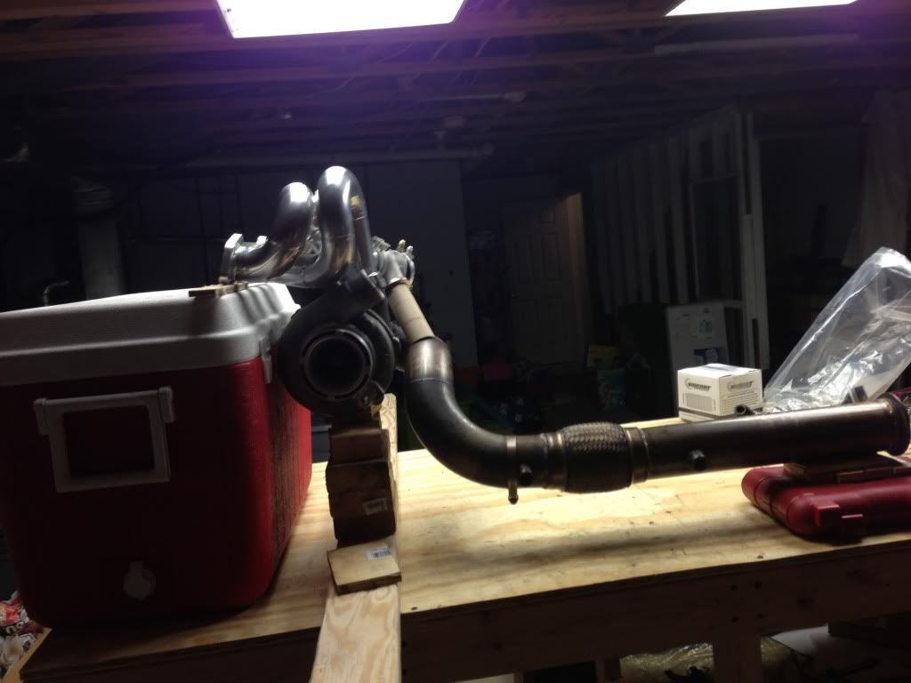

Also last night I got some work done, got the passenger mount back in, that took quite a while... Also put the manifold and turbo in place to check for fitment:

The downpipe fits too and I would have had a picture of that, but my phone died.

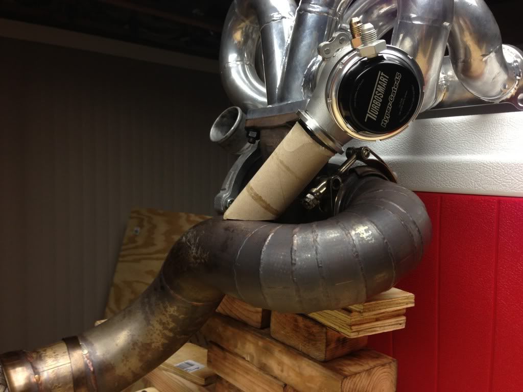

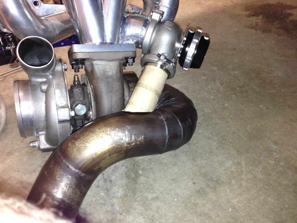

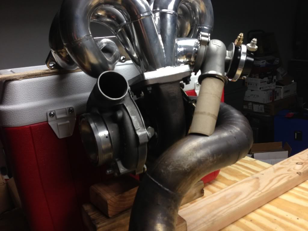

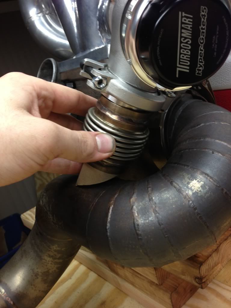

Did some ghetto rigging today ;) looks like I can pretty easily get this recirculated and have a flex pipe, just not sure if a vband flange and clamp will also fit, here are some pictures of my awesome jig:

O yea that'd be nice man.
I just recently pulled a revhard turbo kit off a ep3 I'm tucking and the shop that did his work recirculated his wg too with that same flex pc u have there, and it looks sick suck u won't be able to hear the gate scream no mo and also it'll leak if the clamps ain't appropriately tightened. His had been leaking creating boost issues.

Why no flex
it looks good yes but... but...
Meant to add in post but forgot, the flex pipe wasnt going to fit in that space. It turned out that it was a slightly larger diameter so a pipe would have has to be welded into it to weld it to the flange and that just made it too long to fit. I'm really not to concerned with lining things up, I know two other people that have recirculated dumptube a very similar to this with no flex pipe and they have no problems. I'm going to just install it as is since it is cocked correctly and I can get the whole assembly in place as long as the subframe is off, which it is.
