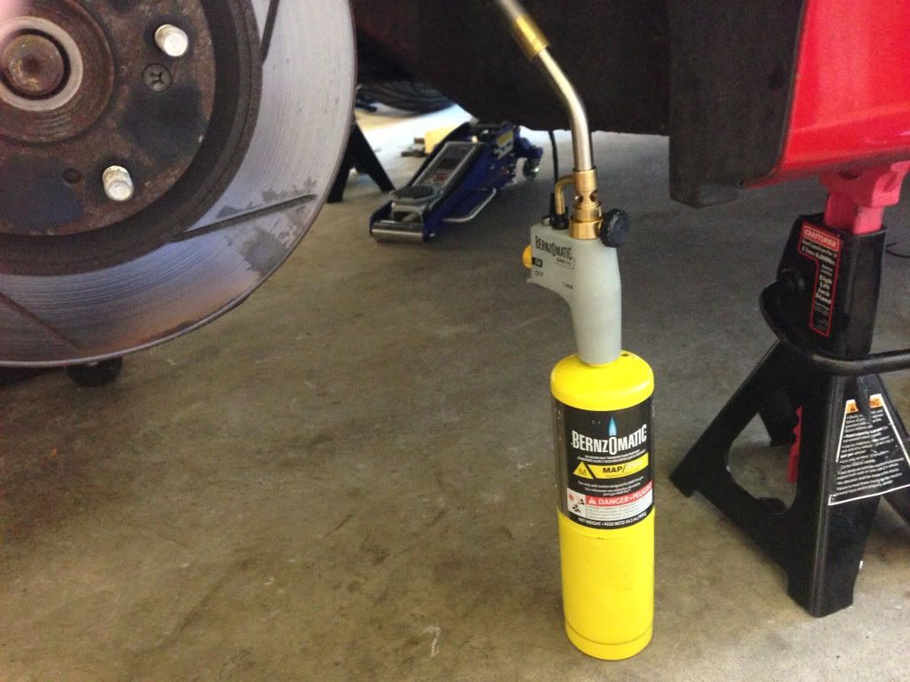

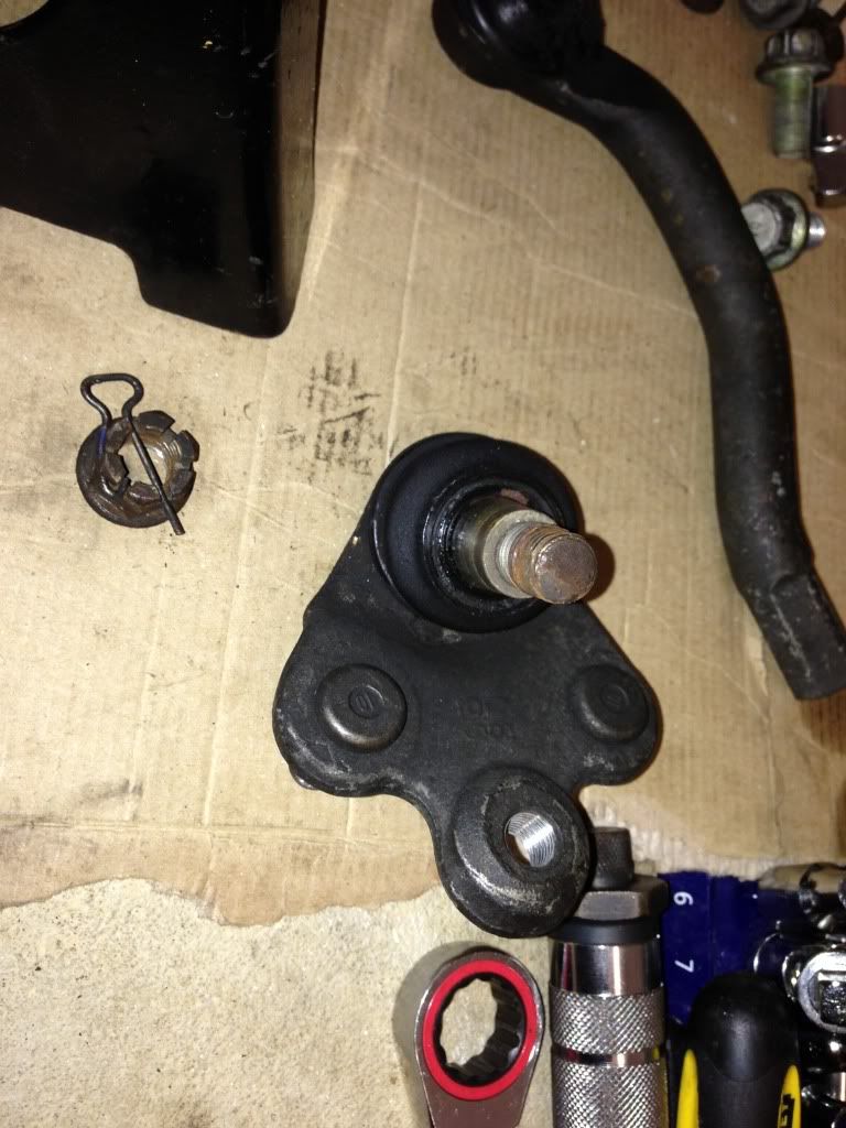

I started removing my subframe yesterday in preparation for when my manifold arrives (hopefully end of this week, early next) and ran into some nuts/bolts that didn't want to break free - the ones that connect the LCA to the hub. Had to go buy a torch, but did get them free... The last time I dropped the subframe I did it different, dropping the hubs with the subframe since I only had hand tools at that time.

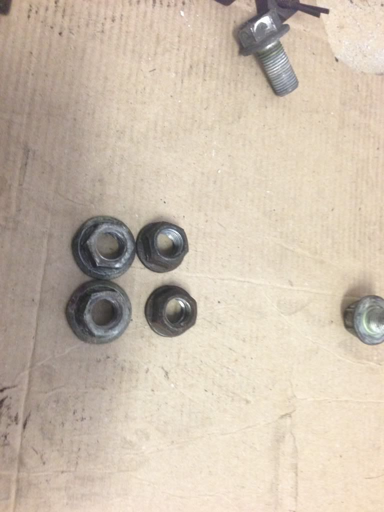

Once I got them off I noticed this:
The larger ones are from the driver's side, the smaller ones are from the passenger side...

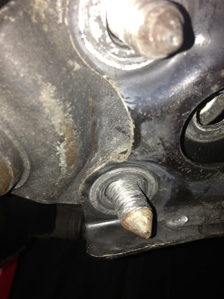

Also one of the nuts on the driver's side took the impact a LONG time to take off even once it was broken free and basically off completely... It appeared as though it was cross threaded, or became cross threaded somehow. The threads on that stud and the nut are messed up. How hard is it to take that stud out? I already ordered new nuts last night when the couple nuts started to strip.
(best picture I could get of nut with phone camera)
Anyways, they are all off, now I can at least continue with the job.

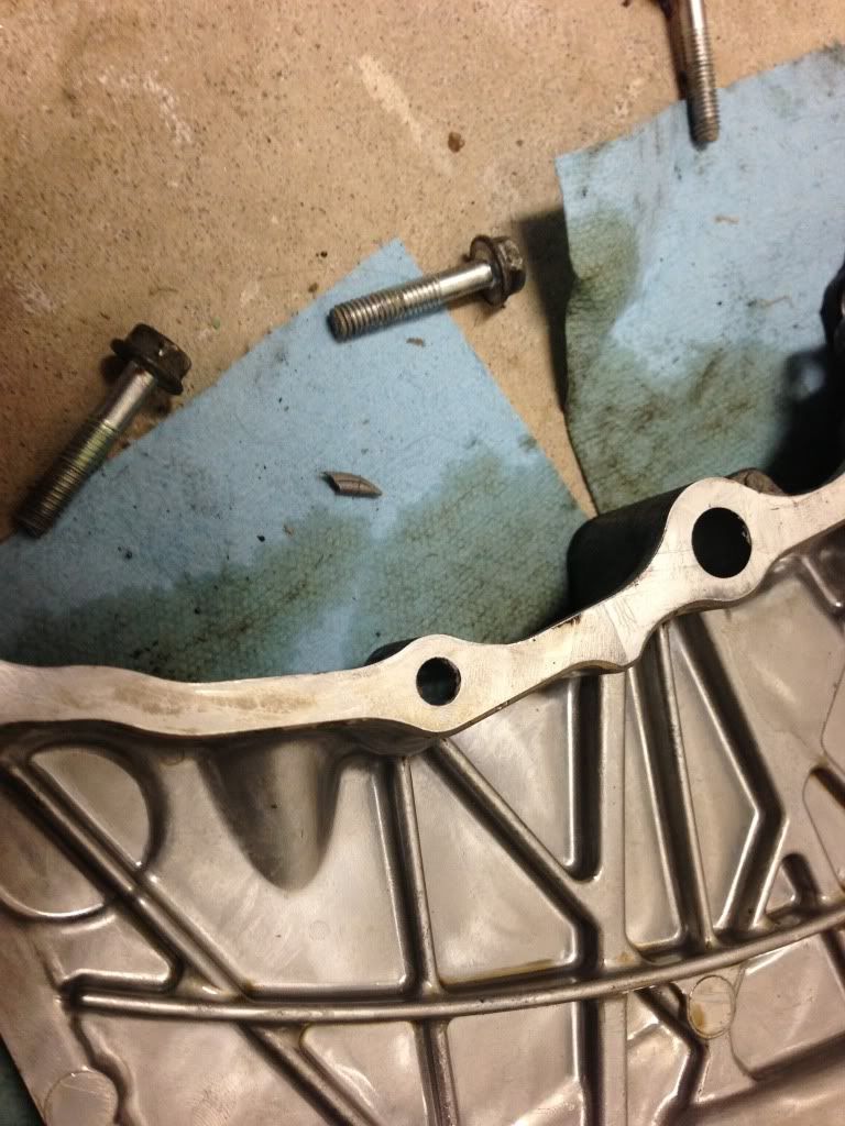

I used enough honda bond for it to seal properly, I really don't want to do this again anytime soon. I also finished removing the subframe and got the manifold, downpipe, turbo, etc. out.
