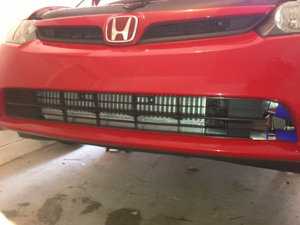

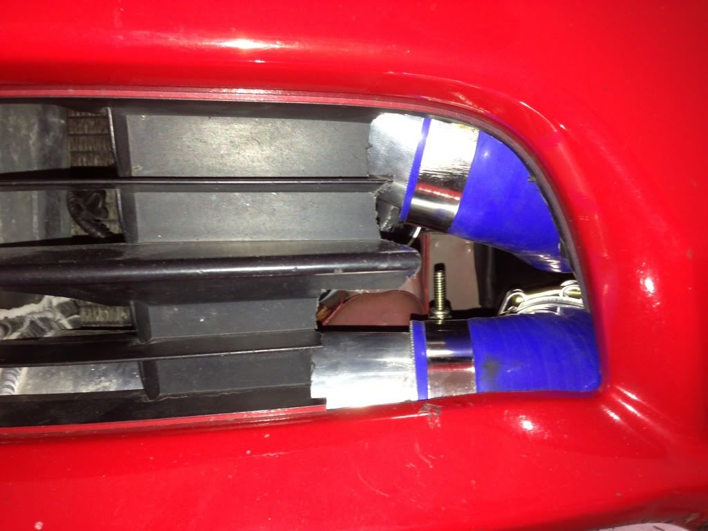

    1,889
    Here are pics of the intercooler and how it doesn't fit. Its really the pipes that come off it, not the cooler itself.
    I know the cut doesn't look great, I was attempting to cut as little as possible, but after a few tries it ended up needing to be cut a bit more than I first thought and it got late and decided I would eventually take it all off, so we just cut it so I could get the bumper on.
