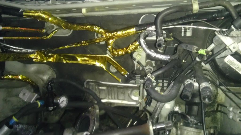

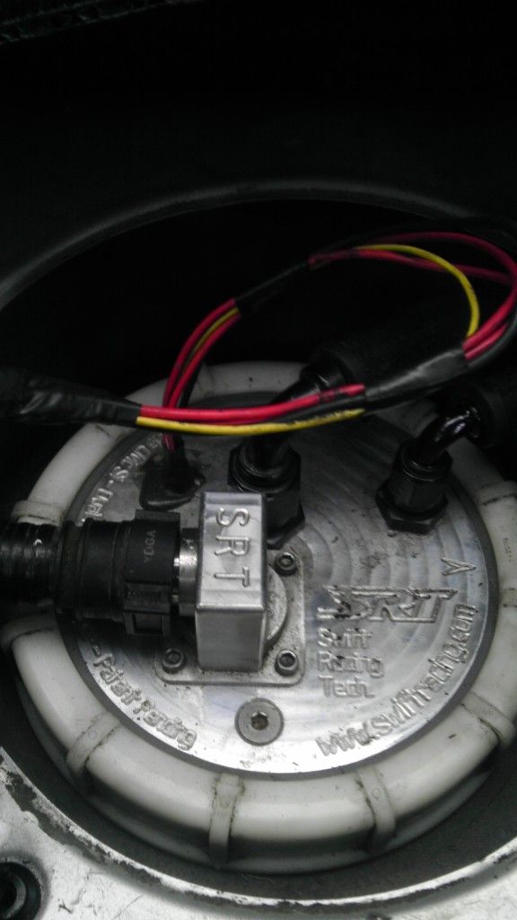

    Straight trade for my JRSC, aftercooler, header, and exhuast to get a jo-tech turbo kit
    Full turbo build specs:
    Jo-tech turbo kit
    Pt 62/62 turbo with a .68 ar
    2.5in charge piping w/intercooler rated at 650
    Go power 1k injectors
    Hondata flashpro
    4bar map sensor
    DW300lph fuel pump
    Tial wastegate
    Tial BOV
    Em1 cmc
    Competition state 4 clutch
    3in downpipe
    Q300 exhaust
    HFP suspension w/ sportline springs
    Buddy club camber arms
    Ingualls front camber bushings

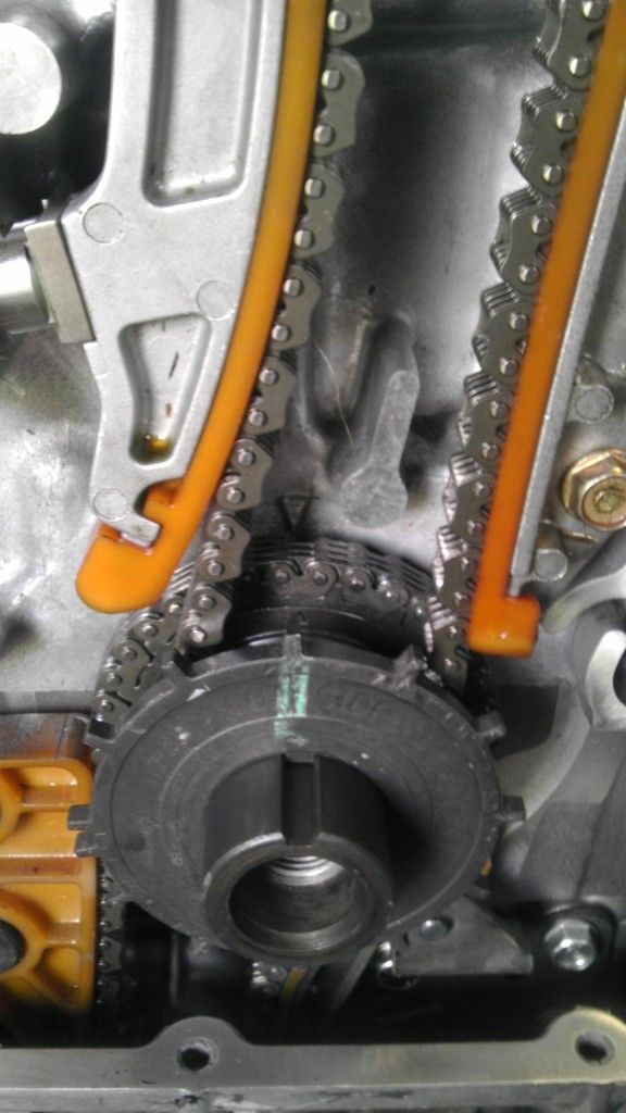

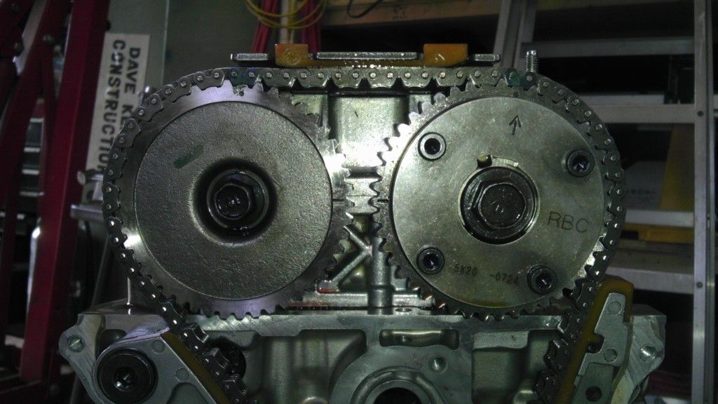

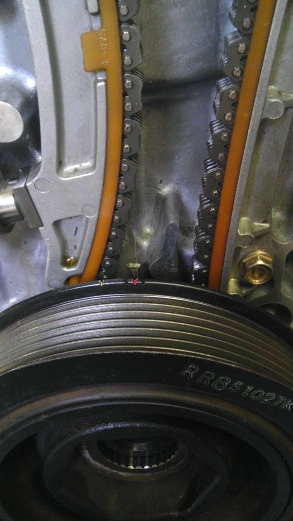

    :sadbanana: Unfortunately my turbo’s oil seal blew, I had to take the whole sub frame down again and replace it :sadbanana:
    O well I rebuilt the turbo myself! I like to learn new things
    FMIC:
    Everthing was going great until my tires started to spin while tuning! So I bought hancook v12s
    The day I installed them I went for a nice ride, and slipped my clutch because the tires gripped better! I knew it was a matter of time on the stock clutch!
    Dropped the subframe sorry for the bad picture!:
    Transmission off, to the left is the stock clutch!
    Engine without the tranny and a good turbo shot!
    I ended up installing a Competition stage 4 clutch!
