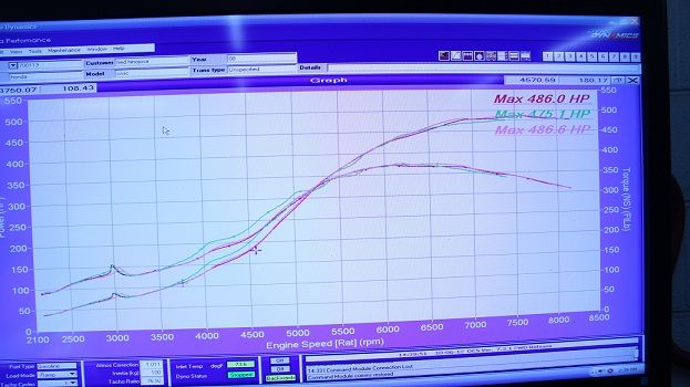

    My first pull on the dyno made 475HP and the tires smoked and rubber went flying lol

    I looked through my datalogs and this was the first dyno pull and it hit 22psi and held but all the pulls after this dyno pull were at 15psi so I didnt have a boost leak until after this dyno pull. This was my lowest reading of the day too at 475HP. My later pulls I ended up with 486HP@15psi
    "Rubber went flying" LOL
