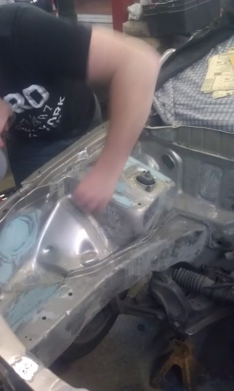

    Well i thought id start a build thread on this site. Its been a long time project (since i bought it in 03). Like everyone, car starts off with the little mods then quickly blows up. I went from a boosted b18b1 with 275 and 250 to a k20a2 turbo.

    [/img]
