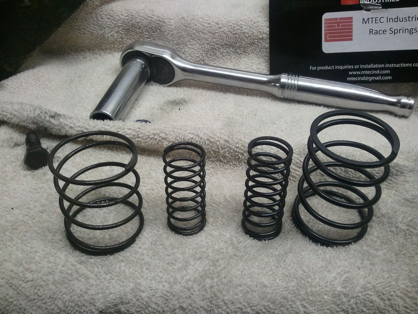

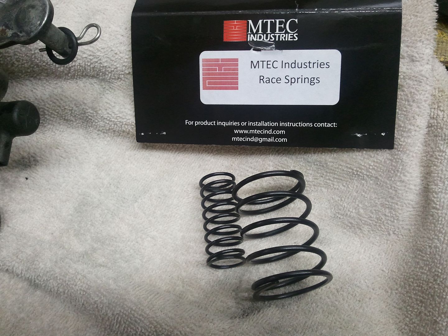

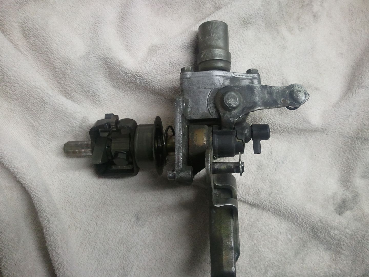

    Ok so tonights update.. I installed my MTEC race springs... and I'm seriously excited to try these out...

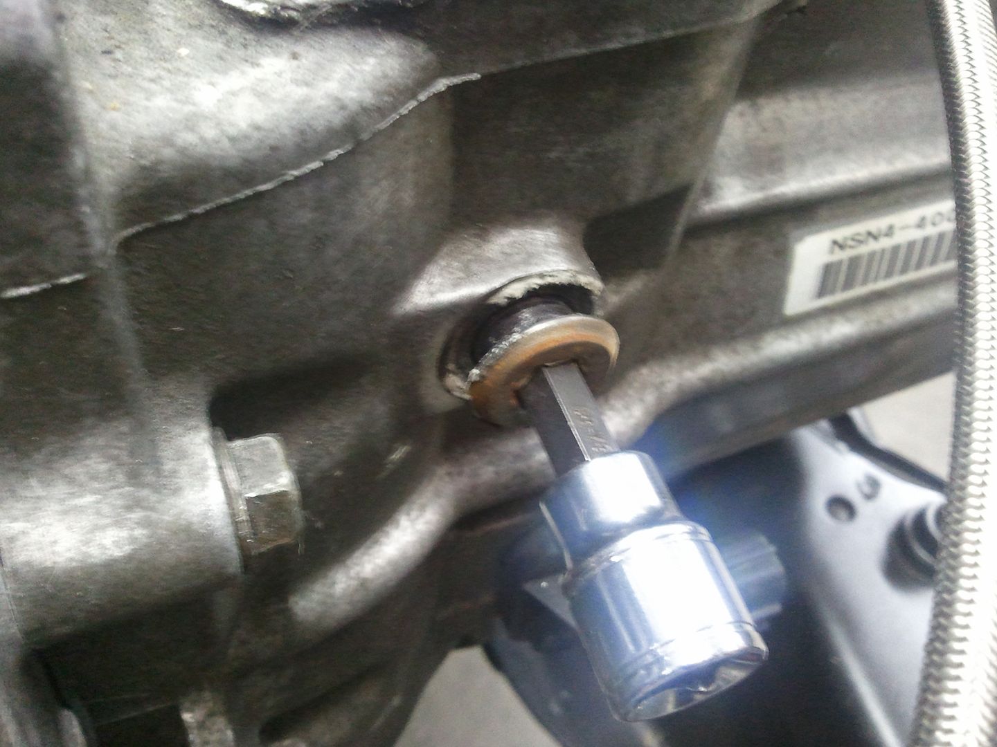

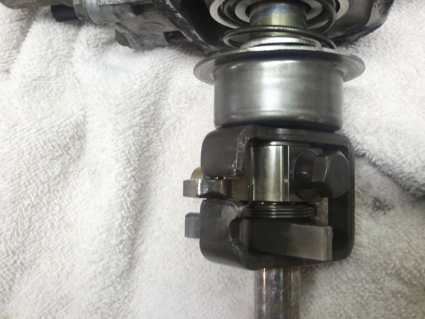

    So first unbolt these four main top bolts
    and this allen bolt on the side
    Then pry up and pull out
    Now unbolt this 14mm bolt
    By looks not horrible different... but squeeze them and WOW what a difference!
    Put it back together and instal...
    Now instal honda Bond and put back together and call it a day

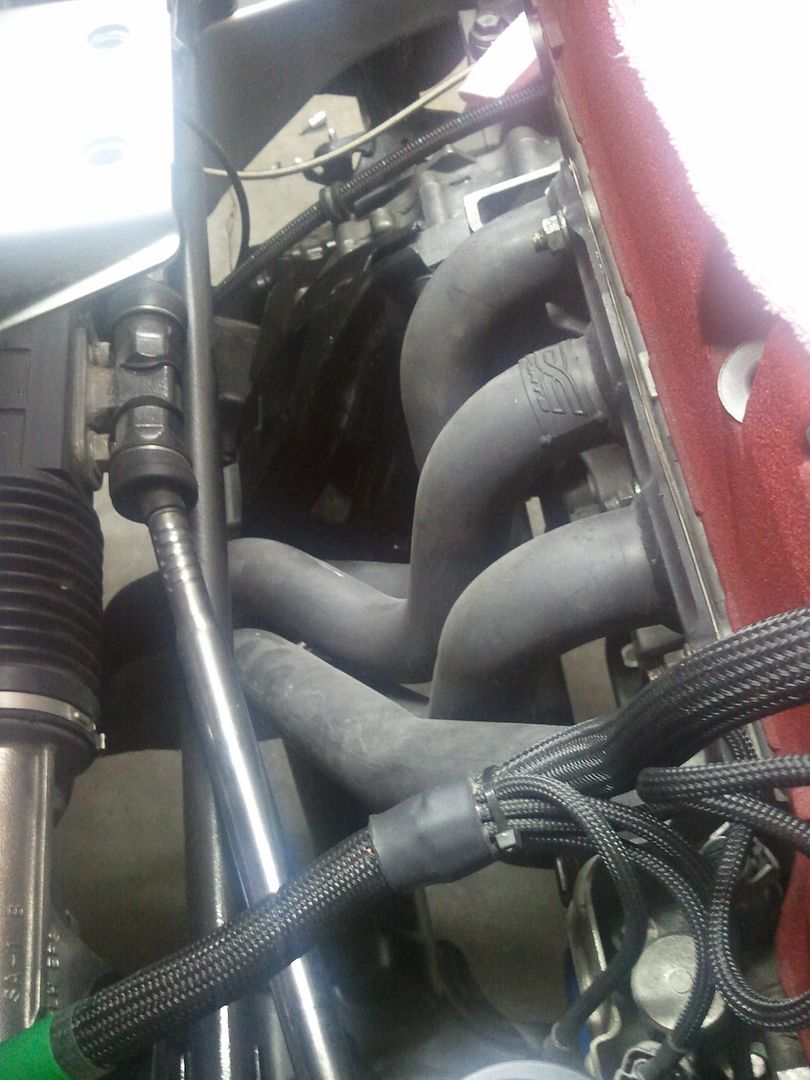

    As for you non believers of me going back to NA here is my manifold...
    Modified DC RH for my K24... Sorry guys no turbo...

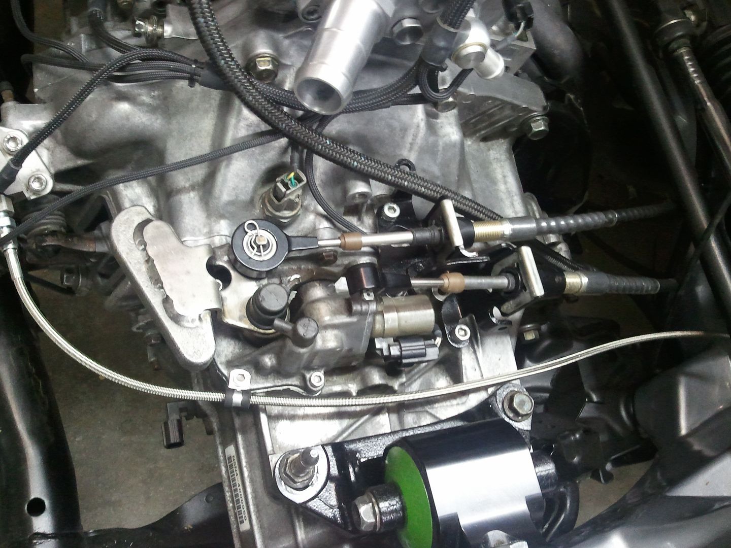

    and I reinstalled my shifter cables. Love these Hybrid Racing Cables

    You'll enjoy those shifter springs. They are boss status with the hybrid cables!

    I have the mtec springs and they are awesome. I've been thinking of getting hybrid cables....what difference are they over stock?

    I know it wasn't directly asked to me but...
    Shifting feels very precise. There is very little flex so when ripping gears your less likely to miss due to cables flexing apart. Also a little tip with cable trans cars is to use heavy duty zip ties and tie the 2 cables together. This will further prevent missing from a flexing set of cables.

    Right on yeah mine are zip tied together I just want to know if a new set of cables would be worth the money. I may give them a shot

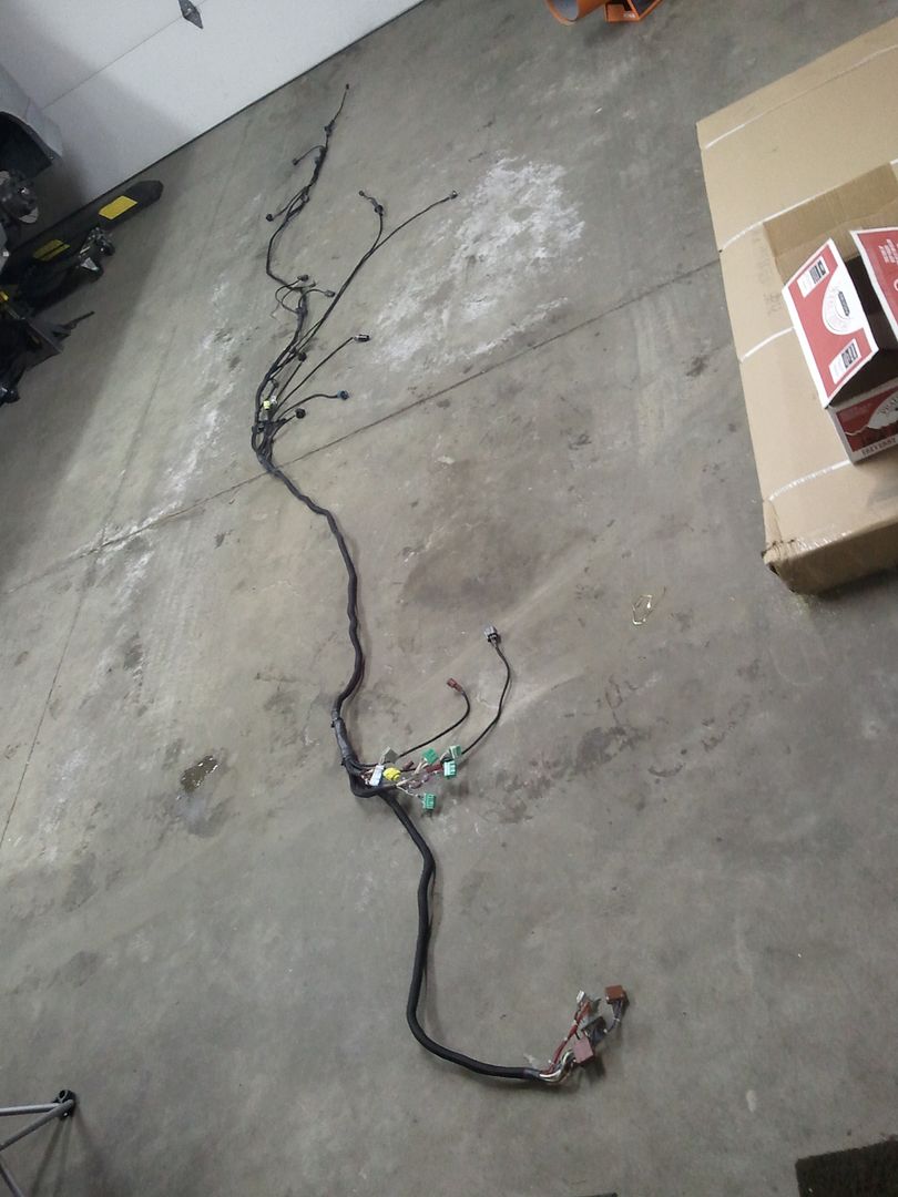

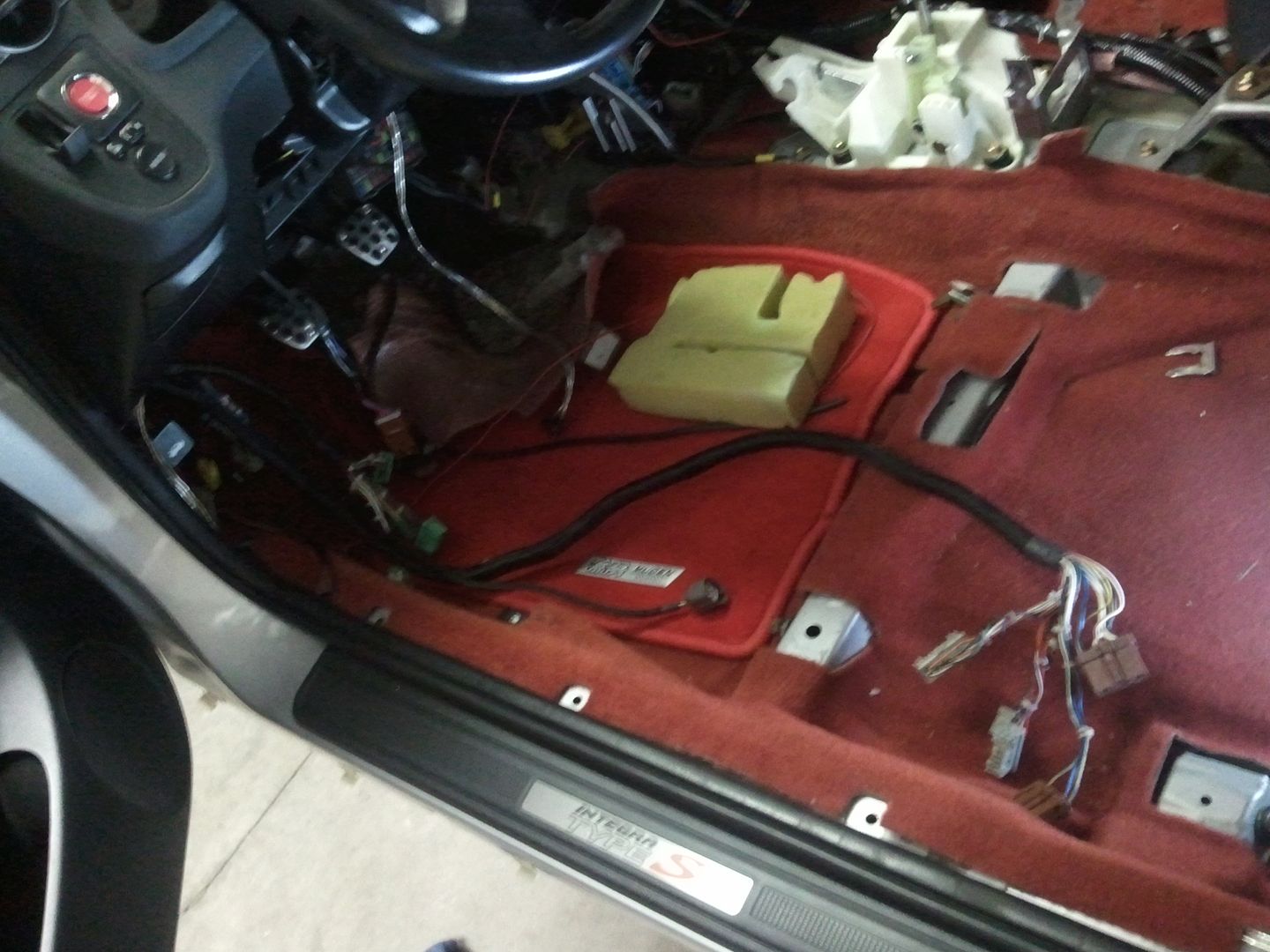

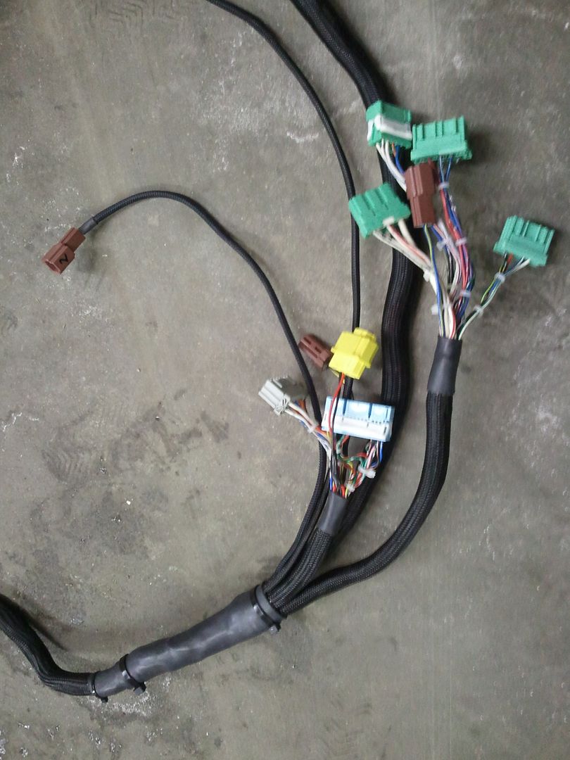

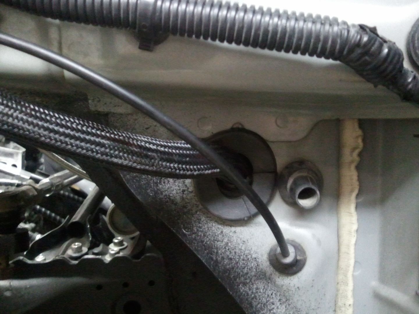

    Well some updates from last night... got my fuse box harness back and finished. So far it look great. Special thanks to my buddy Chuck

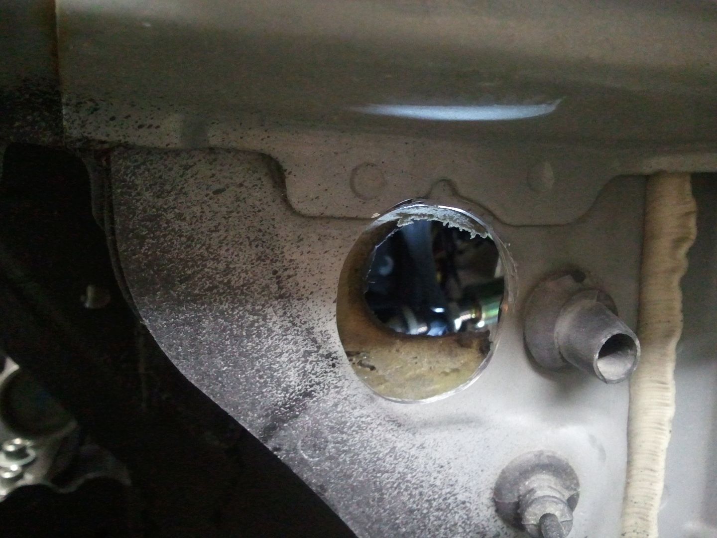

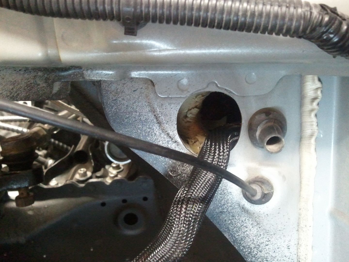

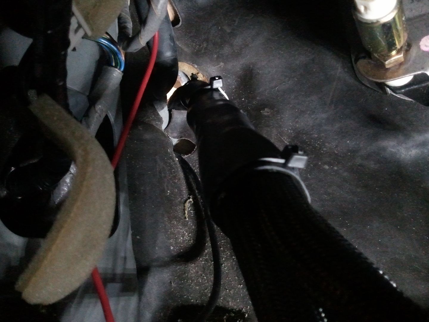

    So I bored out this hole to go into the car

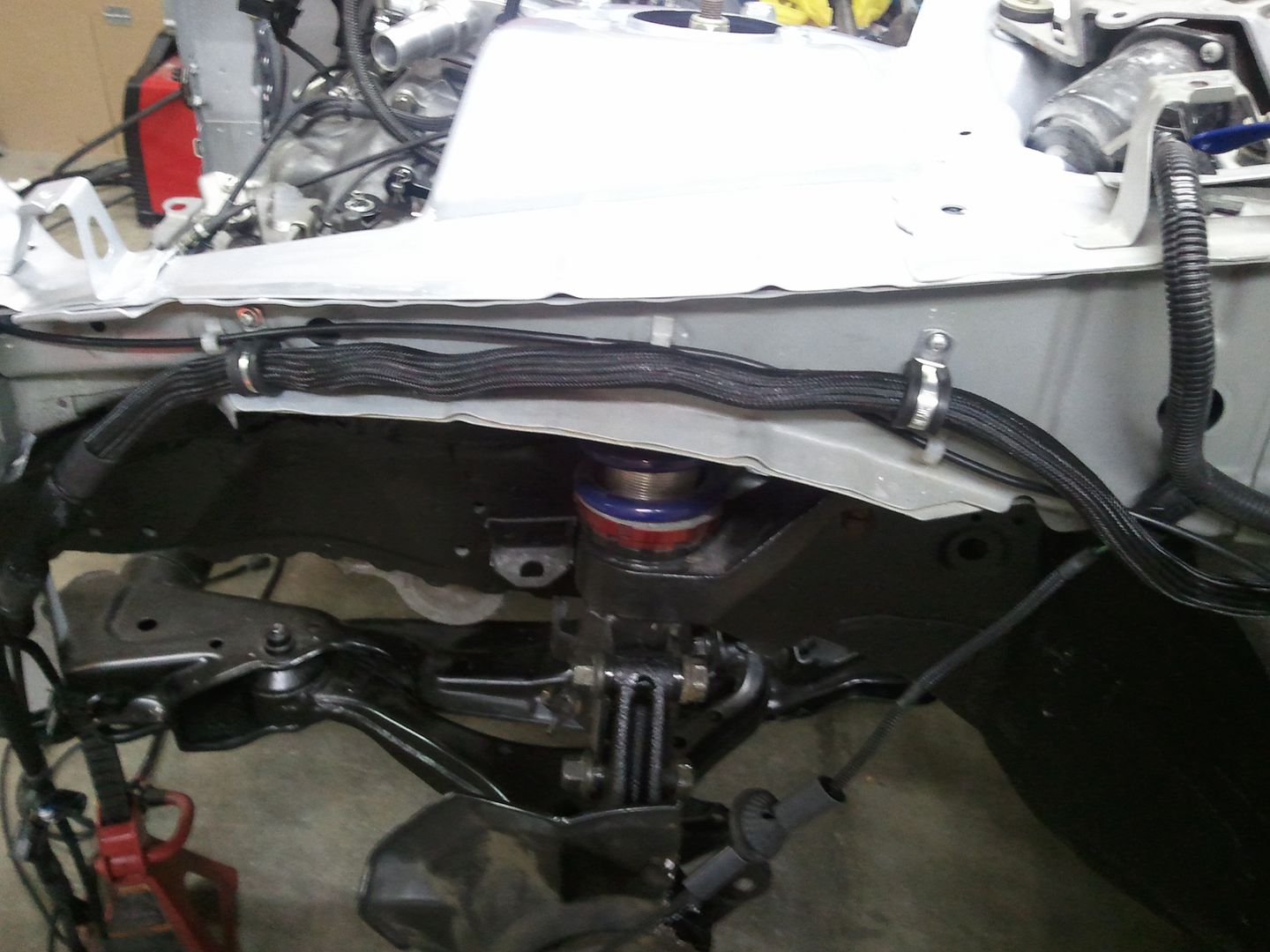

    And started stuffing the line through to the inside
    Was a real pain in the ass but it got in there
    Then kinda mocked it up and bolted it down
    and made a grommet fit

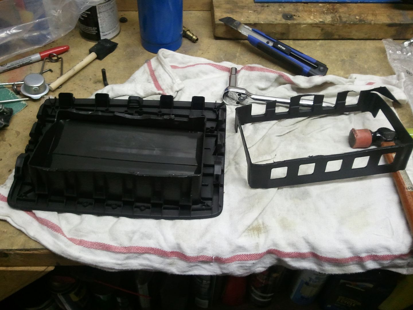

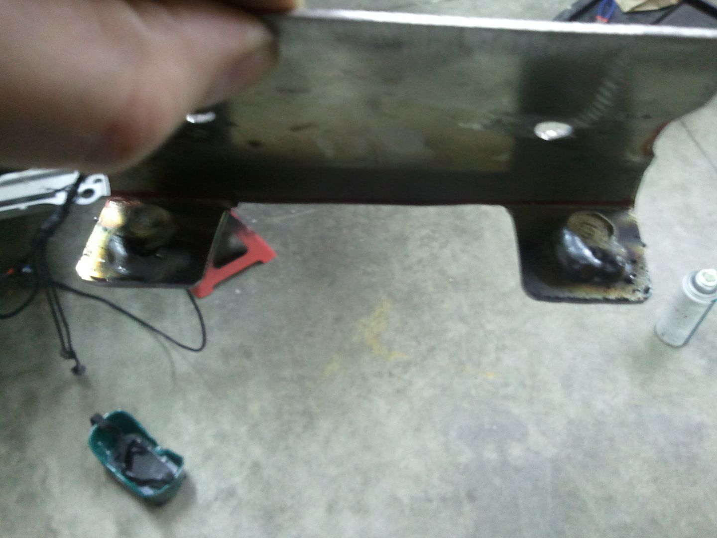

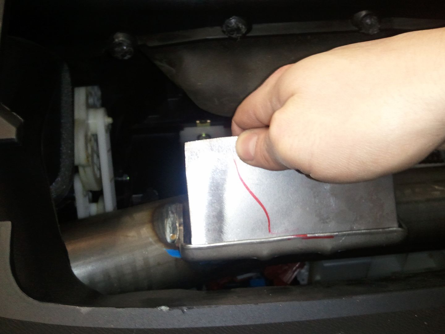

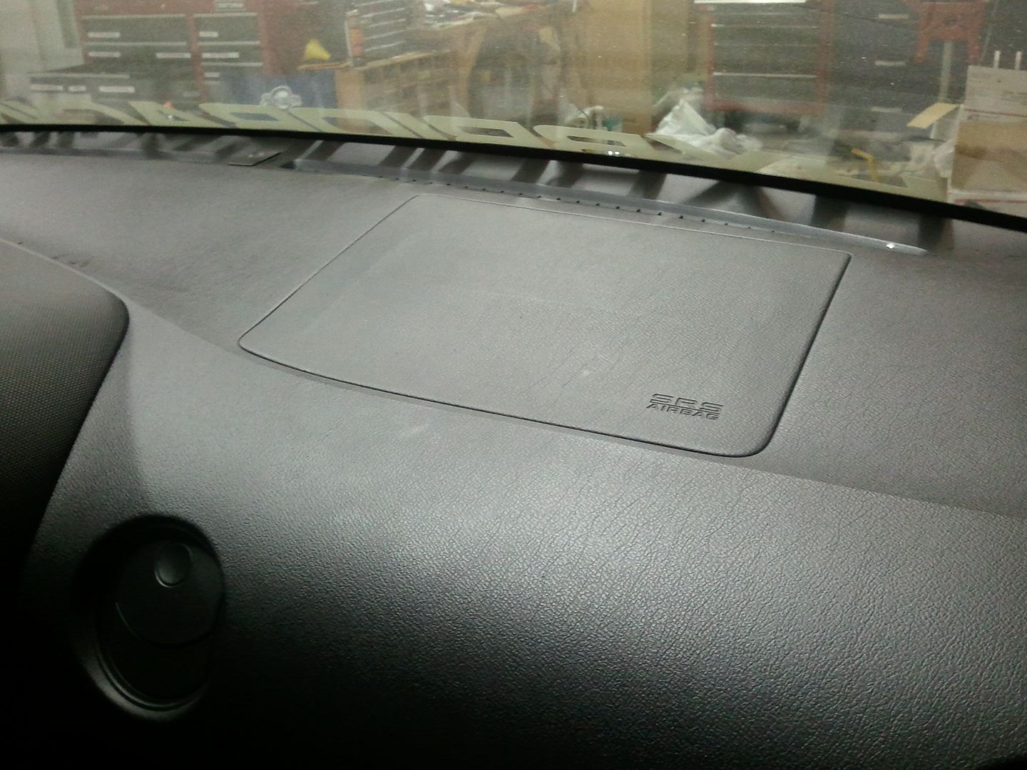

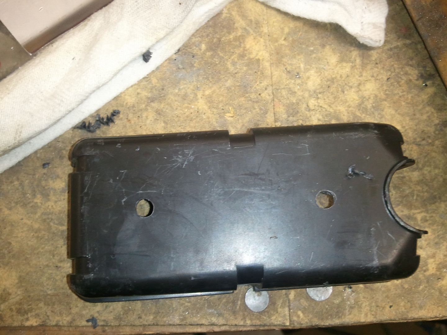

    Now for my fuse box............. first I gutted my air bag and trimmed down the cover

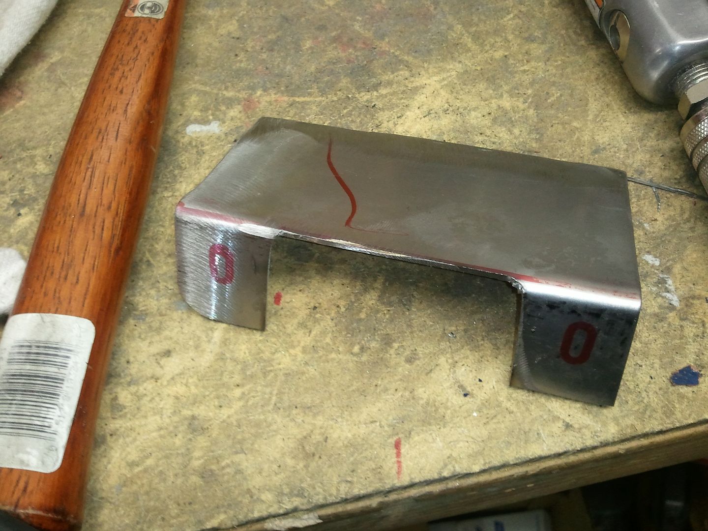

    Then as always customize a bracket for it to sit and mount
    bend and mock up.. was a pain

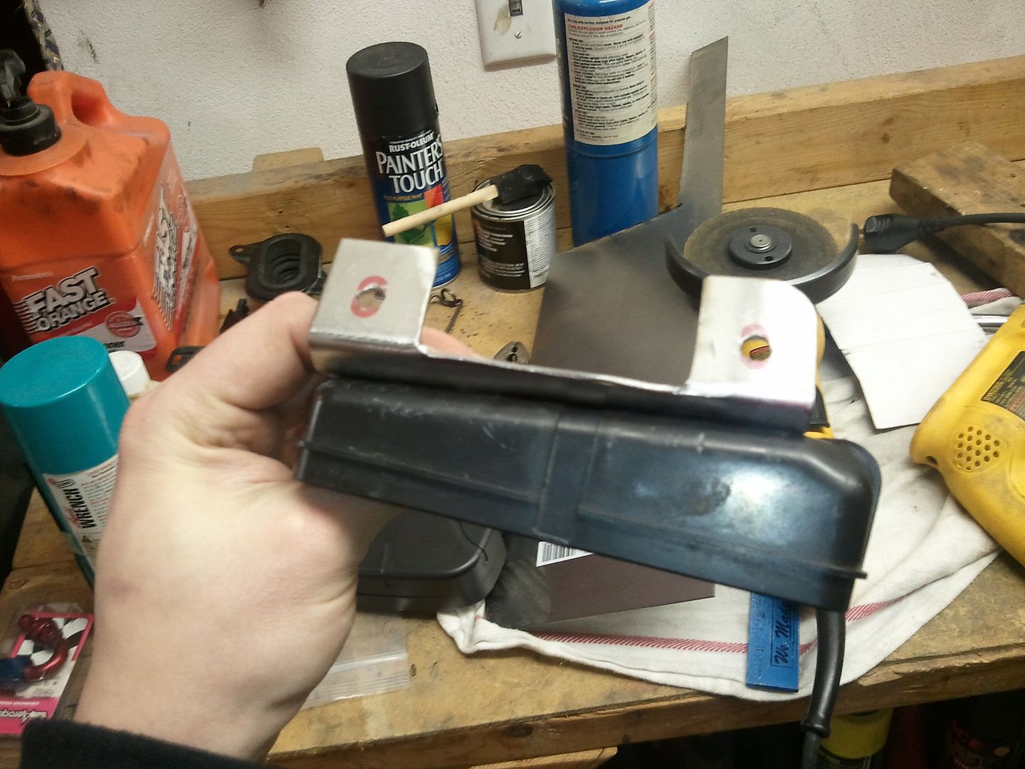

    welded in bolts for ease of mounting
    drilled holes in fuse box panel

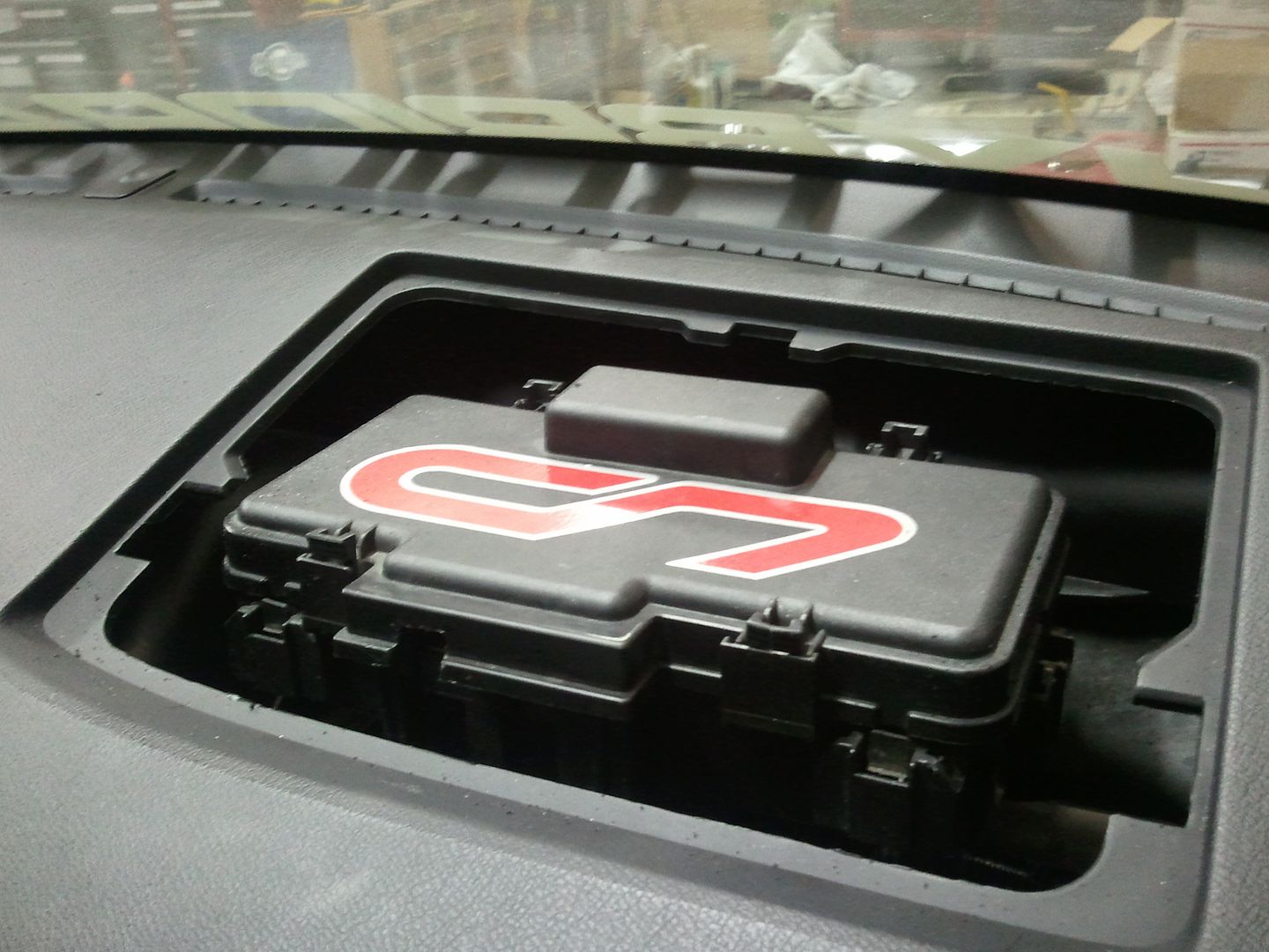

    Now installed and test fit it all
    BAM
