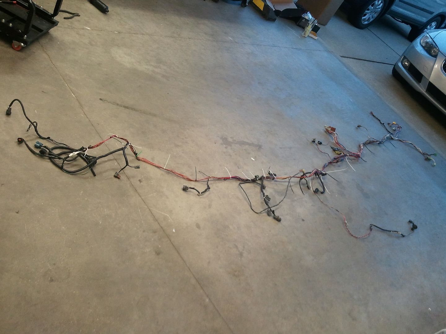

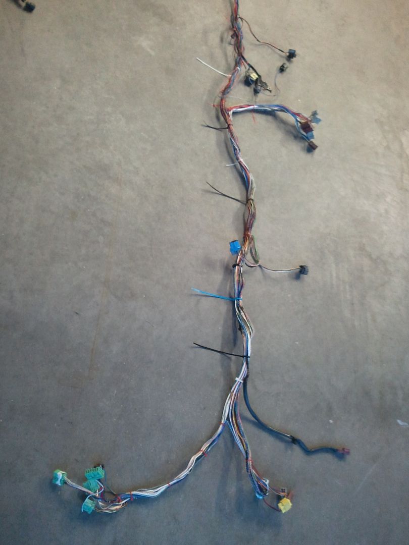

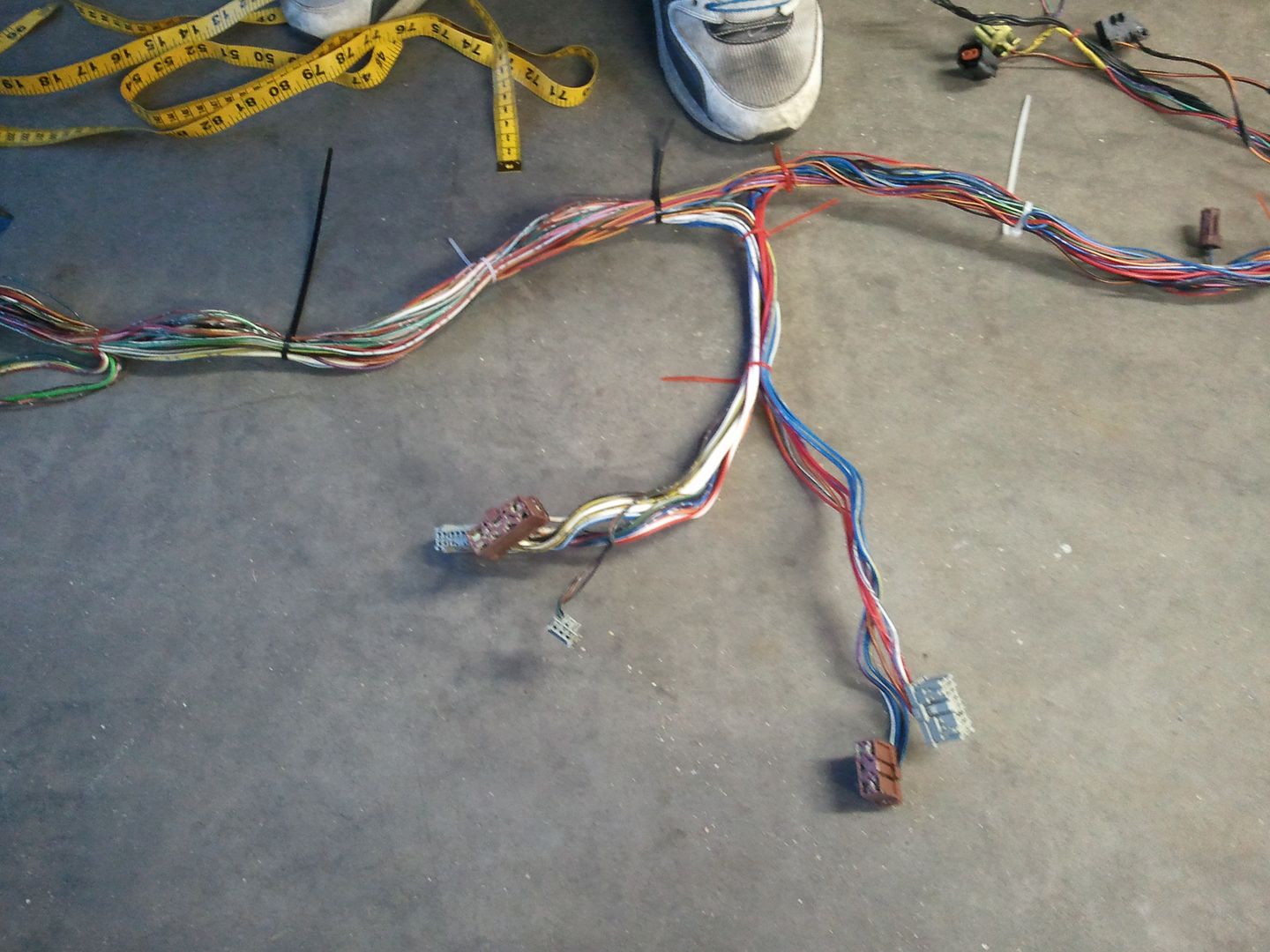

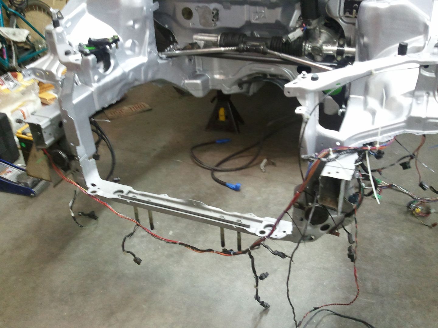

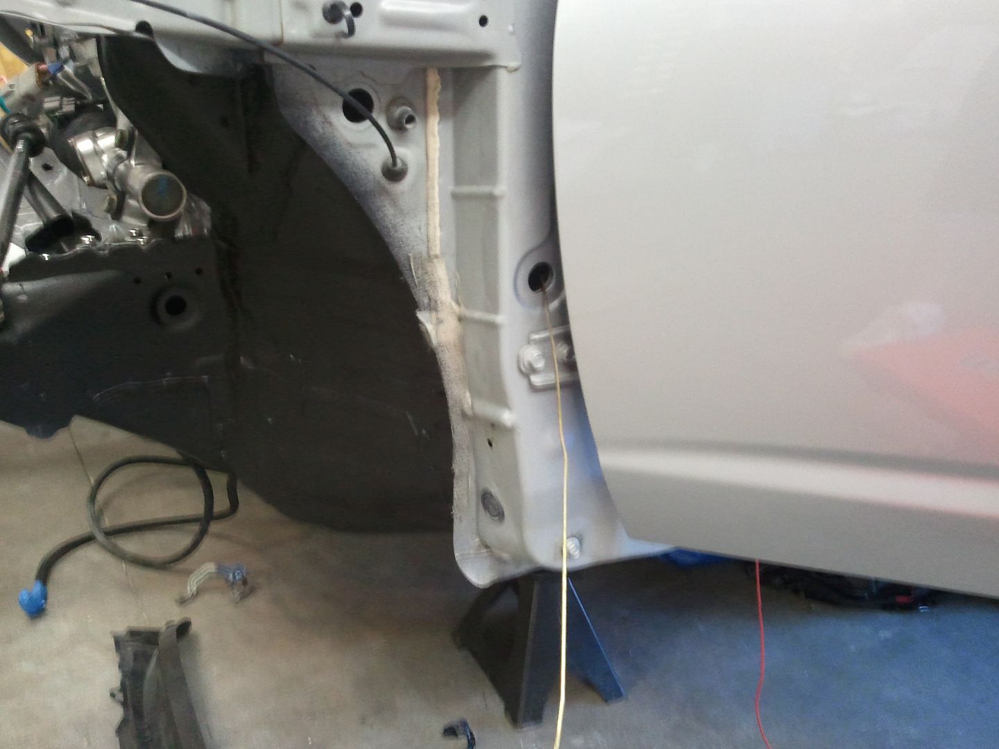

    So Chuck came over last night to take some measurements of the harness he is working on for me. He eliminated A LOT of wiring lol
    Here is how my harness currently sits
    and where the fuse box plugs are. They will be extended

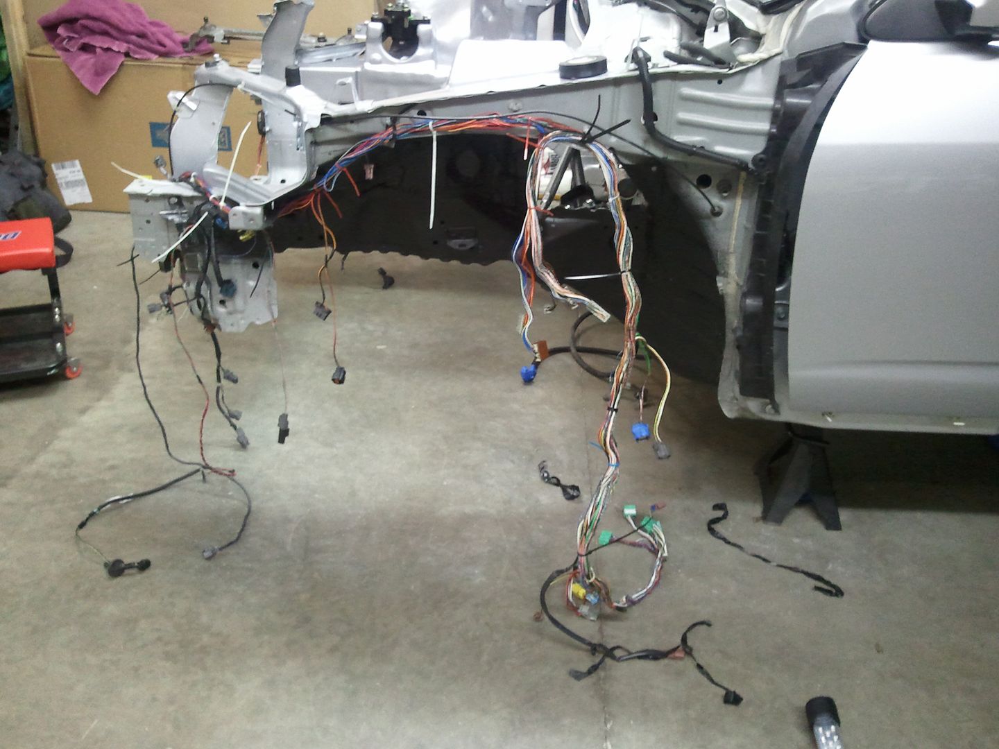

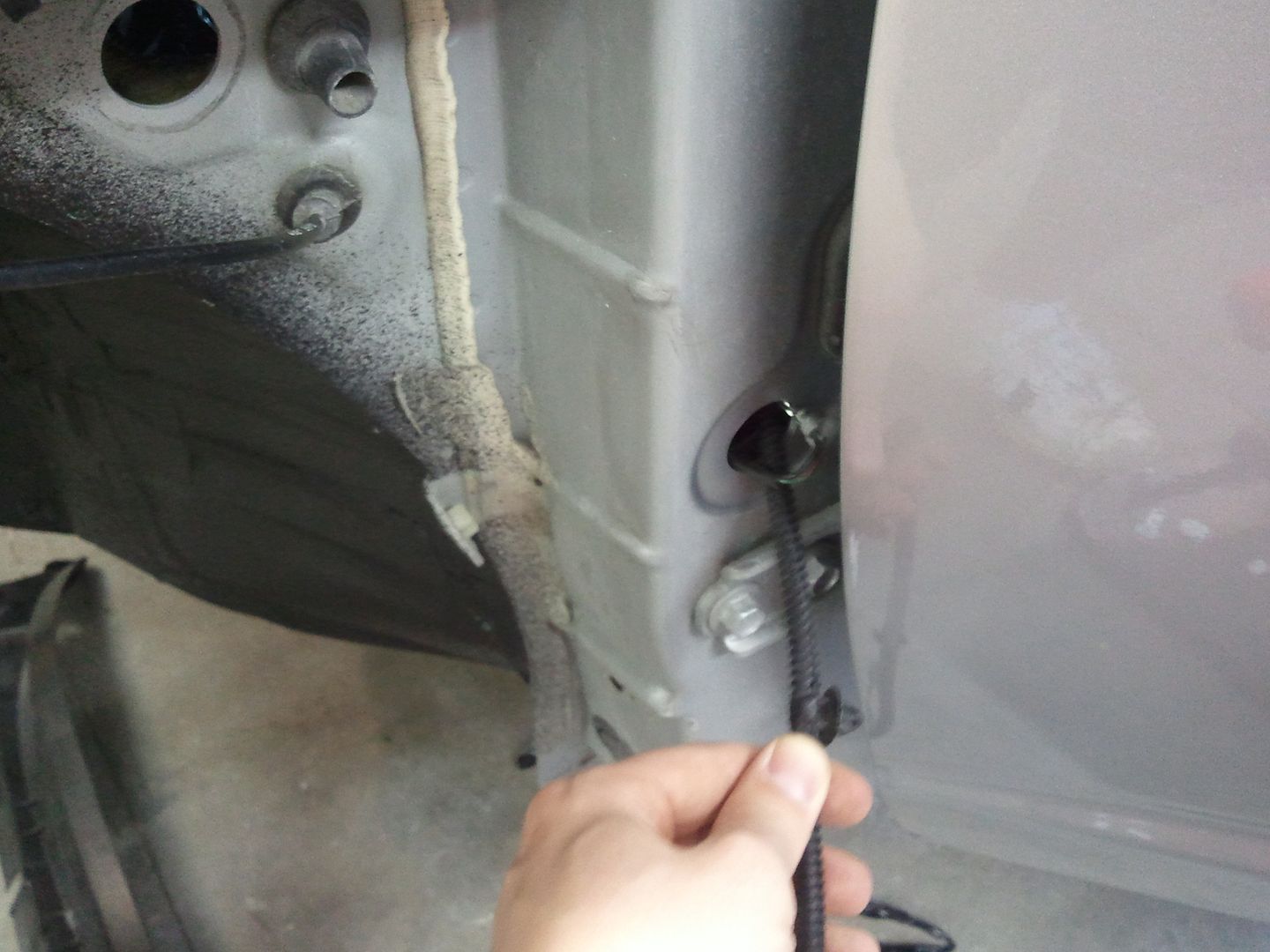

    We decided where we were going to put the harness but before we could do that we had to relocate the wiper arm harness. (Sorry no before photo)

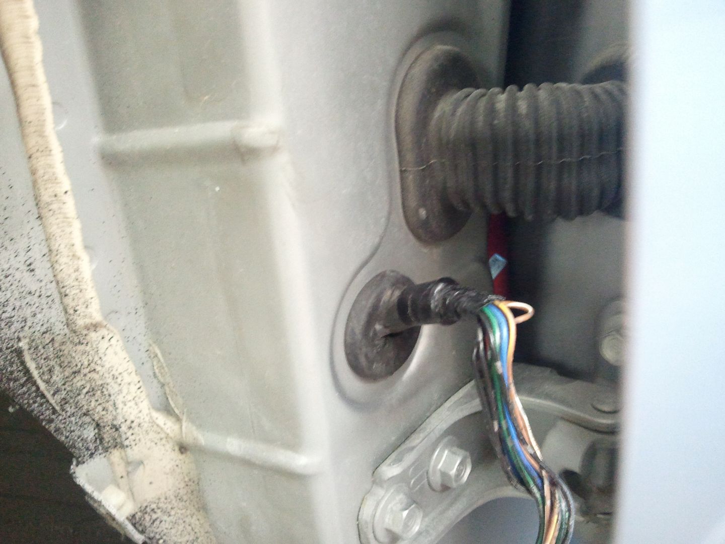

    He de-pin the plugs and removed the harness
    Pulled it back into the car and stuck a hanger into the new bottom hole we will be feeding it through from
    Now I started pulling it through

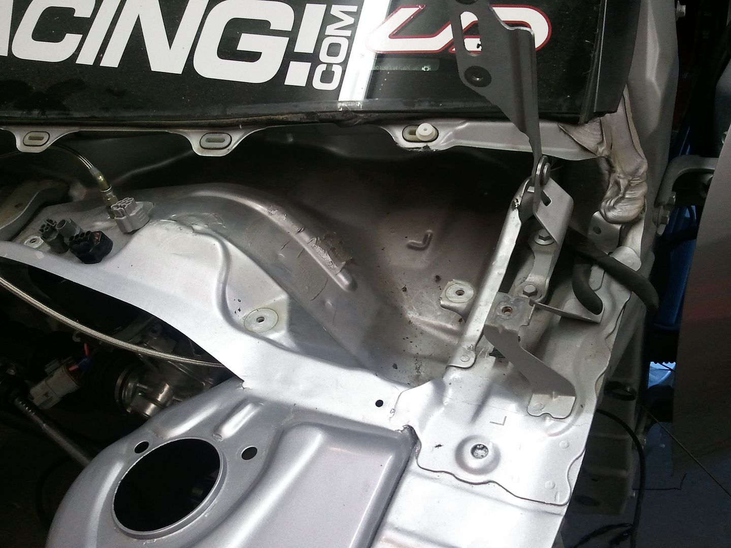

    and put the grommet back in place
    and finished relocating that. Very clean and simple.

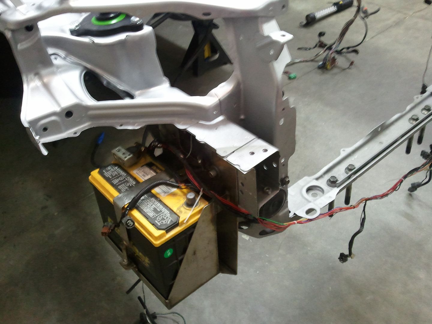

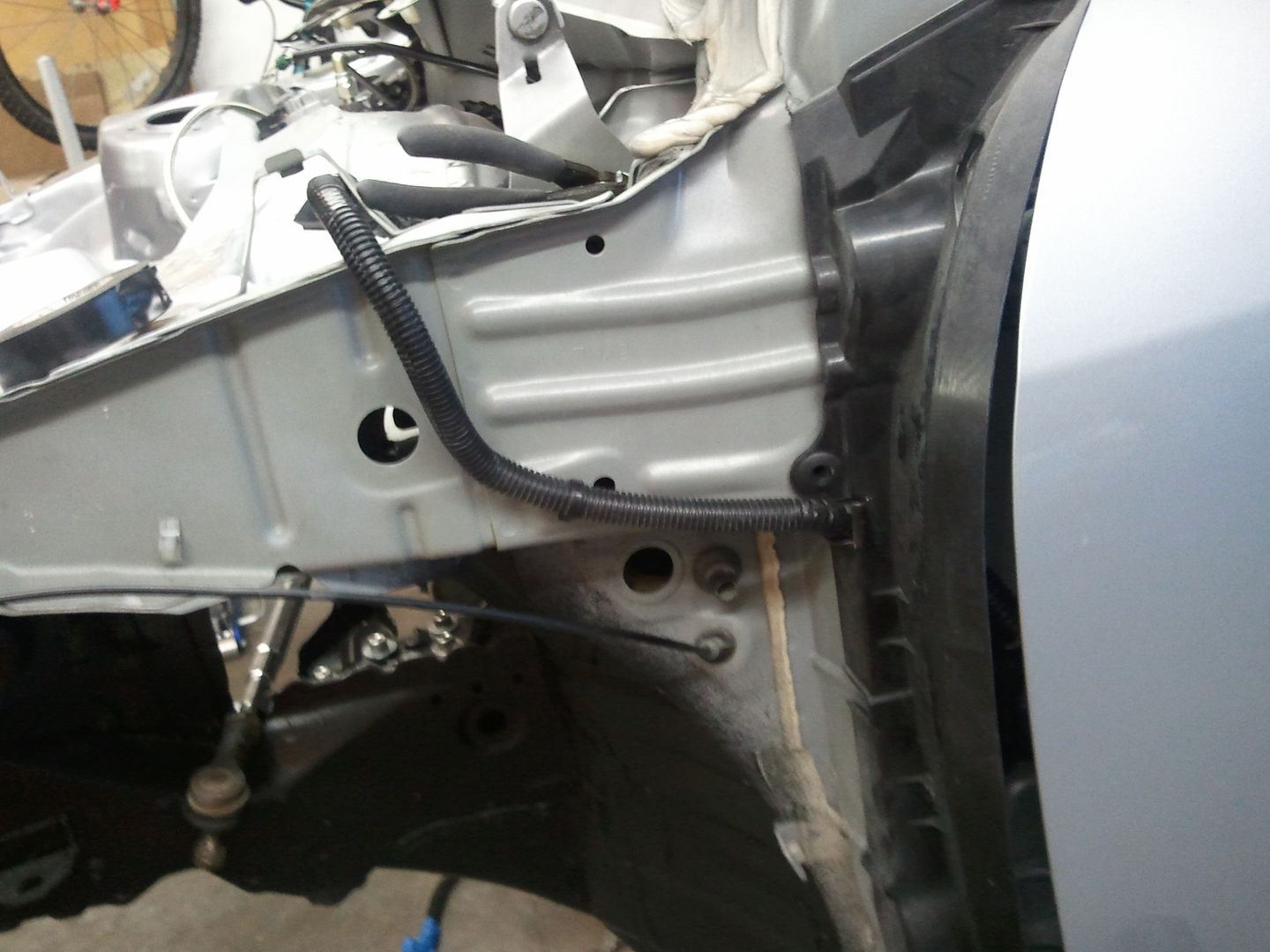

    Now to mock up the actual harness... Just zip tied it up. It will be coming out of the hole the wiper harness was coming out from
    drag it across the front
    and over to the battery

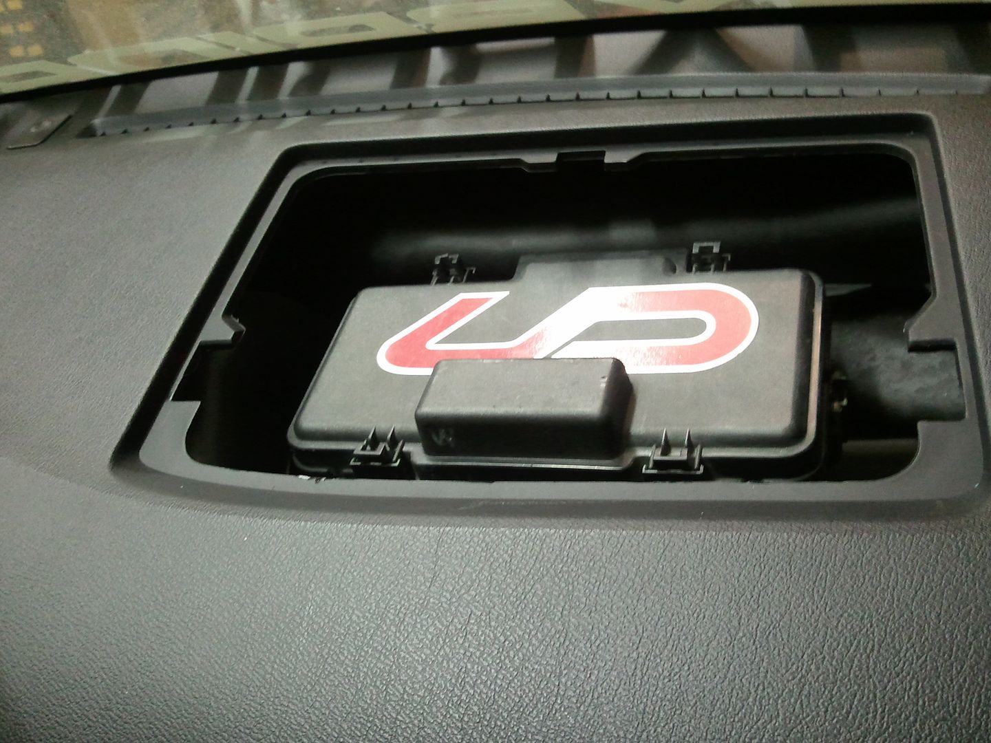

    Are you guys wondering where we are located the fuse box this time?
    Tonight I'm going to install my headlights so we can check all the wiring and see what needs to be extended etc.
