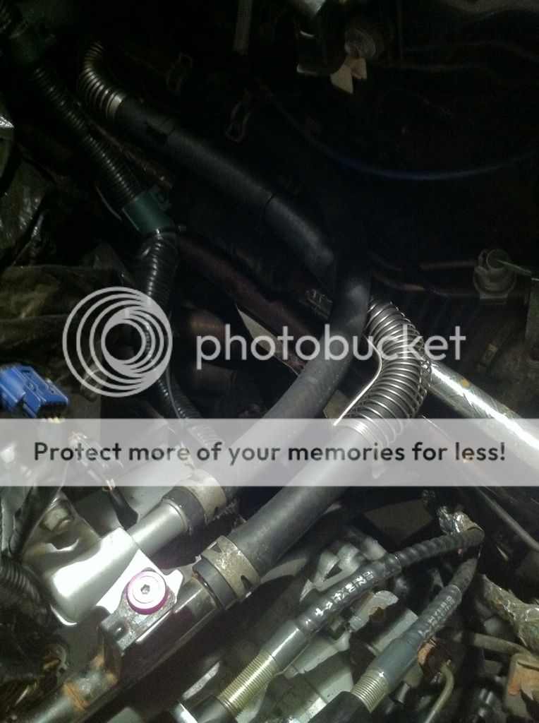

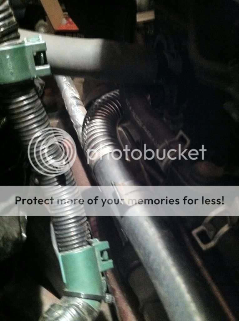

Today was heater hoses. Since the tsx motor has the ports just a tad farther away then the rsx motor I had to get regular hose and route it myself. No big deal. But I used a couple pieces to help make the bends possible with a straight non pre-formed hose.
Here's how they came out.
Trying to make those bends would be impossible without these things.

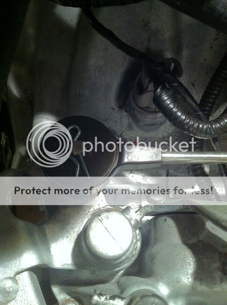

While I was at the store I bought hair clips for the shifter cables as well.
Looks pretty good to me. Much better then fussing with cotter pins and personally looks better.
