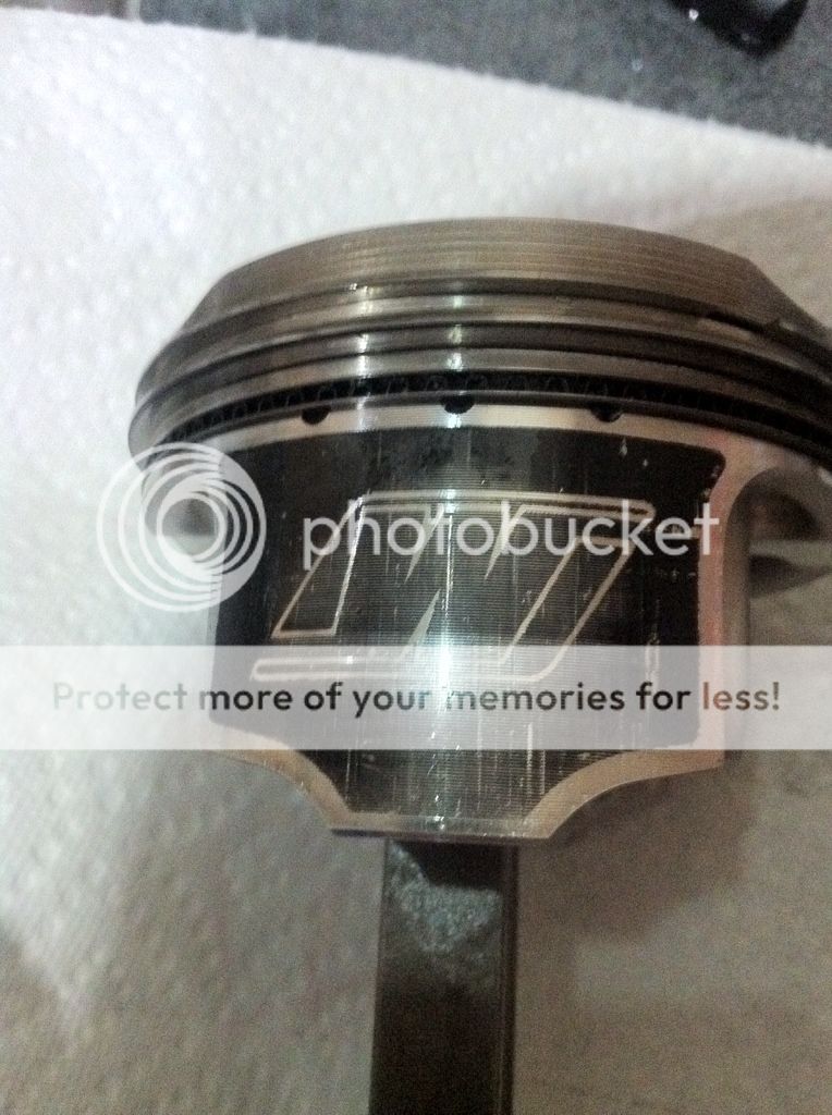

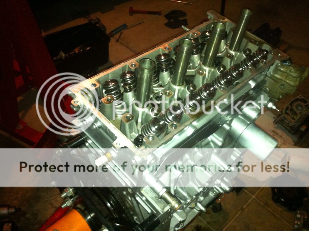

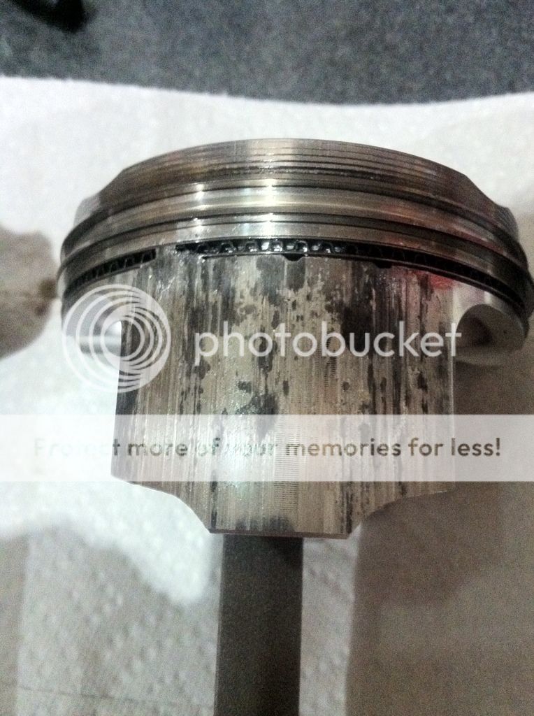

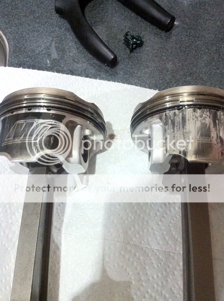

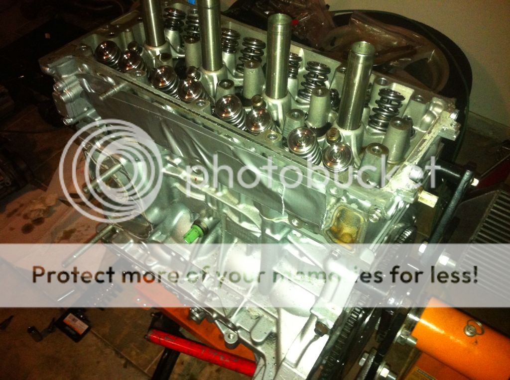

    Well guys I tore apart the motor and found piston #1 to be scarred up. Here's a few pics of #1 and #2 pistons

    That lies the issue. I'm not sure what happened. Some say it was lean, some say detonation, some say ring/piston failed.
    All in all I have no clue. But what I do know is I will need to go 88-89mm bore which will require new pistons ect.
