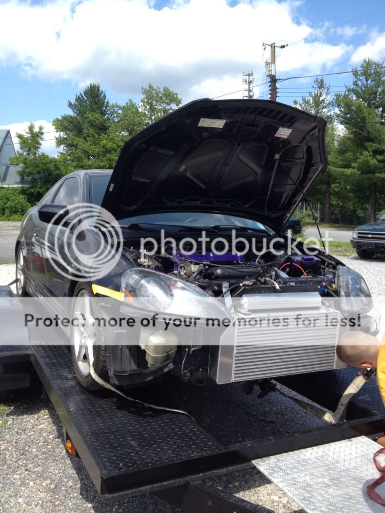

    Engine:
    Manley turbo tuff rods
    Weisco 11:1 pistons
    ACL race bearings throughout
    Supertech flat faced valves
    Dual valve springs
    Titanium retainers
    Kelford C cams
    New oil pump
    water pump
    Timing chain
    Tensioner
    24.5x12x3.5 vibrant core for fmic
    (custom end tanks done by John schill)
    Tial-Q 50mm bov
    Trans:
    Comp clutch twin disc
    Obx LSD
    (soon) straight cut 1-2nd gears.

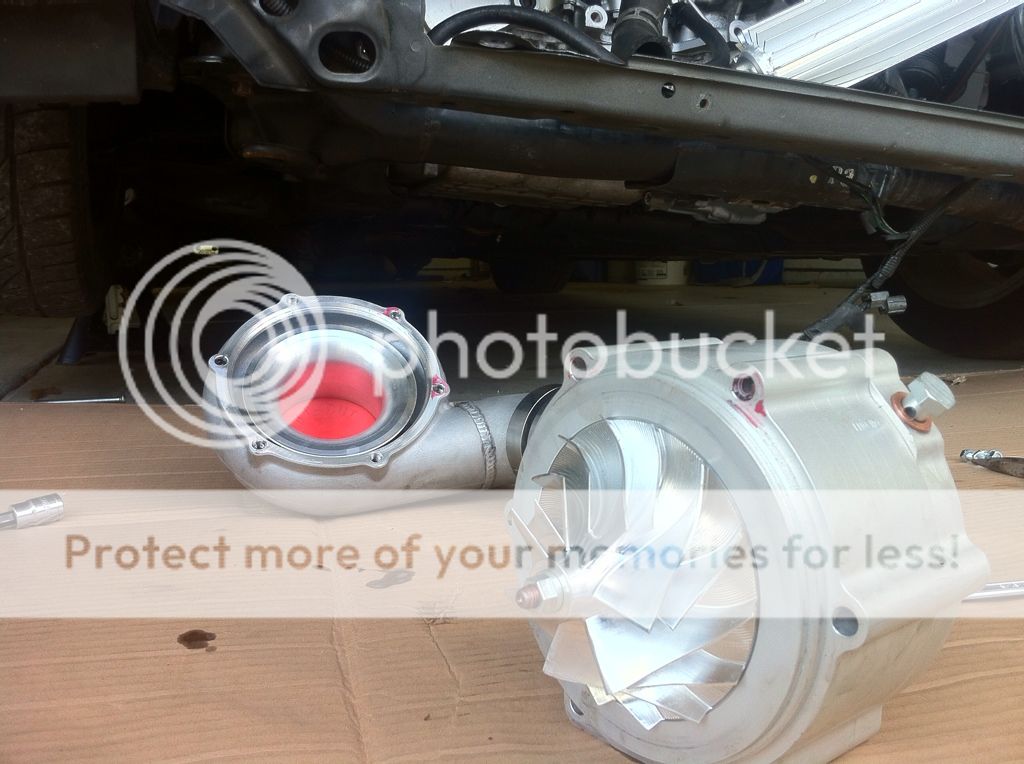

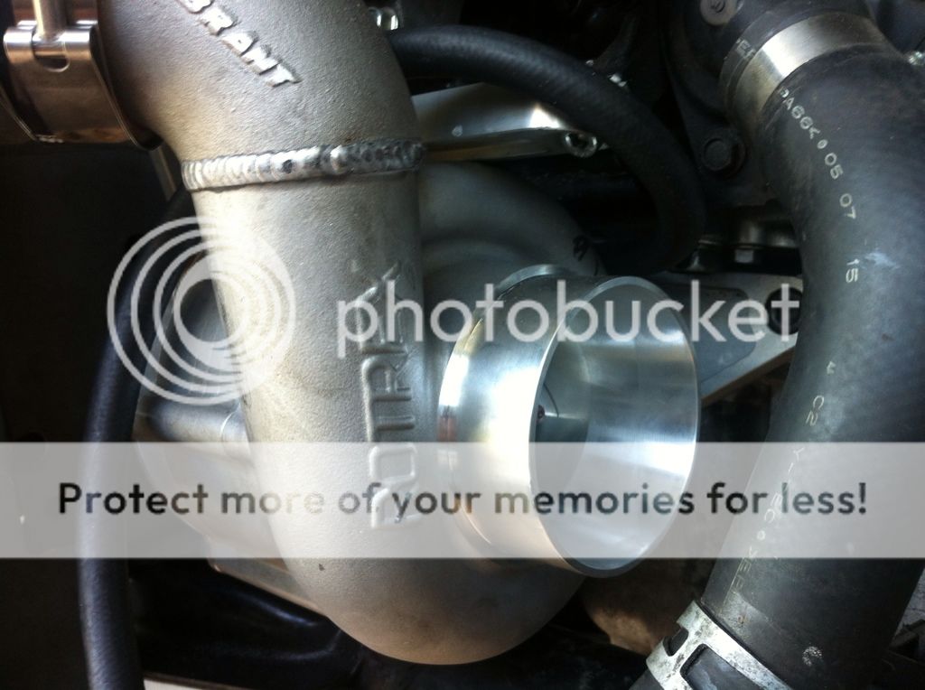

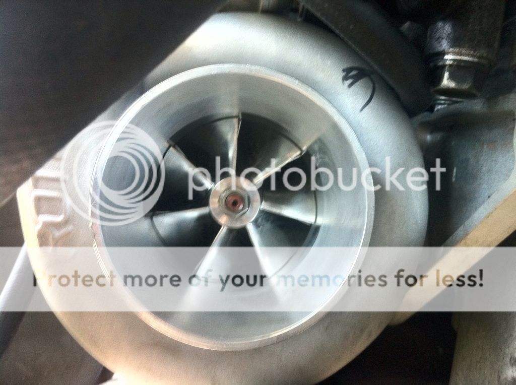

    All this attached to my c38 blower
    And TTS performance blower bracket
    Motor coming together
