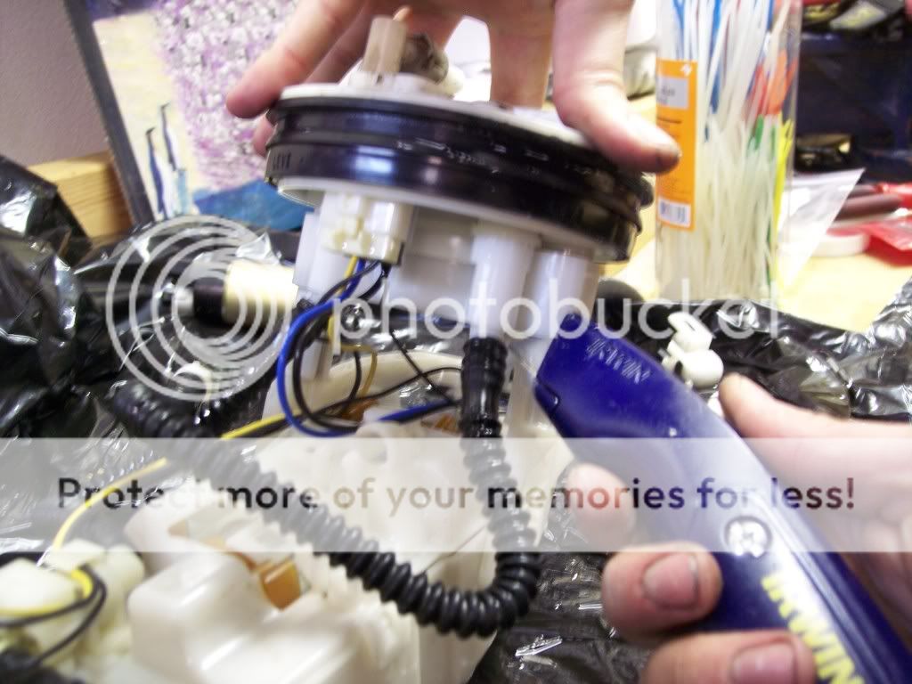

    Now time to modify the cage. We need to cut an opening to let the new fuel hose come out. So place the pump inside the cage and mark the area where the hose will extend out and cut. I used a dremel because it's quick clean and easy.
    Now clamp on the new fuel hose. I made mine at the pump he man tight.

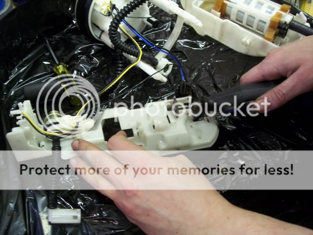

    Next we will have to modify the top of the housing cage. Because the pump is longer the housing will not shut. So place the pump in and mark off the area that needs to be cut. Then cut it out.
    Now we will cut the old hose off from the top as we will not be needing it.
    Put the cage back together and clamp down the new hose. Remember not to tighten this side of the hose down as tight because it is going on plastic!!
