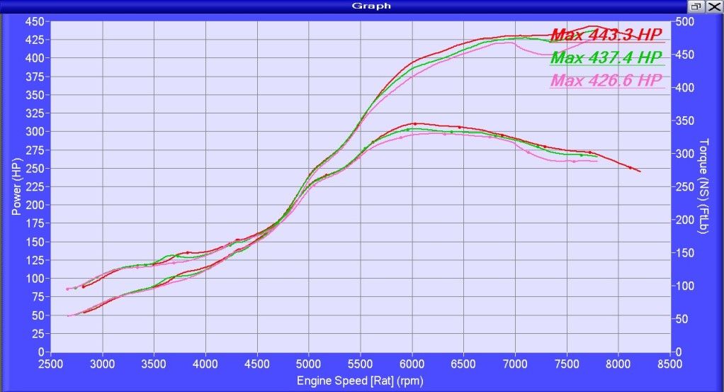

So like most I started out with a cold air intake, ran a catless exhaust, then ran a larger exhaust, then bought flashpro, then that was it time to get serious. Like most once you feel power from an upgrade you get addicted to experiment with different tunes different settings to get MOAR POWER.
I dynoed on a Dyno Dynamics and a base flashpro map with CAI, and exhaust but only made 177HP because it was untuned and way rich. Like 11.9:1 LOL that was FAIL! All you have to do is read :paper:
So I started learning how to adjust the fuel map with FlashPro and found a lot of other settings that help make more power HA! Imagine that!
After watching YouTube videos of boosted Civics and seeing those RPM's rev to fuel cut faster than I thought was possible... Yeah it was time to BOOST LOL
I started out with a smaller turbo build I pieced together consisting of a top mount log manifold and a small turbo like .63 AR turbine and .60 AR compressor. Modified my stock fuel injectors and started street tuning and ended up with 344HP on the same Dyno Dynamics.
When I couldn't get anymore power from those mods I decided to look at what I needed for more. My friends said "Dude you have a problem" I agreed with them... I don't have enough boost! :waveyfinger:
I did the whole build myself
(other than the machine work such as boring and honing the cylinders and fitting the oversized valves).
I welded my own intercooler brackets and welded my own 3" stainless exhaust. I tore down and reassembled the whole motor myself in my garage. I surprised myself when it actually started the first time HEHE
And it now has over 4000 miles on the motor
The only way I was able to do this myself was I had the service manual in PDF form for torque specs and reassurance I was putting things back where they go :)
I pulled the motor out in January 2012 and finished April 27th 2012
