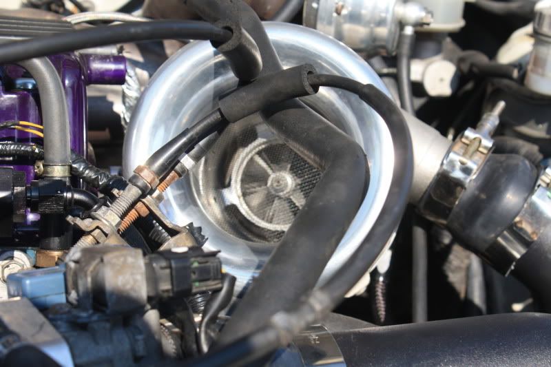

its a db fab manifold. Few others i have seen had one and it didnt creep this bad. i might venture into another gate, or an AFI manifold.
http://a8.sphotos.ak.fbcdn.net/hphot..._4243440_n.jpg
i even had the wastegate ported out larger.

Last year it would hold 17psi but that was with a 2 1/4 exaust creating a lot of back pressure.
Wait, it's creeping 20psi or creeping to 20psi? Because there's a big difference, lol. I can see why it would creep though.
The mani is probably the culprit. I will start a thread for the jdl design stuff threthread
well today it seemed to work better. the tuner worked the boost controller a little more, and we got to add some timing to it along with the meth. it stays in the 15psi range from 4900-7000, then creeps to 17 by 8000... then i was just scared lol
if all else fails, ill sell it and buy a new manifold, or buy another wastegate to have it welded on the bottom
I would save the money of buying another gate and go with a well known and r&d'd manifold like AFI or FULL-RACE. I've seen a lot of people try and modify the mani's with little success.
