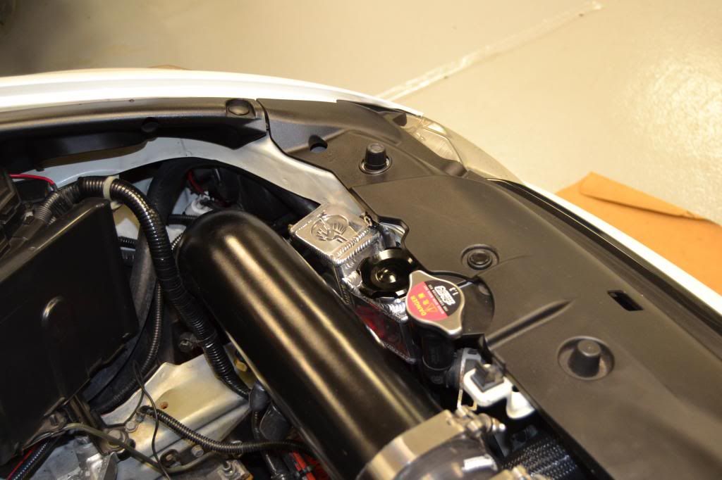

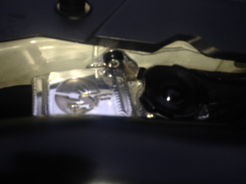

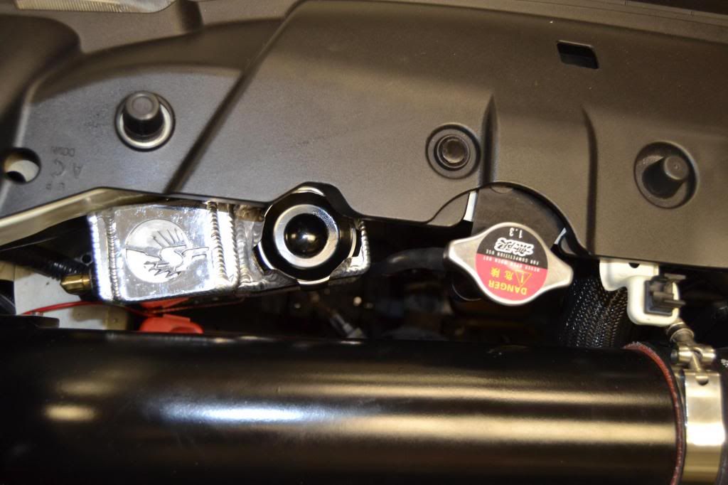

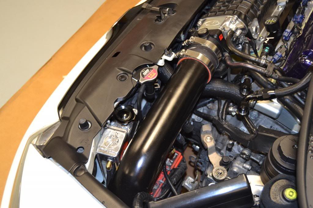

Speedfactory fabrication coolant over flow installed
http://i213.photobucket.com/albums/c...ps269280e9.jpg
http://i213.photobucket.com/albums/c...ps9e95861a.jpg
http://i213.photobucket.com/albums/c...ps43c49d7e.jpg
Looks awesome! How does it mount?

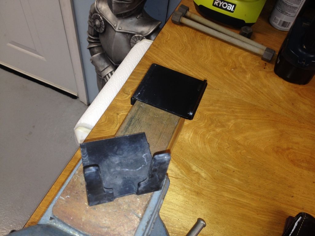

I modified the password jdm battery relocation mount that holds the battery down to remove the oem overflow mount and I just used one of the bolts for the upper radiator support. I replaced the oem bolt with a longer downstar bolt and washer http://i213.photobucket.com/albums/c...psff582521.jpg http://i213.photobucket.com/albums/c...ps39c64a64.jpg
