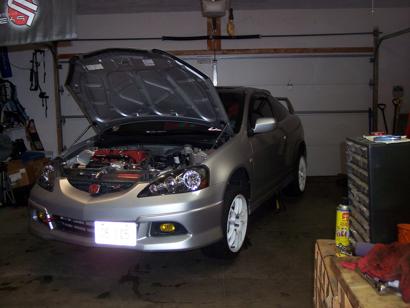

Did a quick suspension swap. So I thought I would make my version of the DIY....
First step break loose your lug nuts
next while the car was lower I decided to pull out the trunk parts so you can get to the rear strut bolts.
http://i918.photobucket.com/albums/a...b/100_7014.jpg

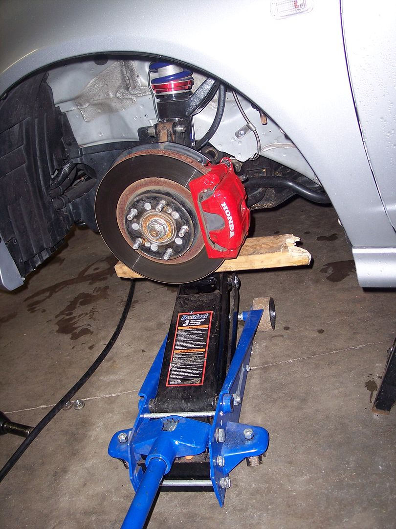

Now go ahead and jack her up and put her on stands
http://i918.photobucket.com/albums/a...b/100_7016.jpg

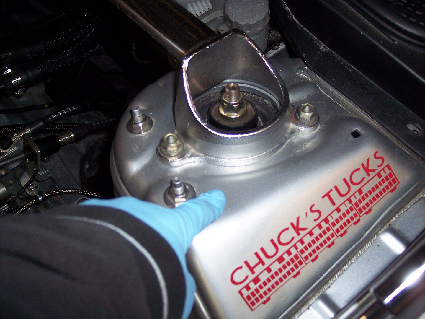

I started with the front. So first I loosened up the top bolts and removed the strut bar
http://i918.photobucket.com/albums/a...b/100_7010.jpg
then so the strut doesn't just fall out later put one of the nuts back on
http://i918.photobucket.com/albums/a...b/100_7024.jpg

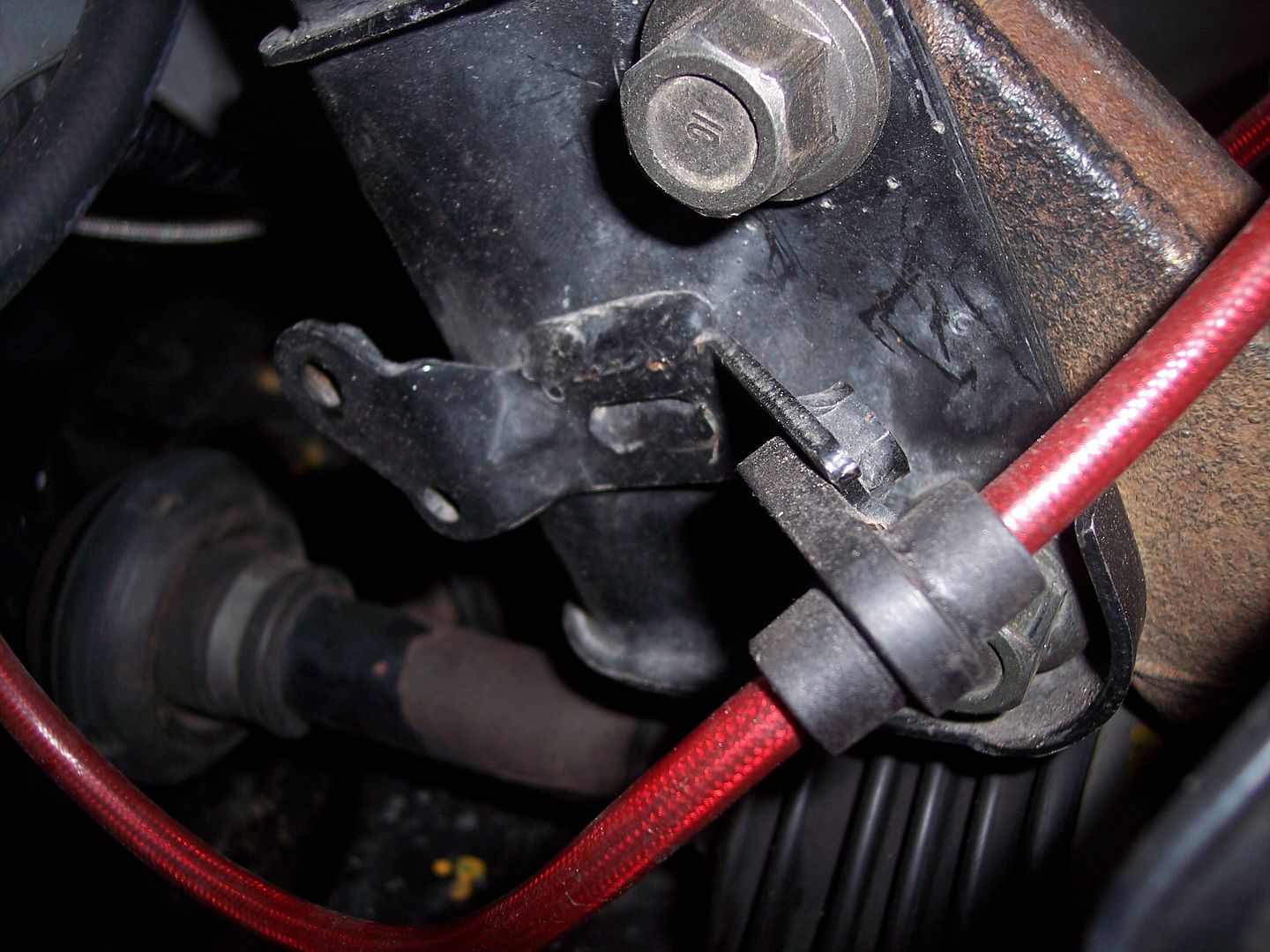

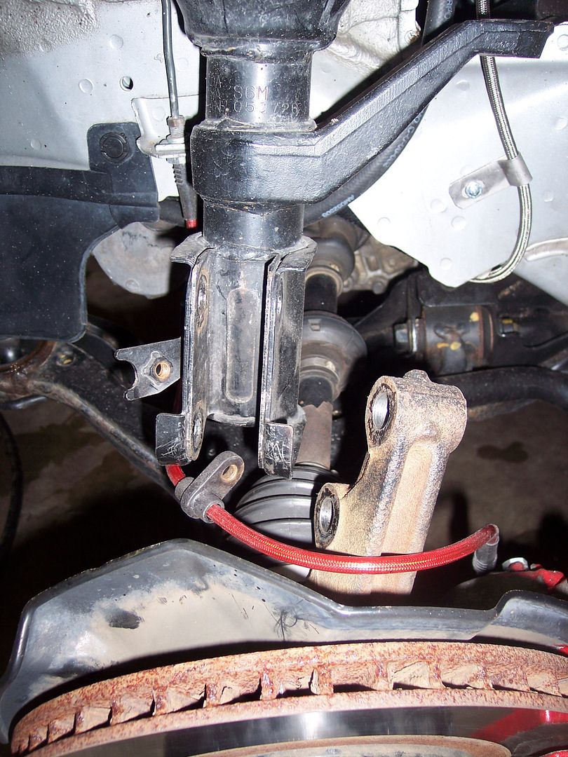

Now take off the tire and lets get to work. Remove the 10mm ABS bracket bolt(i don't have ABS so none shown) and the 12mm brake line bracket bolt.
http://i918.photobucket.com/albums/a...b/100_7019.jpg

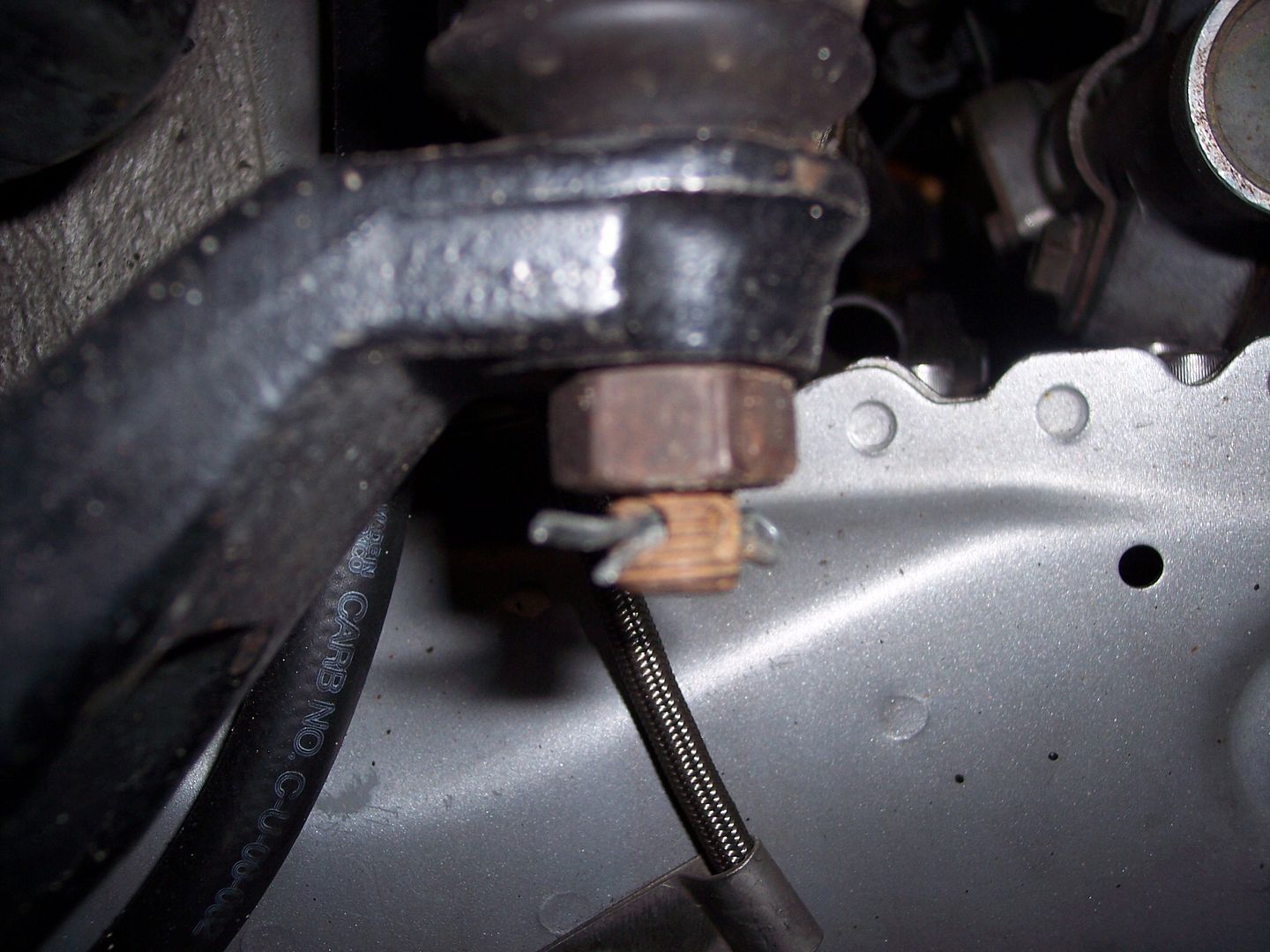

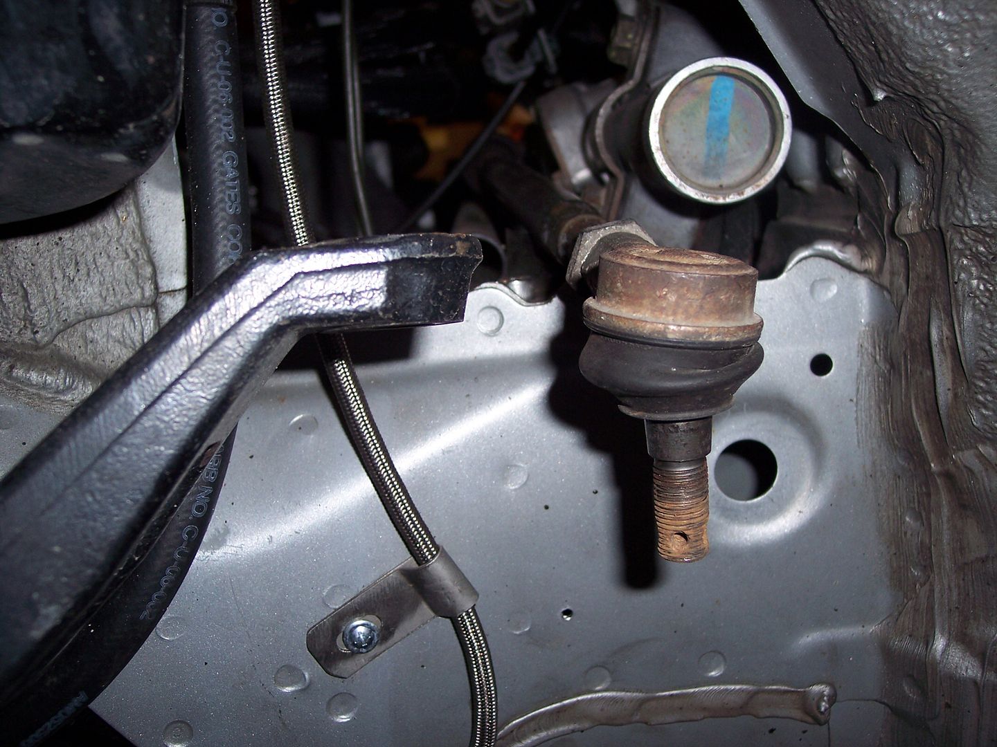

Now go ahead and take off the tie rod end. Remove the cotter pin then use a 19mm socket
http://i918.photobucket.com/albums/a...b/100_7021.jpg
pop her on out
http://i918.photobucket.com/albums/a...b/100_7022.jpg

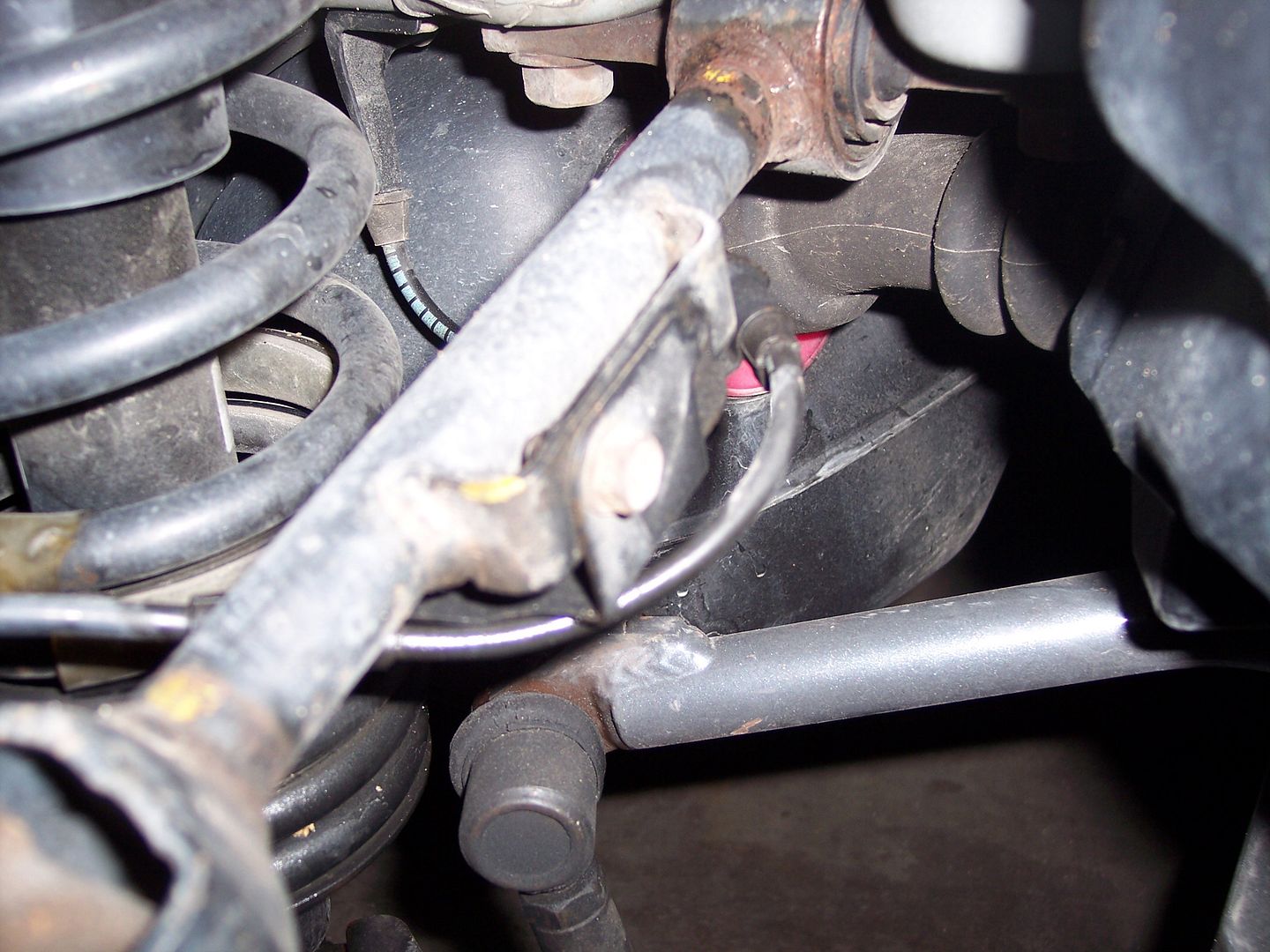

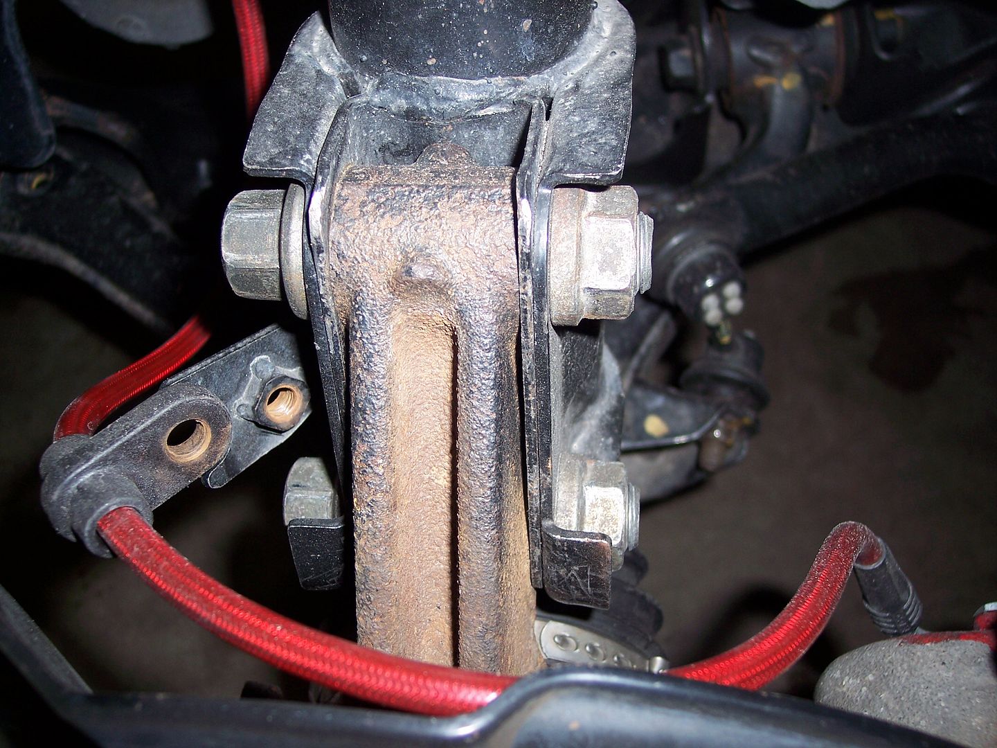

Now time to take off the big bolts. 19mm and 23mm
http://i918.photobucket.com/albums/a...b/100_7023.jpg
once those are out the hub will fall forward
http://i918.photobucket.com/albums/a...b/100_7025.jpg

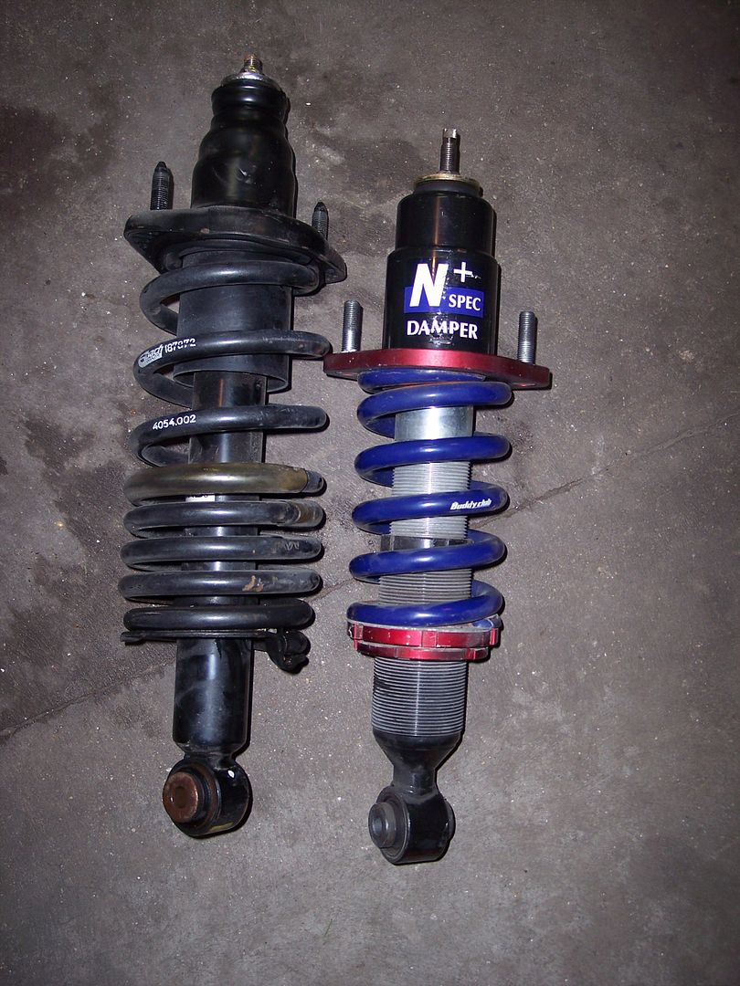

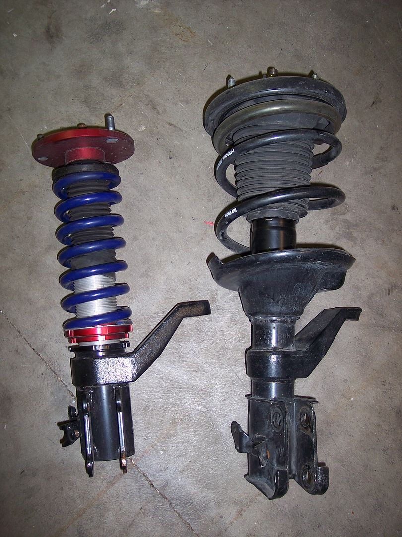

Go ahead and take off the one nut on top holding the strut in and pull her out. Now compare... stock struts with Eibach springs compared to Buddy Club N+
http://i918.photobucket.com/albums/a...b/100_7026.jpg

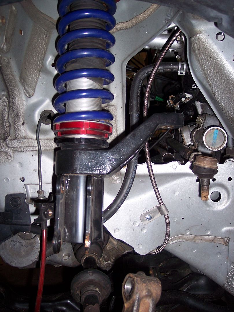

and instal in reverse order of course
http://i918.photobucket.com/albums/a...b/100_7027.jpg

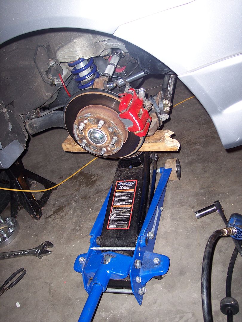

This will help you instal the front. Use a jack to push up on the control arm so you can get the bolts threw
http://i918.photobucket.com/albums/a...b/100_7028.jpg

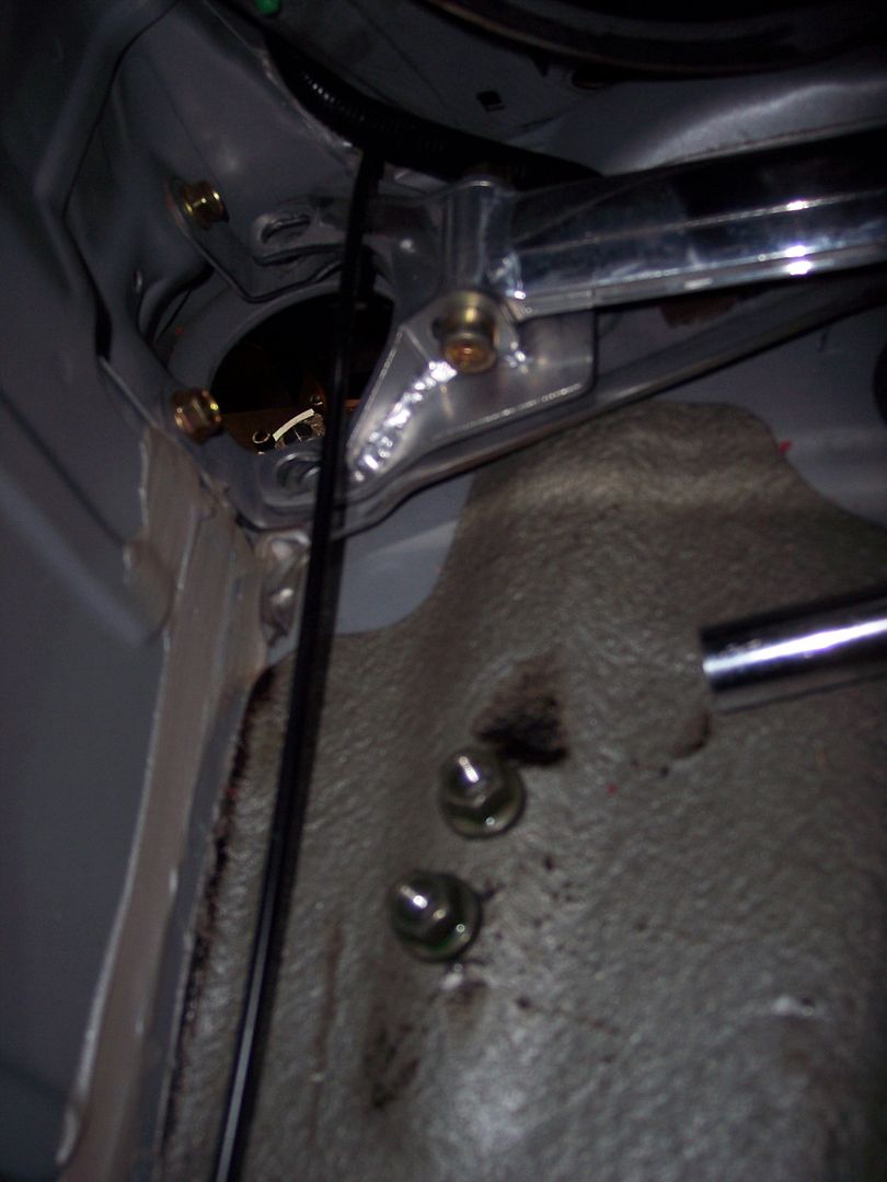

start buy loosening up the rear strut bolts on the top. I actually take off the back one since its a pain to get to. 14mm
http://i918.photobucket.com/albums/a...b/100_7037.jpg

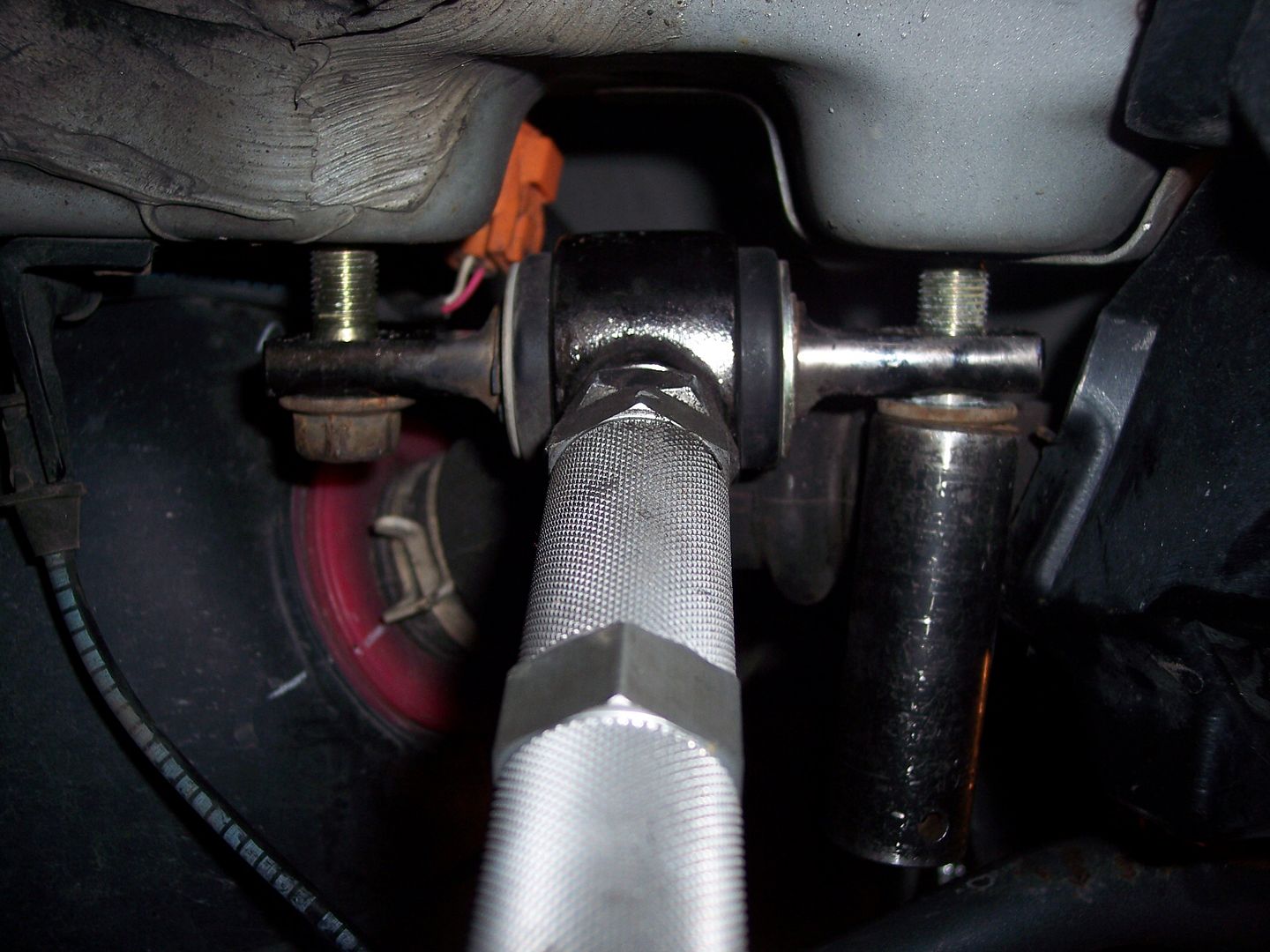

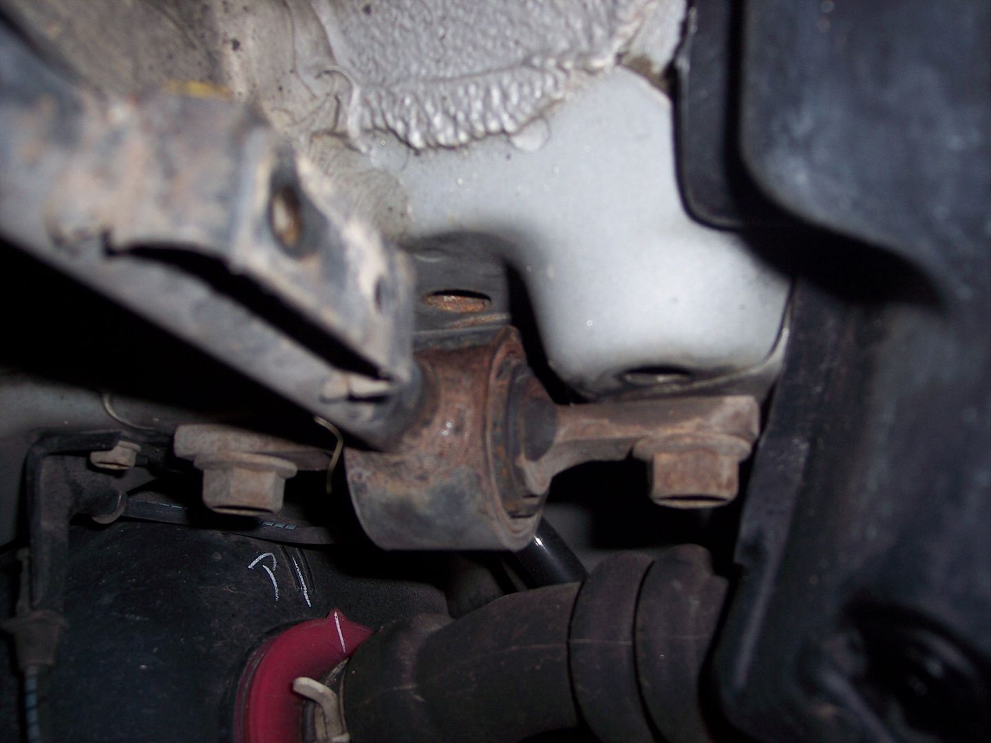

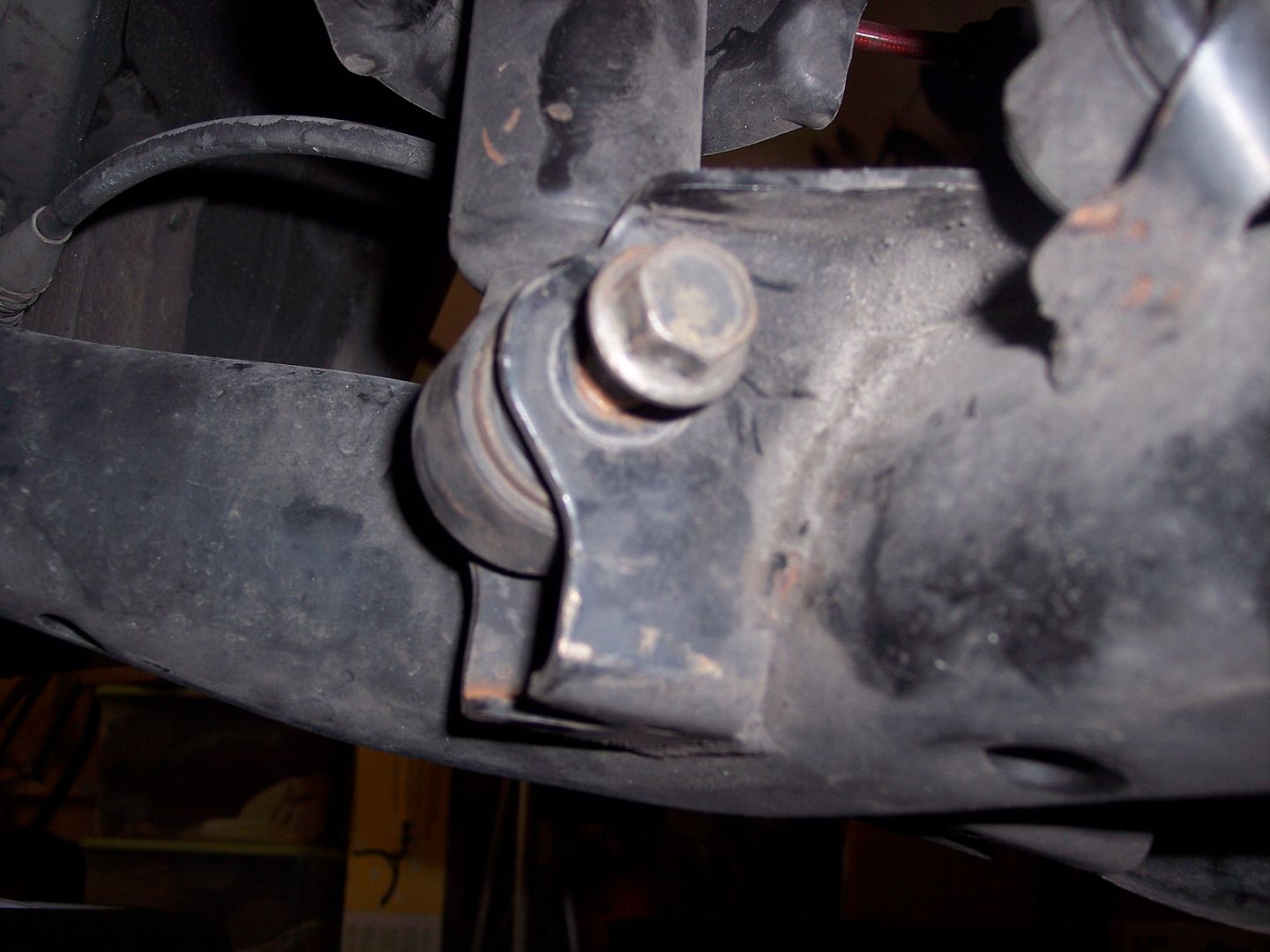

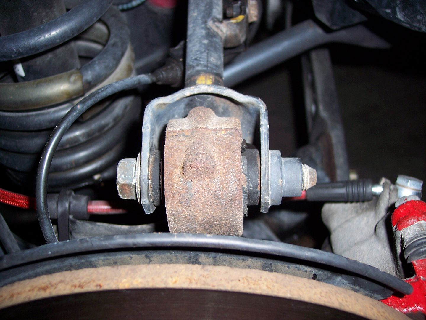

now we are also installing a camber kit. So pop off the 17mm on top arm
http://i918.photobucket.com/albums/a...b/100_7032.jpg
Then pull out strut because the control arm will lower
Remember to pull off the one nut left on top
http://i918.photobucket.com/albums/a...b/100_7034.jpg
http://i918.photobucket.com/albums/a...b/100_7033.jpg

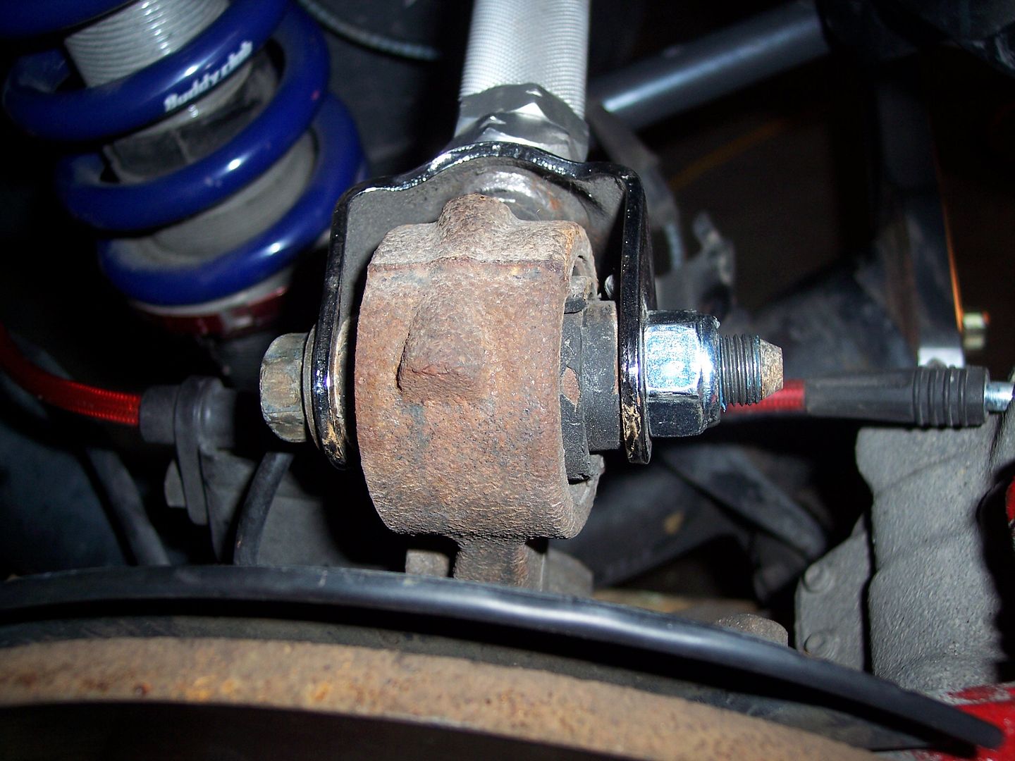

Now use a 17mm and remove the two top bolts for the camber arm and a 10mm to remove ABS line
http://i918.photobucket.com/albums/a...b/100_7031.jpg
http://i918.photobucket.com/albums/a...b/100_7038.jpg

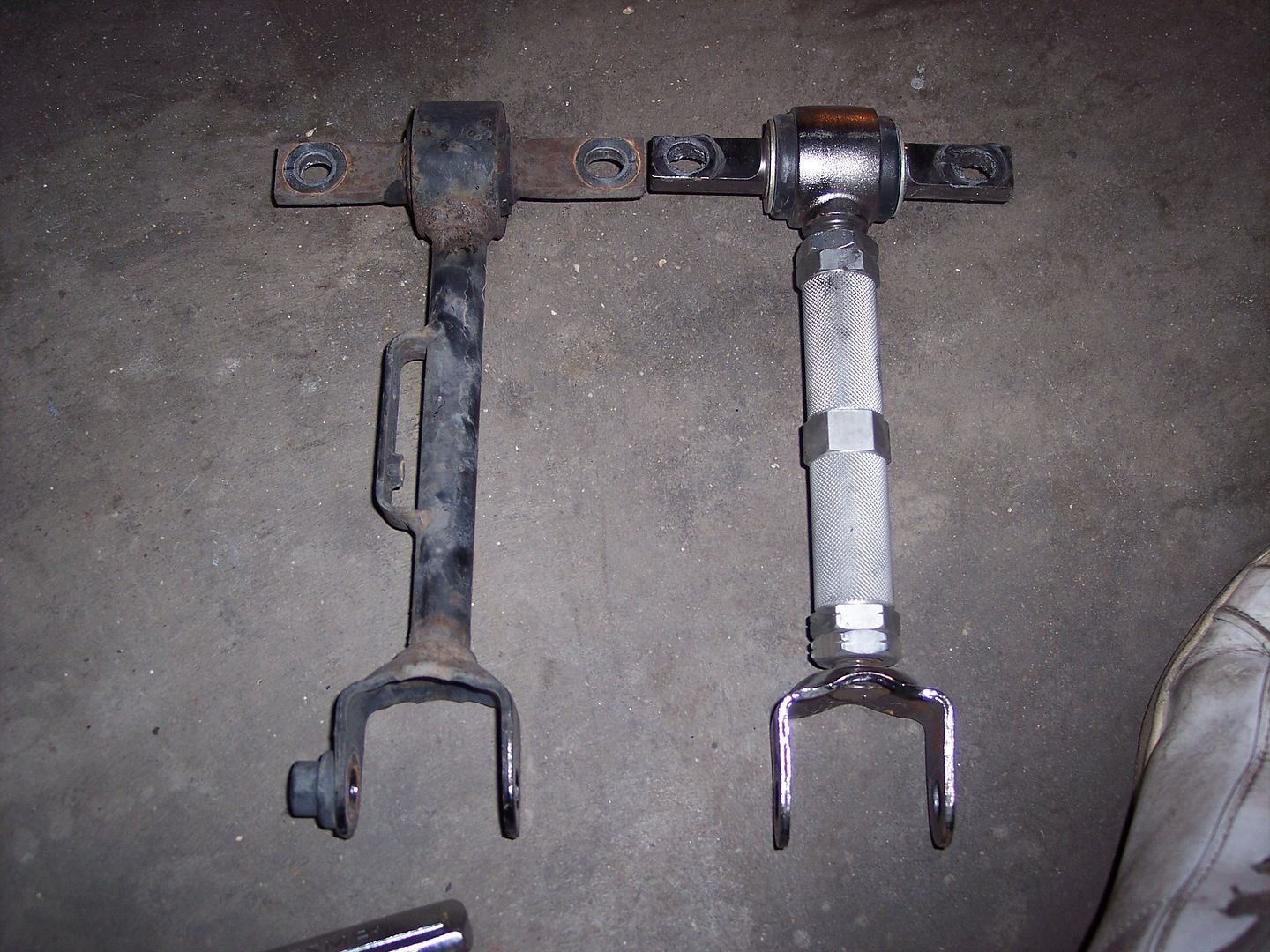

heres the camber kit
http://i918.photobucket.com/albums/a...b/100_7039.jpg
now instal both strut and camber kit
http://i918.photobucket.com/albums/a...b/100_7040.jpg
http://i918.photobucket.com/albums/a...b/100_7044.jpg
and just like front use a jack to lift control arm to help instal
http://i918.photobucket.com/albums/a...b/100_7043.jpg
