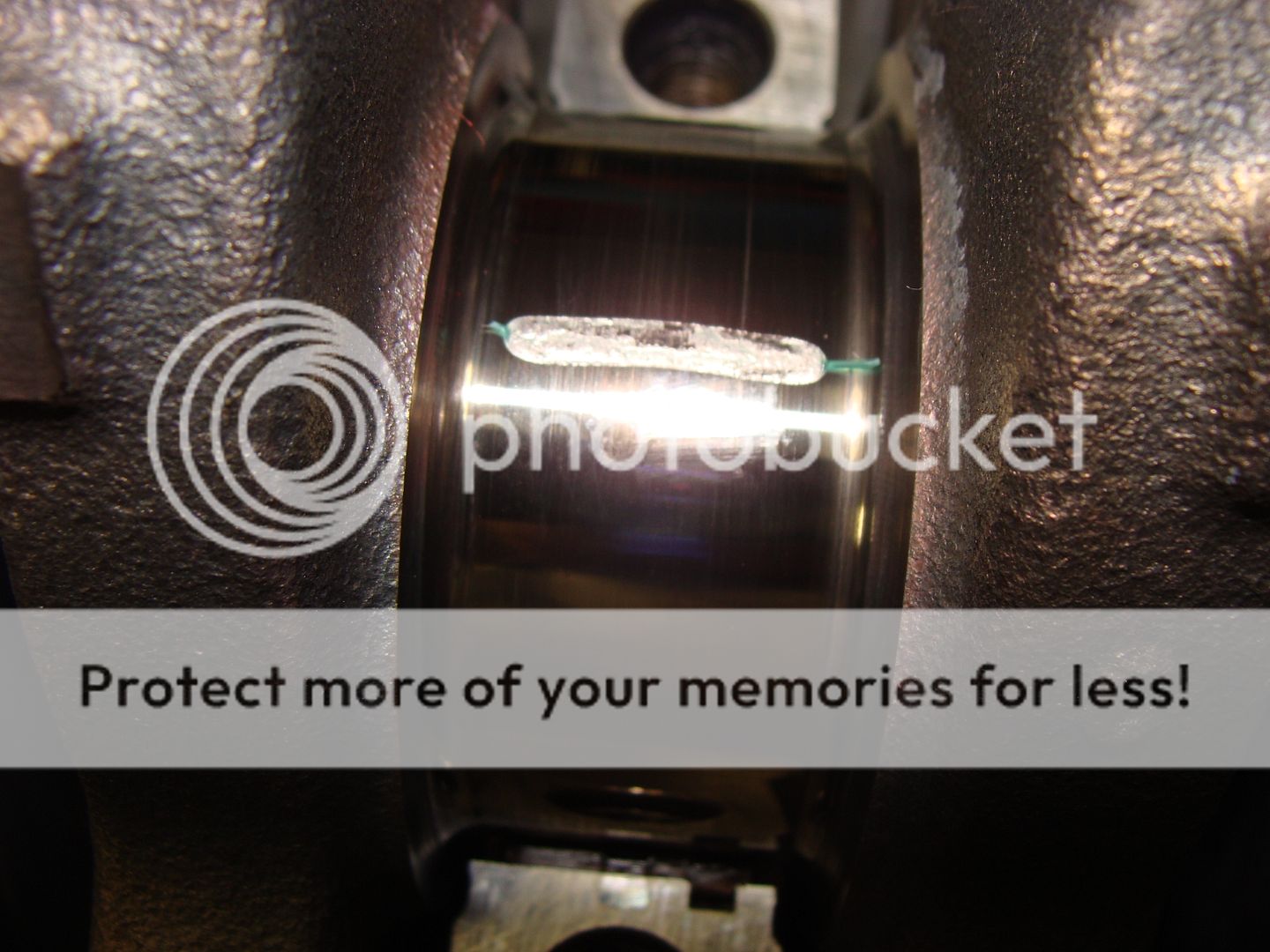

Thanks for the tool input! How does this plasticgauge thing work? It get's crushed? Do some of the dots go away or something?

The plastigauge works by installing the parts to be checked while having a small piece of the plastigauge between the parts to be checked you torque it to spec then pull it back apart and measure the thickness of the plastigauge with the scale thats right on the outside of the package the plastigauge comes in I have a pic I 'll find and post
http://i540.photobucket.com/albums/g...ps01ce2c3c.jpg
