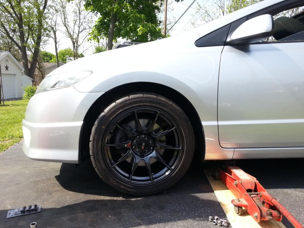

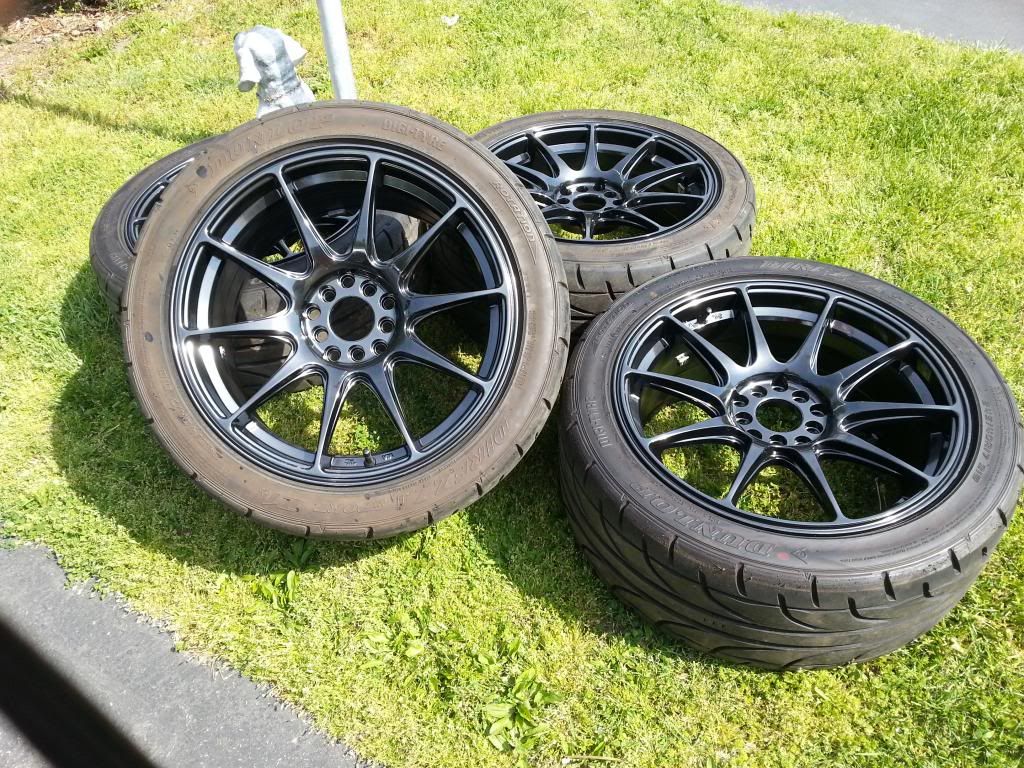

Got an appointment for Thursday at 330 to get my car inspected and the tires mounted to the XXR's finally :waiting:
XXR 527's 17*8.25 +35 In black chromium with 245/40/17 Donlop star specs
http://i901.photobucket.com/albums/a...127_114412.jpg
Nice, love the mean deals. Its so weird how xxr uses .25" and .75 for their wheels btw, never understood that.
Me either honestly but they look okay so o well

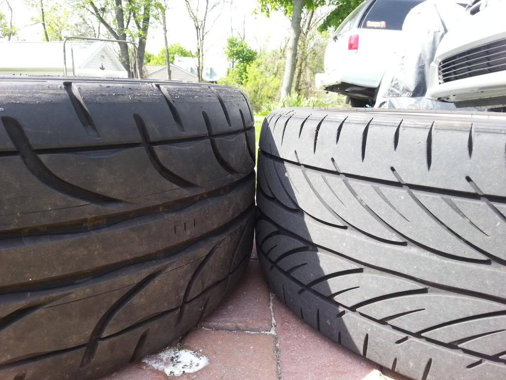

The lug nuts i got NG-r's don't quite work for me, i need spline or narrower lugs to fit. So these also won't be going on for a bit longer.
Yeah they look good which makes me happy, the post before that however makes me one sad banana
Sadbanana. Sorry to hear about the gear situation, at least you'll be upgrading with the ep3 trans. And the wheels and tires look dope! Lots of meat, love tuose direzzas. I just don't want to take my perfectly fine N3000's off and buy those. Hmm, we'll see. If you can, please document/record your tranny swap for the rest of us/future users. When will you be doing the swap?
:yeathat: what size tire are they. I'm almost to the point where I'll be needing new fronts. And I've been eyeing these for some time.
s4 petefromthestreets
He has 245/40/17 star spec z1's on 8.25'' wide rims. I fit 235/40/17 star spec z1's on my stock rim (7'' wide) just fine.

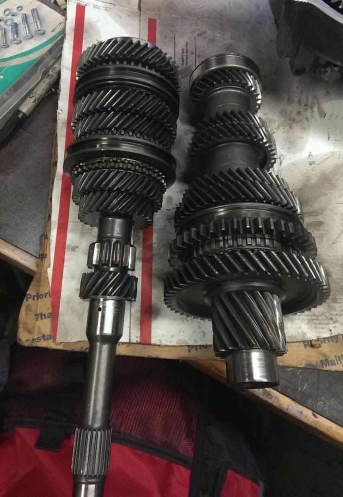

Got a little done today:

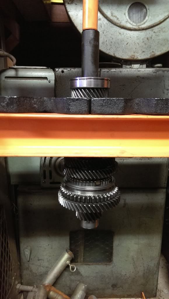

Pressed 6th gear off the stock trans
http://i901.photobucket.com/albums/a...g?t=1368063411
Better view...kinda
http://i901.photobucket.com/albums/a...g?t=1368063416

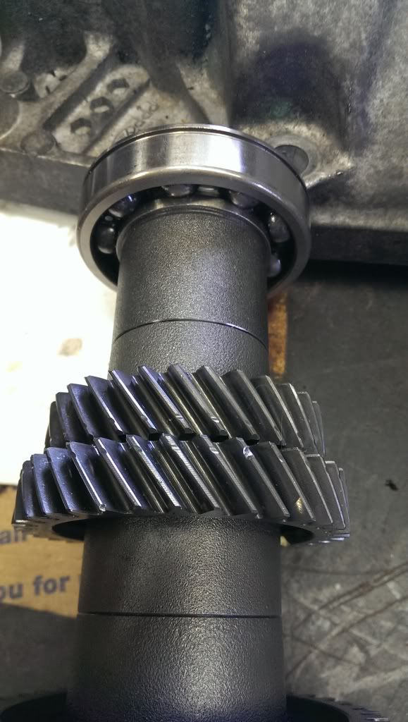

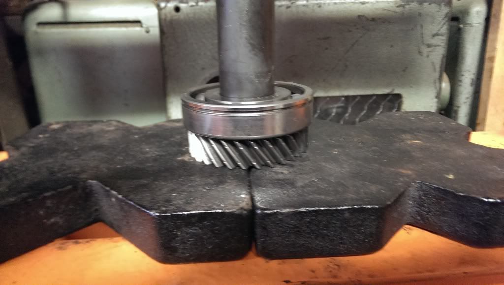

4th gear on the ep3 trans had a small nick so i replaced that gear
http://i901.photobucket.com/albums/a...g?t=1368063427
Done and done...gear set fully assembled
http://i901.photobucket.com/albums/a...g?t=1368063432
You are correct that you must use the same ratio gear on both the main/ countershaft. I am using the ep3 4th on both. When this gear set was shipped to me the counter shaft 4th had the nic in the picture. The seller was nice enough to send me a replacement gear. Thats what i put on to replace the damaged one.
I agree, but better packaging the first time around would have prevented it. I was a bit angry about it, but at least he did the right thing and replaced the part that was damaged.

Thanks for taking and posting pics, I really wanna get a "fact sheet" sticky going that has all the notes you need for a swap. For example, that the mainshaft gear and countershaft gear have to be the same ratio (can't use ep3 and Si unless the ratio is the same, for example)
If you can drop the trans you can easily rebuild it, it really is fantastically easy when you actually dive in. Things really can't go on in the wrong order and if they do, they won't line up and the issue will be obvious.
If you get an ep3 trans you can literally drop it right in, i made it complicated because originally i put the Ep3 gears on a 4.3 final drive. I decided that was a bit TOOOOOOOOOOO long for me. So i am now using the 4.7 FD that added a bit more work to my swap. If you get the gears and FD you want it will slide right in.
Some good tips though
4.3 FD needs this bearing HON-91003-PPT-004
4.7 FD needs this bearing HON-91003-PPP-004
You need to space out the speed sensor with 2-3 washers when using the rsx or EP3 gears in a z3 case.

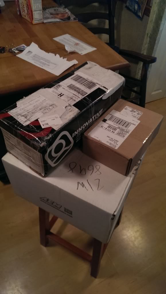

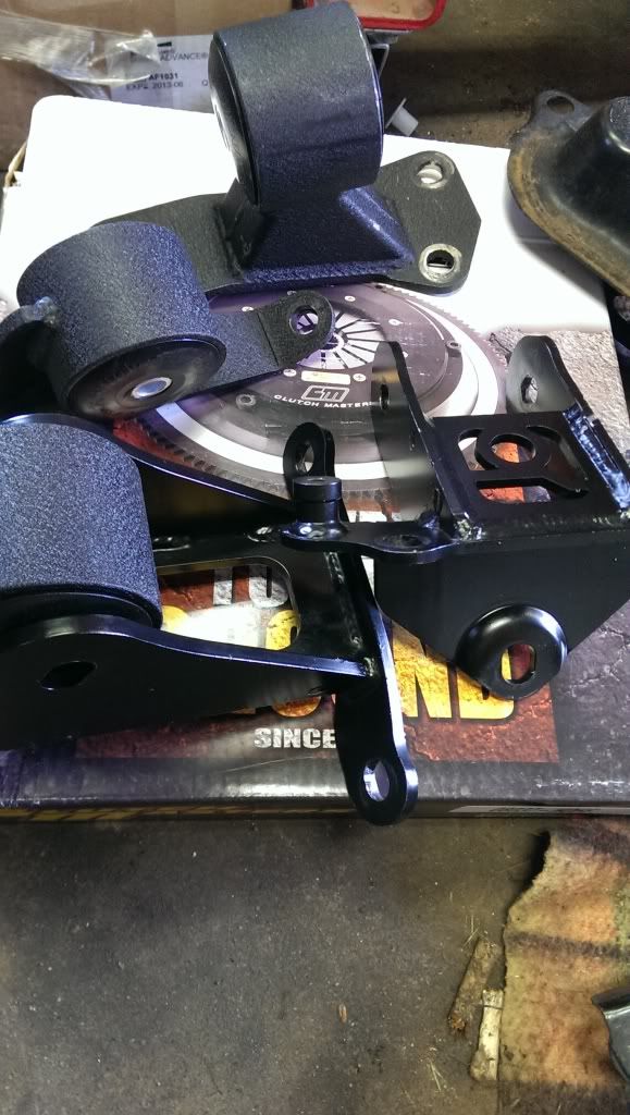

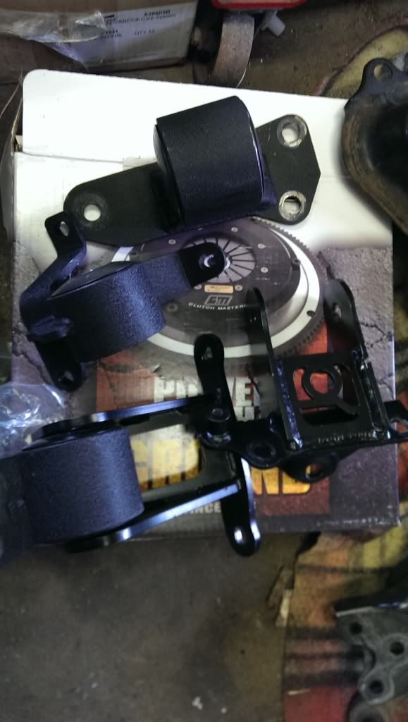

Whelp, a bit of an update...got some stuff in the mail
http://i901.photobucket.com/albums/a...psee0f37ac.jpg
Got full hasport mounts 75a
Thanks Asdf!
http://i901.photobucket.com/albums/a...ps145740f5.jpg
http://i901.photobucket.com/albums/a...ps71400e5f.jpg
I am also going to try out the fx350..:pray:
http://i901.photobucket.com/albums/a...pscc25b680.jpg

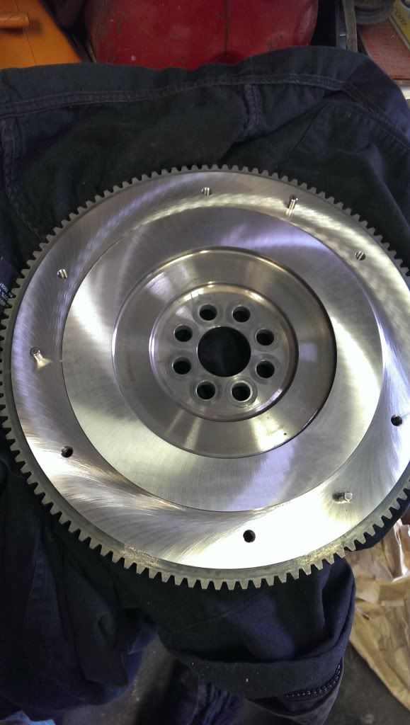

Resurfaced flywheel...step cut +.047
http://i901.photobucket.com/albums/a...psbbabc9d6.jpg

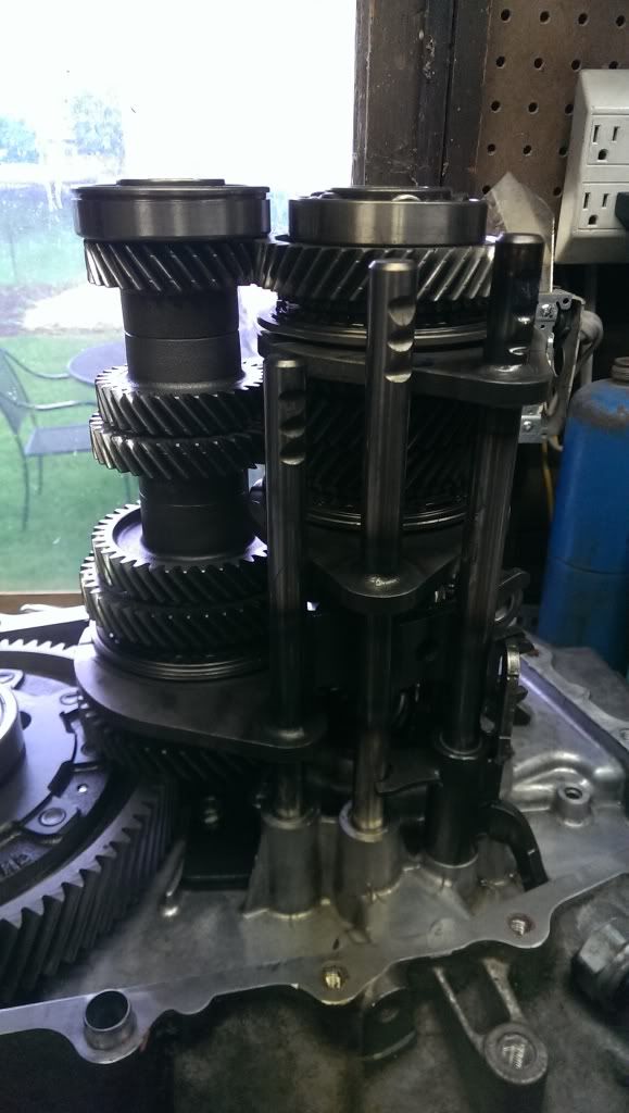

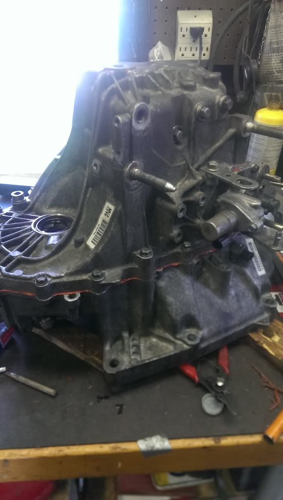

Finally got eveything together again...
Ep3 trans with out stock 6th gear (i didn't have time to get a longer sixth :hiding:)
http://i901.photobucket.com/albums/a...ps761a4e75.jpg
All together...don't really wanna see this guy on the bench anytime soon
http://i901.photobucket.com/albums/a...ps05dc3349.jpg
Everything in the pics is already on the car. I am waiting for shift cables then the car will be golden. :waiting:

So you're running a 5-speed now? Or are you using an oem 6th?
Hows everything, hopefully back together?
He is on a 5 speed now, but it sounds like the 5 speed he got was put together with a bunch of beat up transmissions and isn't working too well for him. He his going to replace the third gear in his old 6 speed and go back to that with the 4.3 fd. He's in OCMD this weekend, prob won't be on here!
Whelp a bit of an update. I have about 35 miles on the new trans and things are feeling good so far. The vibrations my car makes are less but still kinda more than i expected...also the throw out bearing is a bit loud...o well

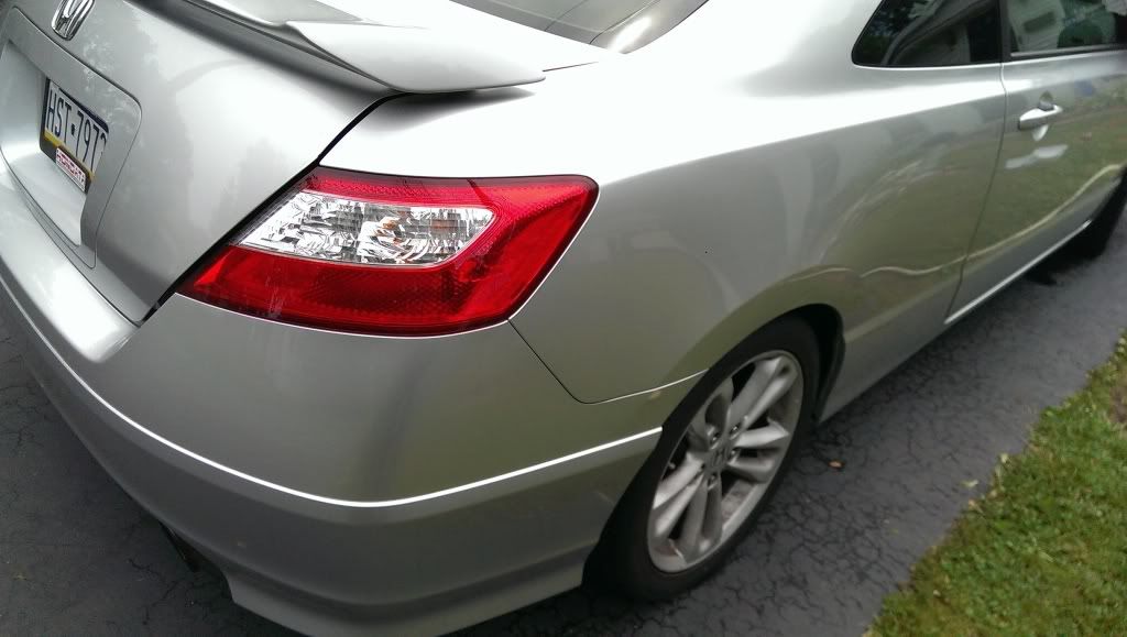

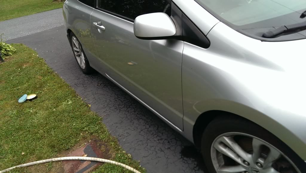

I also washed / claybar'ed/ paste waxed my car for the first time ever :hiding: Decent results were had
http://i901.photobucket.com/albums/a...g?t=1372015861
http://i901.photobucket.com/albums/a...g?t=1372015836
http://i901.photobucket.com/albums/a...g?t=1372015826
http://i901.photobucket.com/albums/a...g?t=1372015819
http://i901.photobucket.com/albums/a...g?t=1372015801

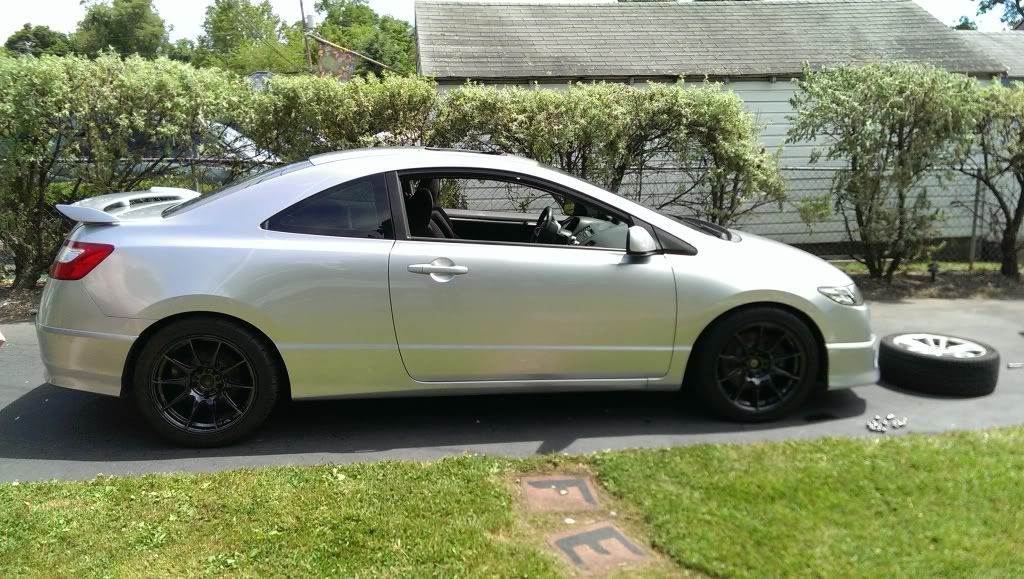

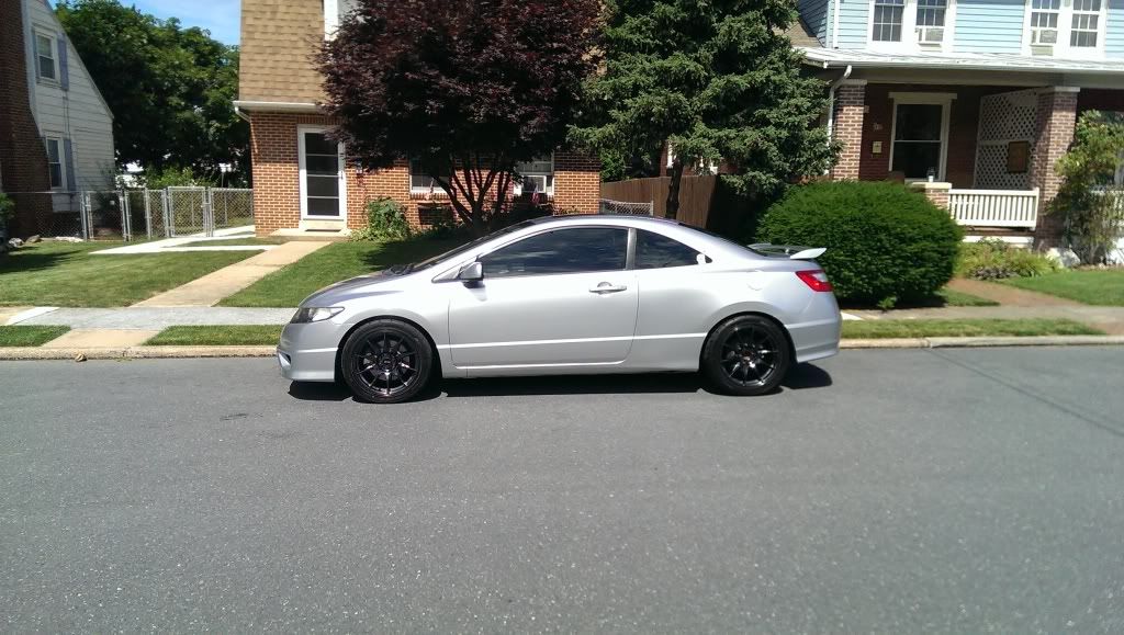

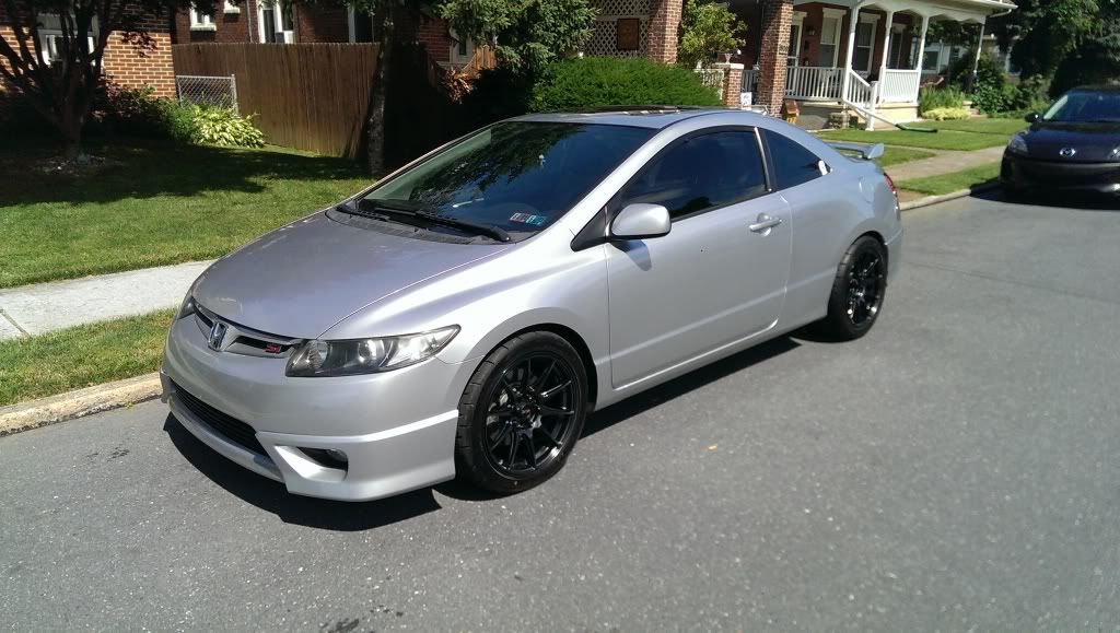

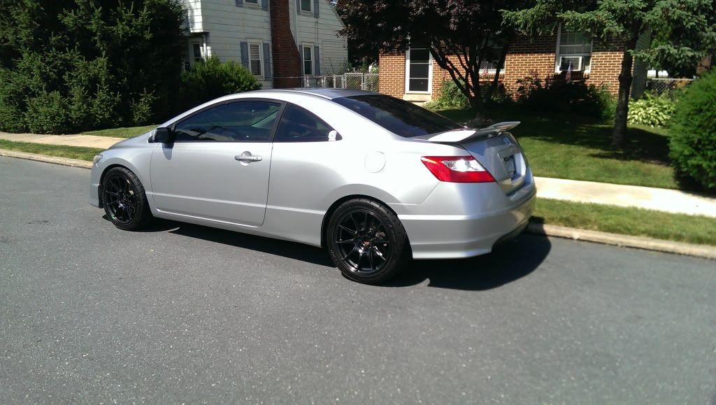

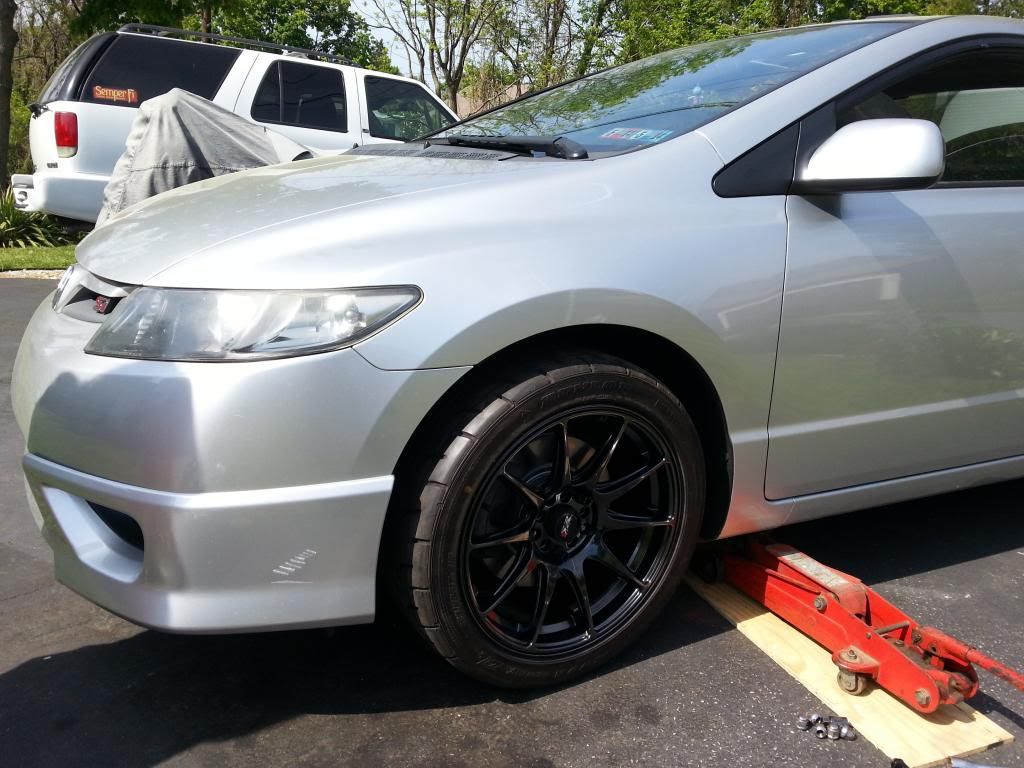

Then I put my rims on finally :escaper:
http://i901.photobucket.com/albums/a...g?t=1372015749
http://i901.photobucket.com/albums/a...g?t=1372015740
http://i901.photobucket.com/albums/a...g?t=1372015714
http://i901.photobucket.com/albums/a...g?t=1372015707
Pretty flush
http://i901.photobucket.com/albums/a...g?t=1372015785
Sent from my HTCONE using Tapatalk 2
Looks great man.
Thanks! i had these rims sitting around since feburary waiting for the car to be happy and running again :giggle:
Looks great! Great detail job and the car sits so aggressive! What wheels and tires are those, and what size are they?
Thanks! Its defiantly way meatier than the V12's on stock rims :giggle:
The wheels are xxr 527's 17x8.25 +35 all around
Tires are Dunlop *specs 245/40/17's
All on HFP suspension
