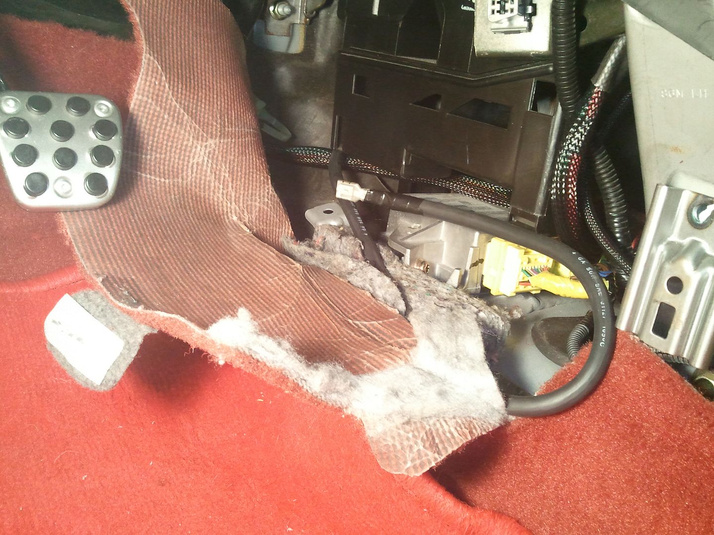

Then decided ok I'm going to run all of my battery cables today... So to start I began with focusing on the fuse box and the starter/Alternator lines
This is where I went into the car from the bay
http://i918.photobucket.com/albums/a...ps9184651f.jpg
Started running line inside
http://i918.photobucket.com/albums/a...ps3d7f6626.jpg

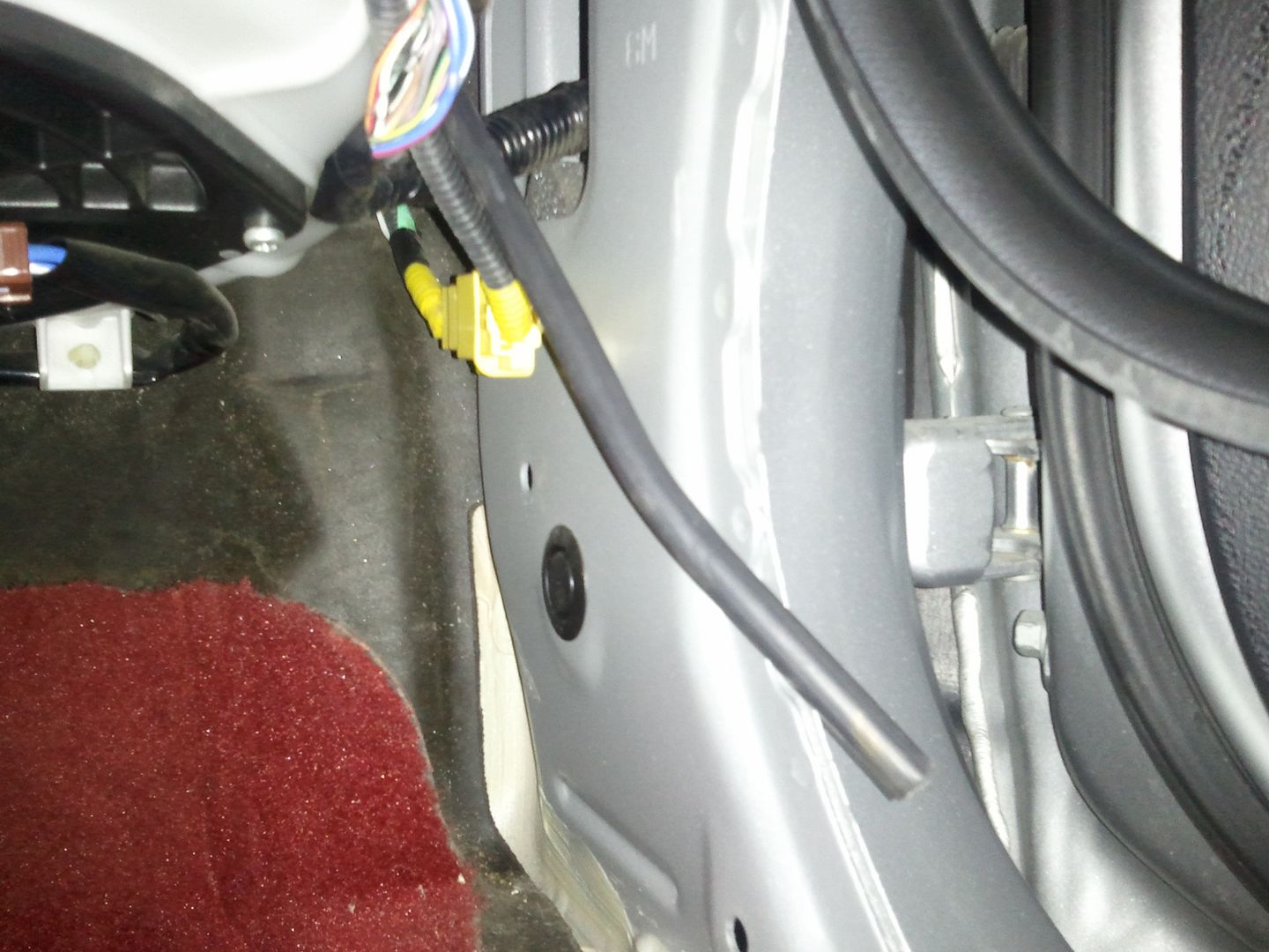

From the inside
http://i918.photobucket.com/albums/a...psc2d9be10.jpg

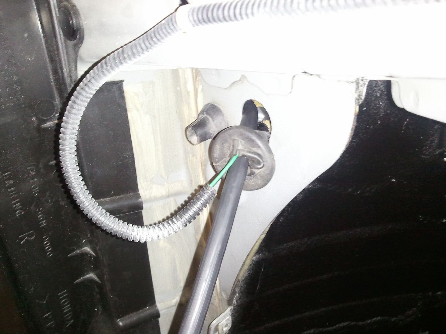

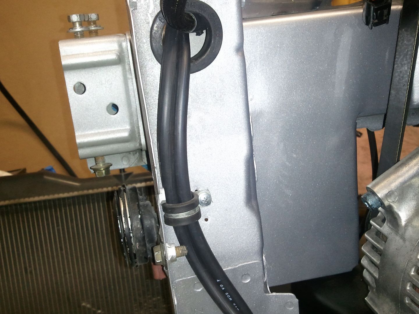

Brought the lines through my grommets and past the radiator
http://i918.photobucket.com/albums/a...ps94433506.jpg
Connected starter and alternator leads
http://i918.photobucket.com/albums/a...ps1065b4b5.jpg

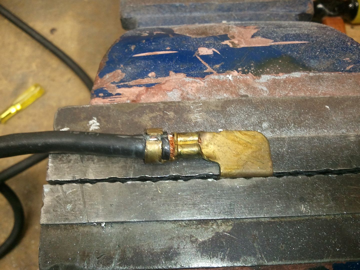

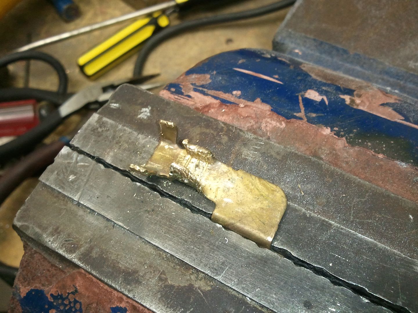

Then modified the factory connector so I could complete my fuse box. Put it in a vise
http://i918.photobucket.com/albums/a...ps74aec9db.jpg
Then opened it up
http://i918.photobucket.com/albums/a...ps01d8c99d.jpg
Put my new cable in it and secured it
http://i918.photobucket.com/albums/a...psdf3b21d3.jpg

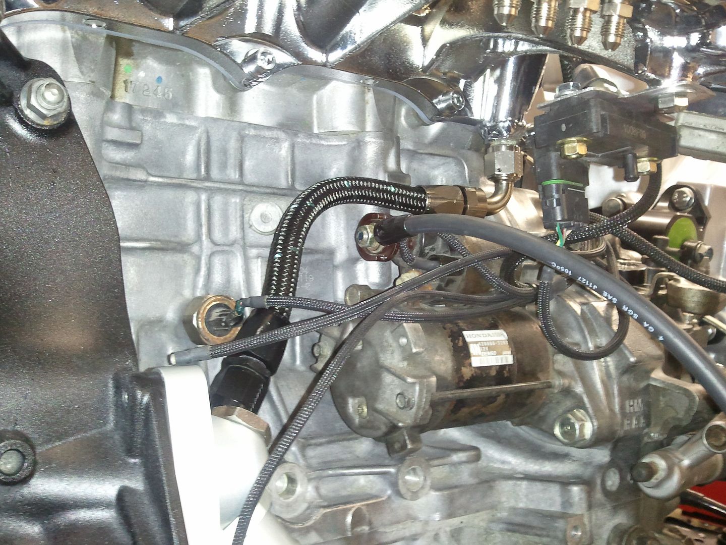

Now time to connect them to my battery line. I'm running a 2 gauge and split it. Mounted my splitter
http://i918.photobucket.com/albums/a...pse5af06da.jpg
Installed my lines
http://i918.photobucket.com/albums/a...pseb11efe8.jpg
Boom tucked away
http://i918.photobucket.com/albums/a...ps6d0a9241.jpg

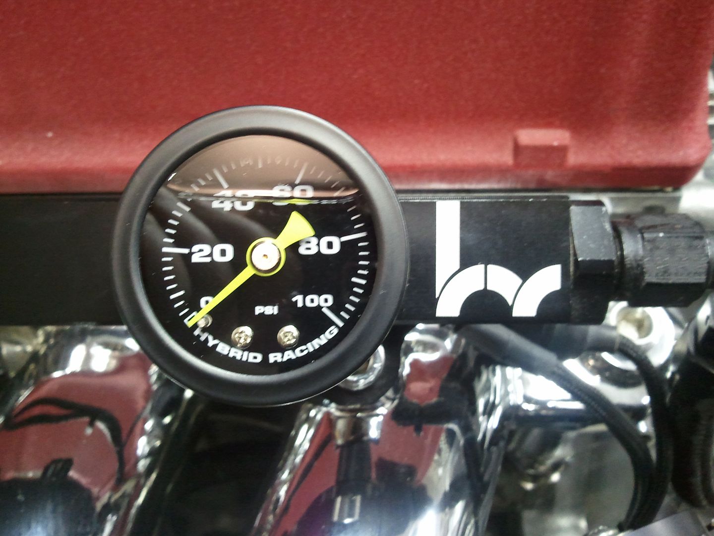

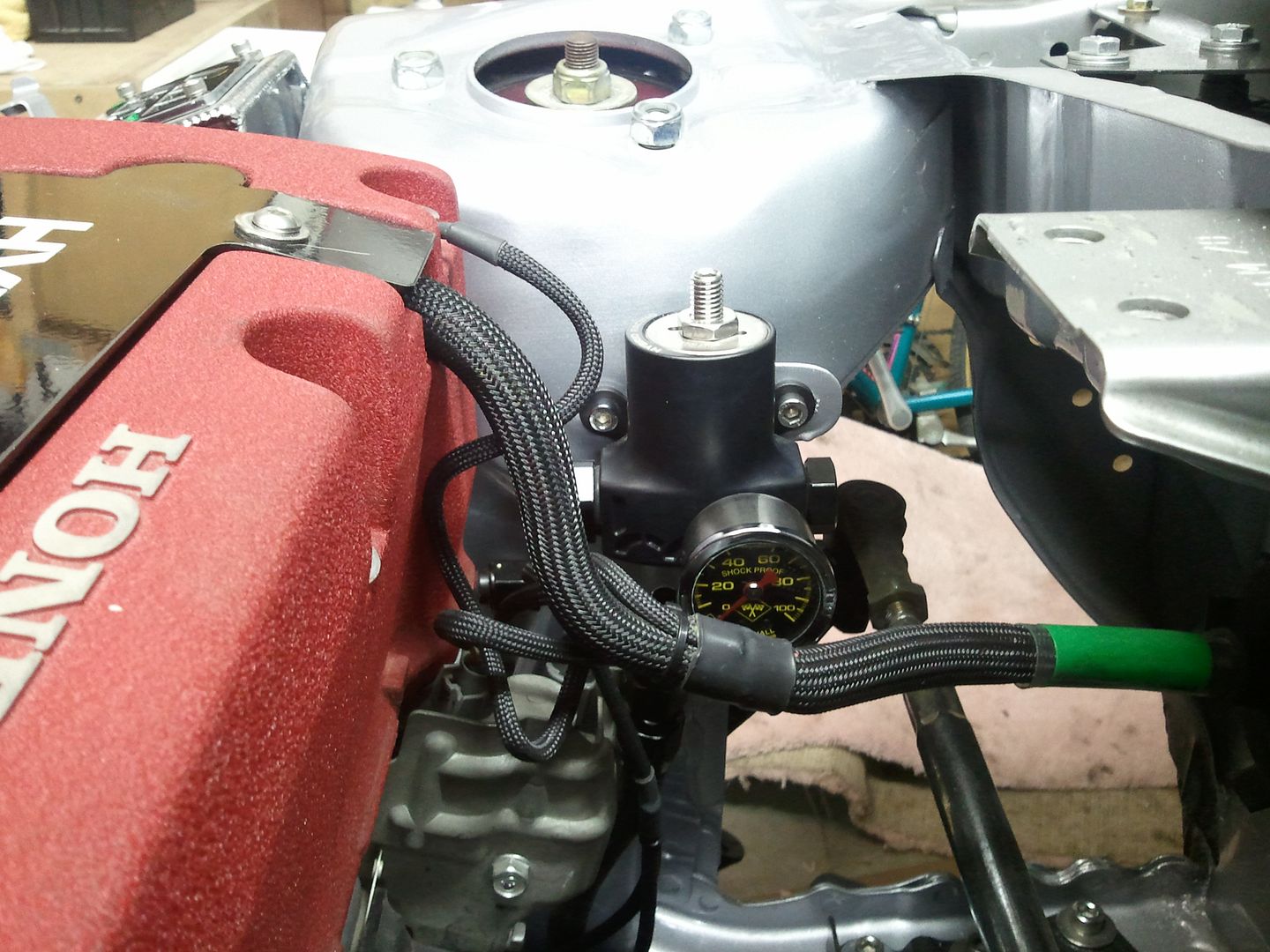

Also installed my Hybrid Racing fuel gauge and mounted the old one on the FPR since I had it
http://i918.photobucket.com/albums/a...ps9d5ca1c4.jpg
http://i918.photobucket.com/albums/a...ps0e858fc2.jpg

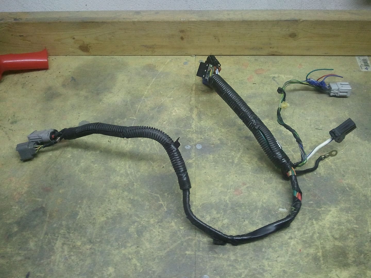

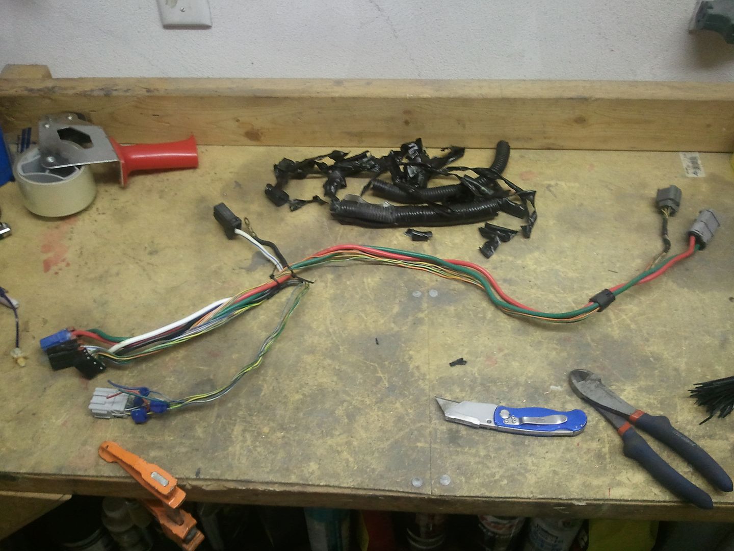

And then decided to redo my EPS harness since everything else was redone.. here is the mess I started with
http://i918.photobucket.com/albums/a...psa6c5e0d8.jpg
Took off all the loom and tape
http://i918.photobucket.com/albums/a...ps5b848a95.jpg

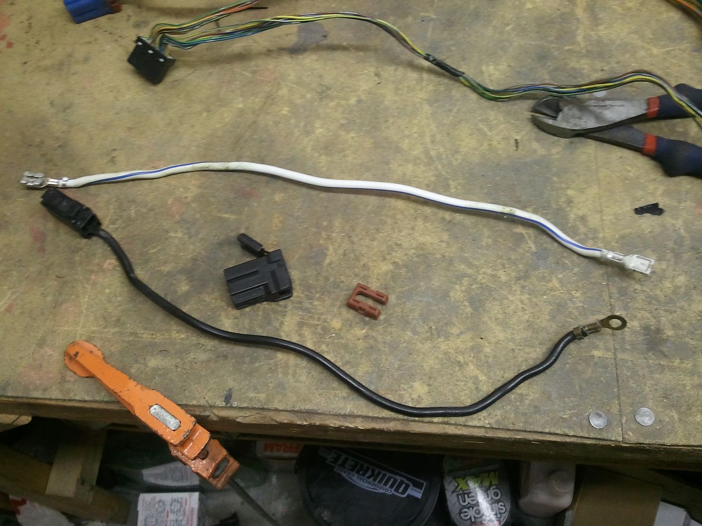

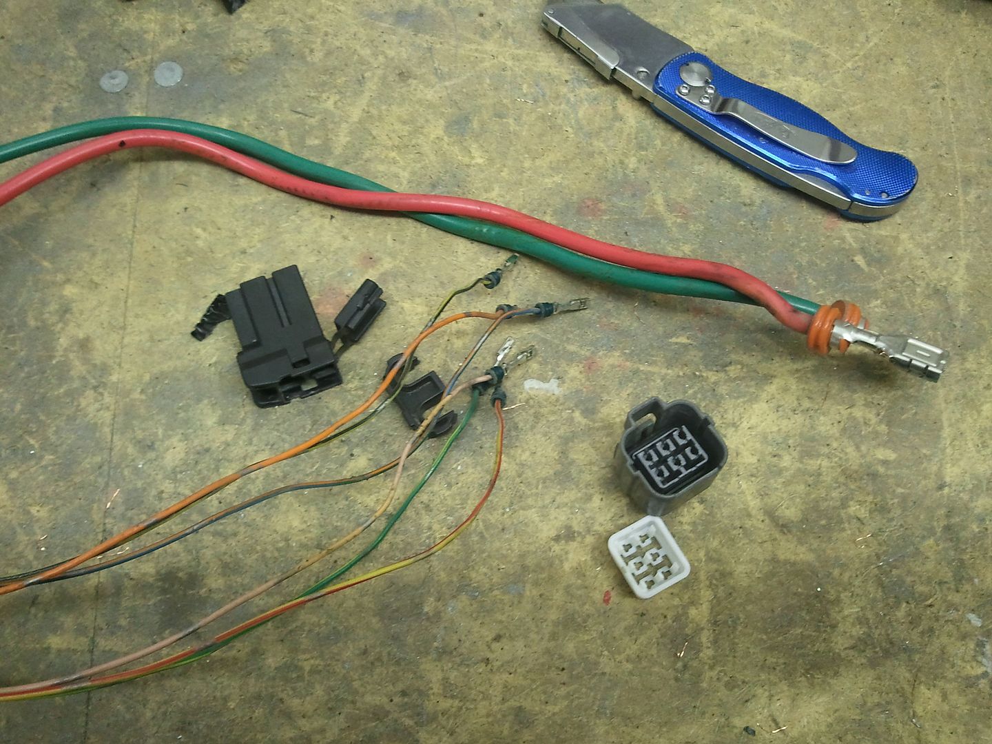

Separated power and ground from the loom so I can run separately and depinned power wire
http://i918.photobucket.com/albums/a...ps88a3b753.jpg
Now make sure you write the pins down.. but de-pinned the plugs
http://i918.photobucket.com/albums/a...pse919d838.jpg
http://i918.photobucket.com/albums/a...ps8bff0cb1.jpg
And then made my own loom and put back together. Much cleaner
http://i918.photobucket.com/albums/a...psf2f69af1.jpg
http://i918.photobucket.com/albums/a...ps0b7c9988.jpg

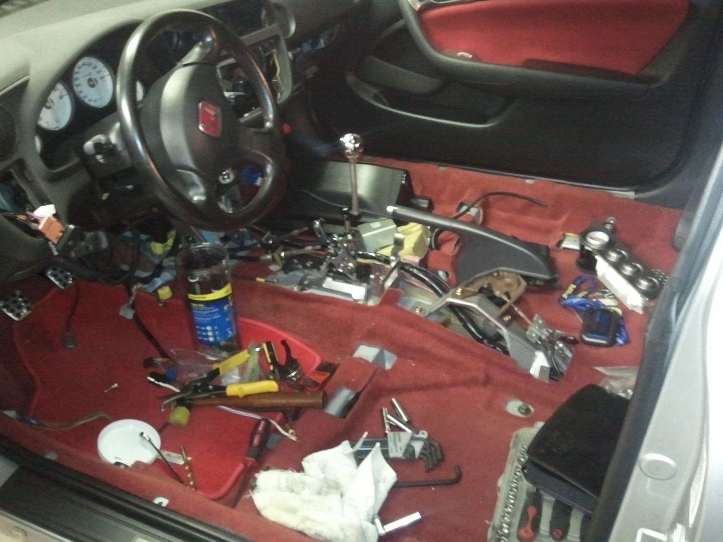

man I am spent.... I literally put the rear panels in and out like 50+ times trying to put it all back together....

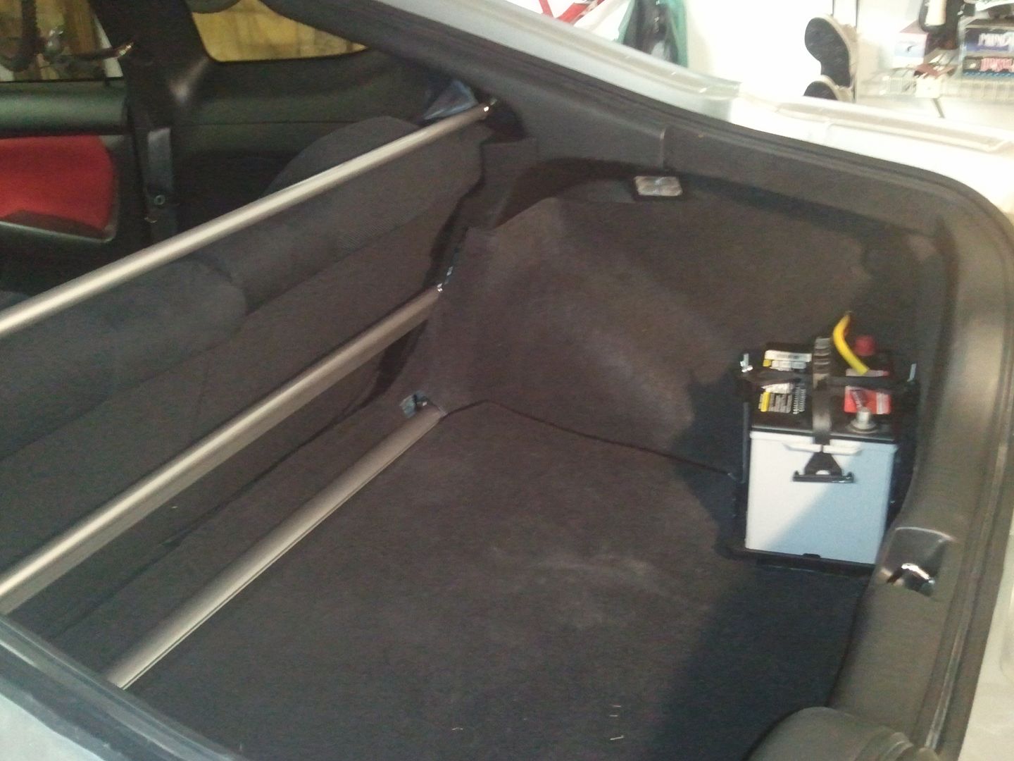

So I am putting my battery back in the trunk. So today my goal was to mount it and start putting the interior back together... I was getting so frustrated there aren't a lot of photos.
Ran the line to the back and secured it
http://i918.photobucket.com/albums/a...ps5067f6ab.jpg
http://i918.photobucket.com/albums/a...ps1863cb5d.jpg

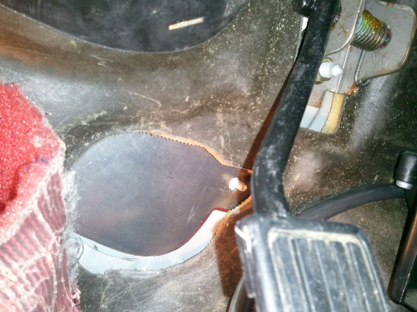

Bought this battery tray. But it's not level where I want to instal it. So of course I started making a bracket.
http://i918.photobucket.com/albums/a...ps6b713dbe.jpg
this wasn't working fully
http://i918.photobucket.com/albums/a...ps81652cbc.jpg
So I welded a bottom lol
http://i918.photobucket.com/albums/a...ps3149fa83.jpg
Then put it in place in the car and drilled the mount holes
http://i918.photobucket.com/albums/a...ps80d8221b.jpg
And installed a brace washer underneath
http://i918.photobucket.com/albums/a...psff05766f.jpg

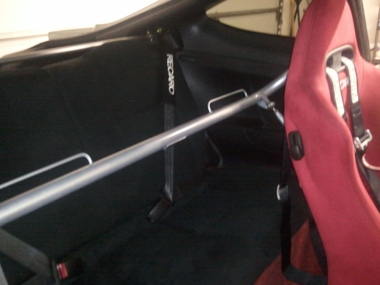

Then started putting all of my bars and interior together.
http://i918.photobucket.com/albums/a...ps41ef0349.jpg
http://i918.photobucket.com/albums/a...ps3c959de9.jpg

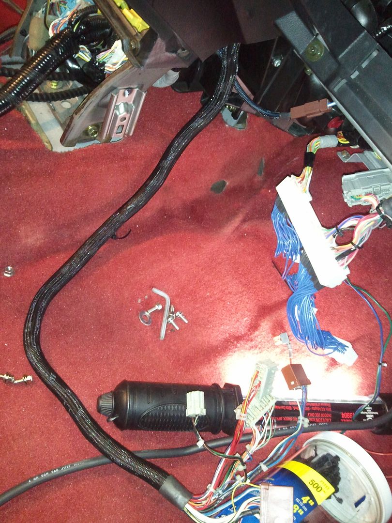

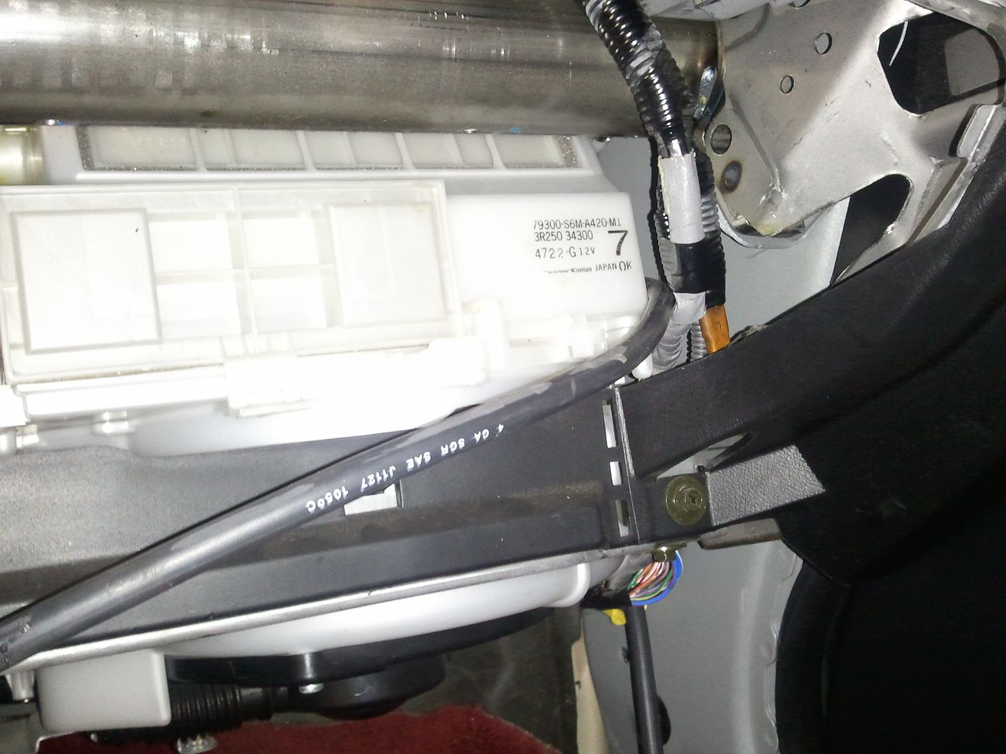

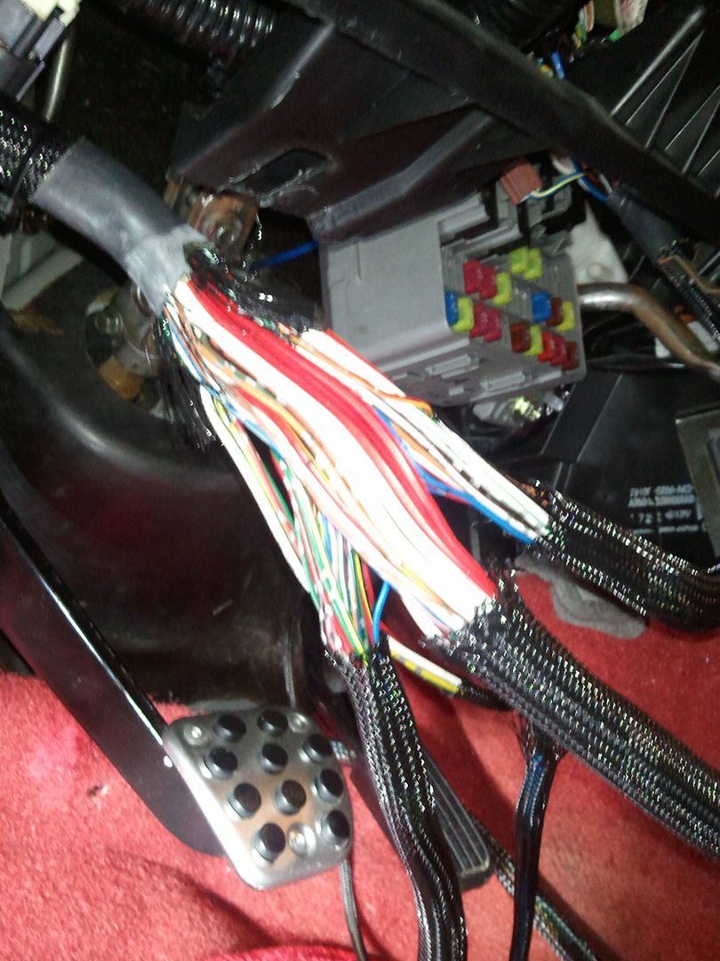

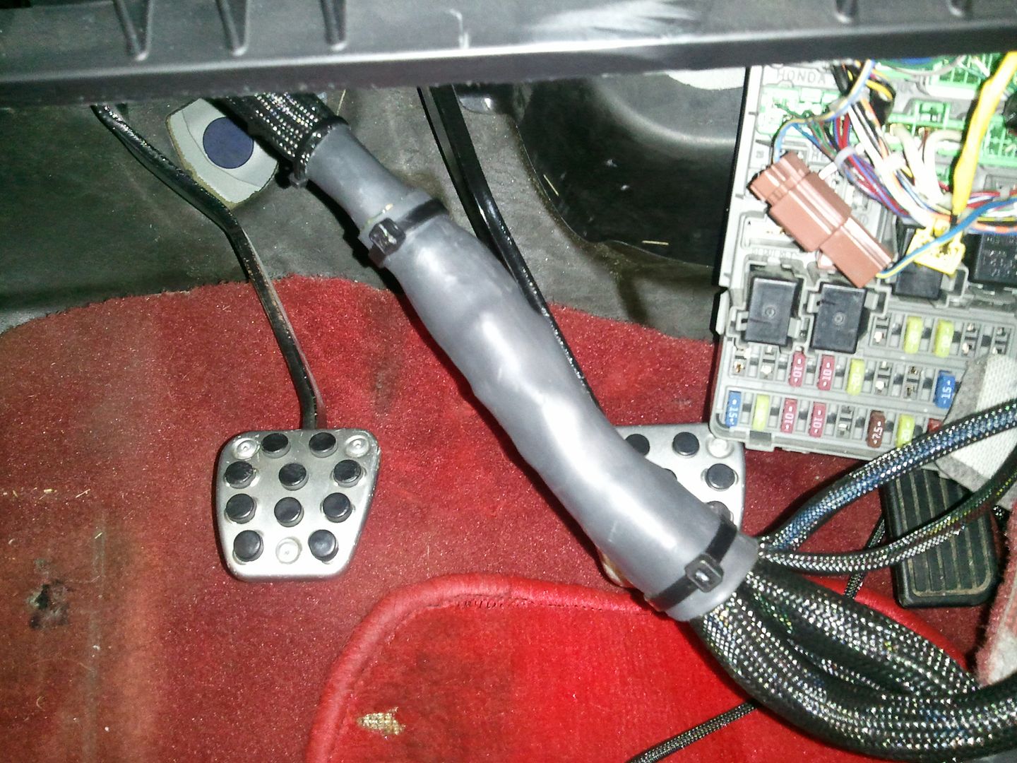

So interior wiring is around 90% finish thank god... my fingers can't take these little clips and shit anymore....

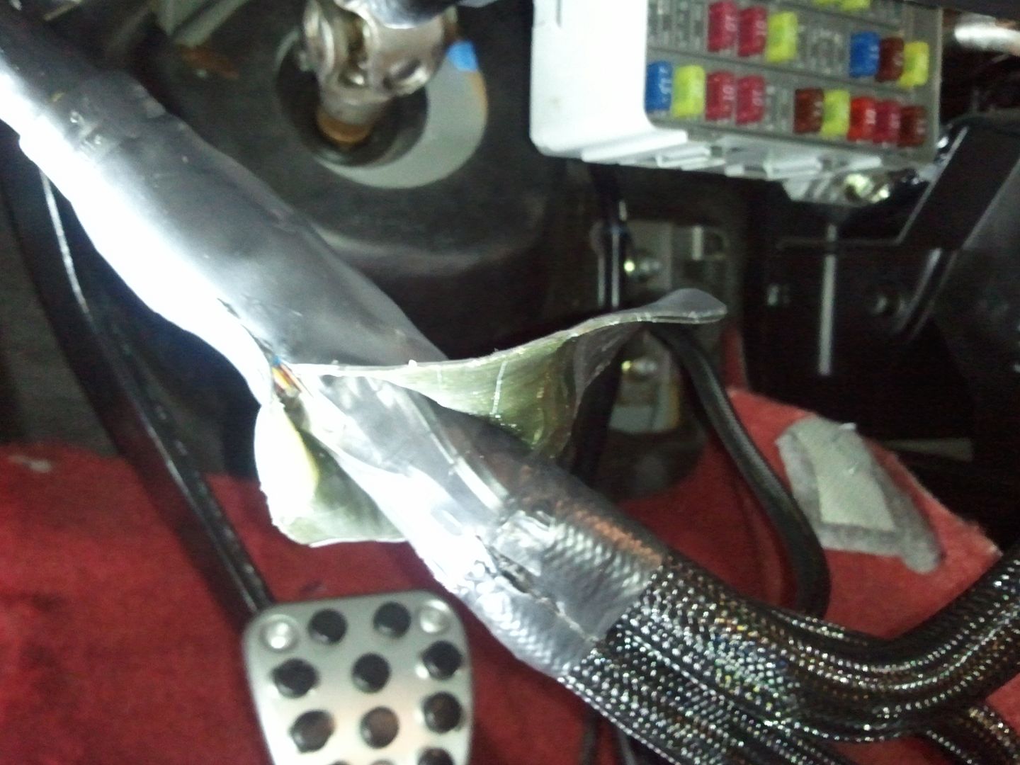

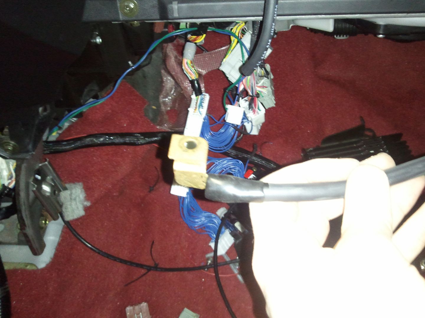

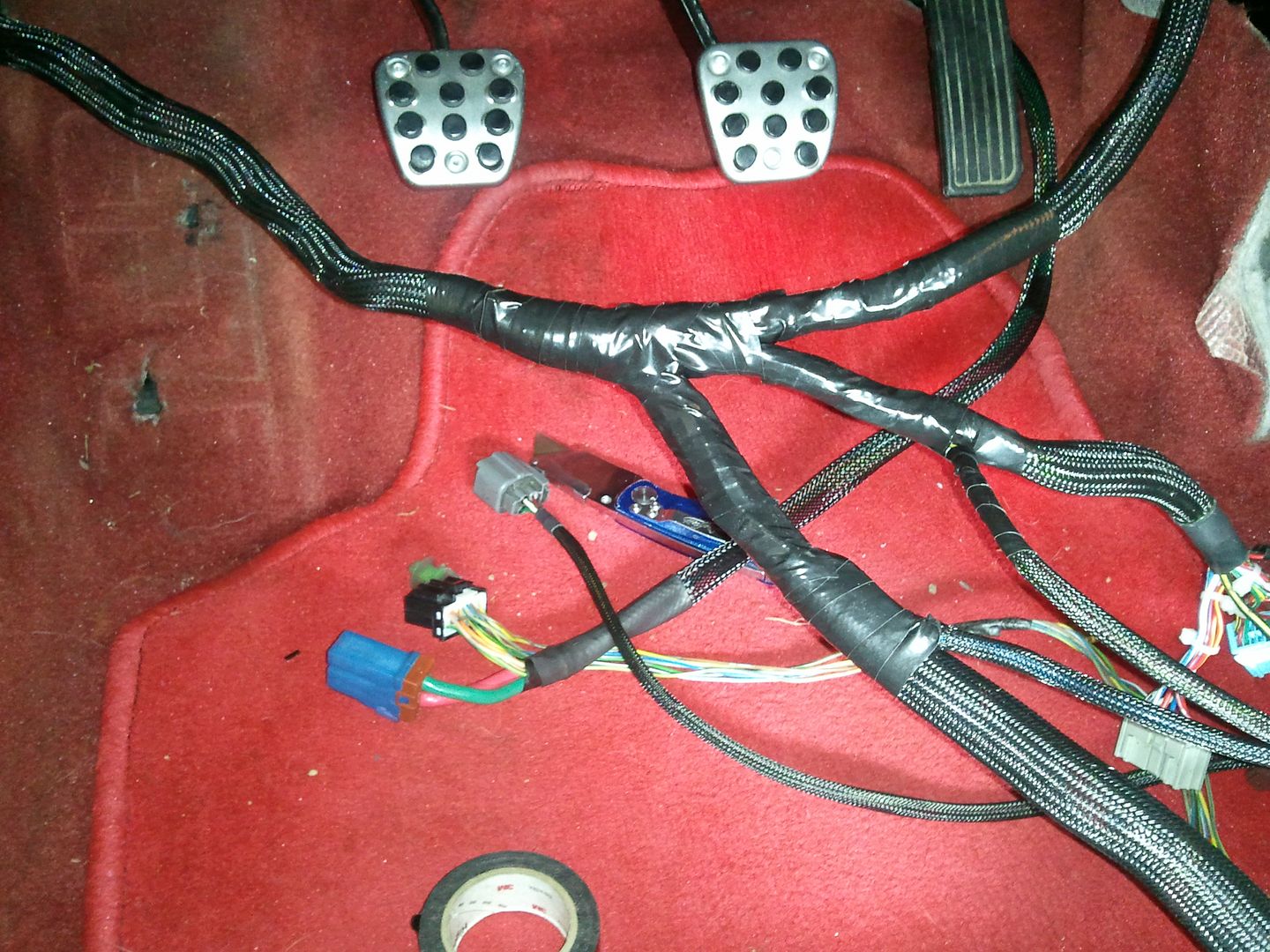

So my big issue was this big fucking wrap my buddy put on the harness. I couldn't get the harness to fit for shit because of it...
http://i918.photobucket.com/albums/a...ps7b75432c.jpg
So I hacked away at it and started cutting it out
http://i918.photobucket.com/albums/a...pscaf4a2a6.jpg
And removed it completely to expose the wiring which gave me a lot more room to work with!
http://i918.photobucket.com/albums/a...ps0b927842.jpg
Since it's a tucked harness I just wrapped it back up with electrical tape...
http://i918.photobucket.com/albums/a...ps3eb82d4a.jpg

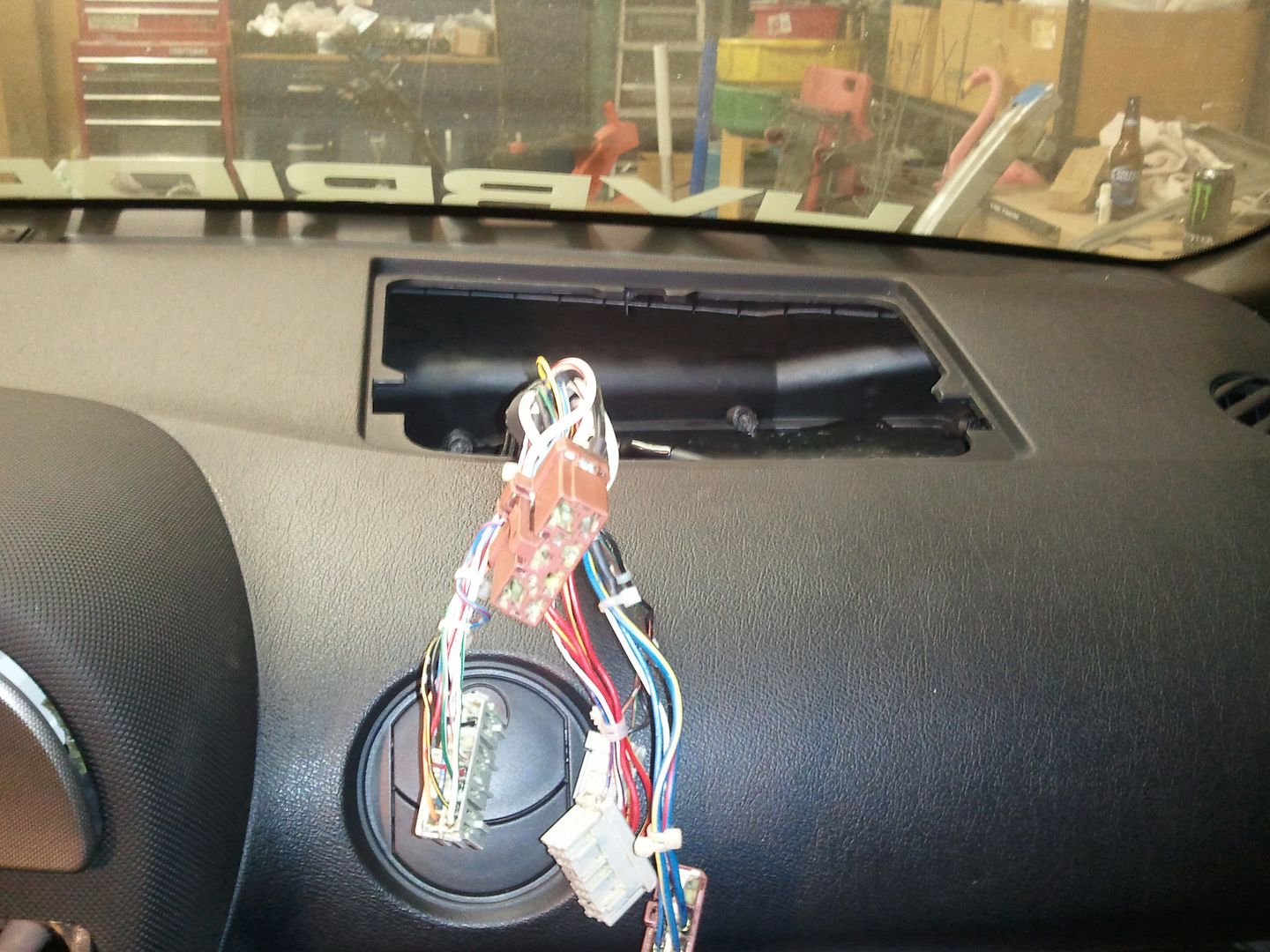

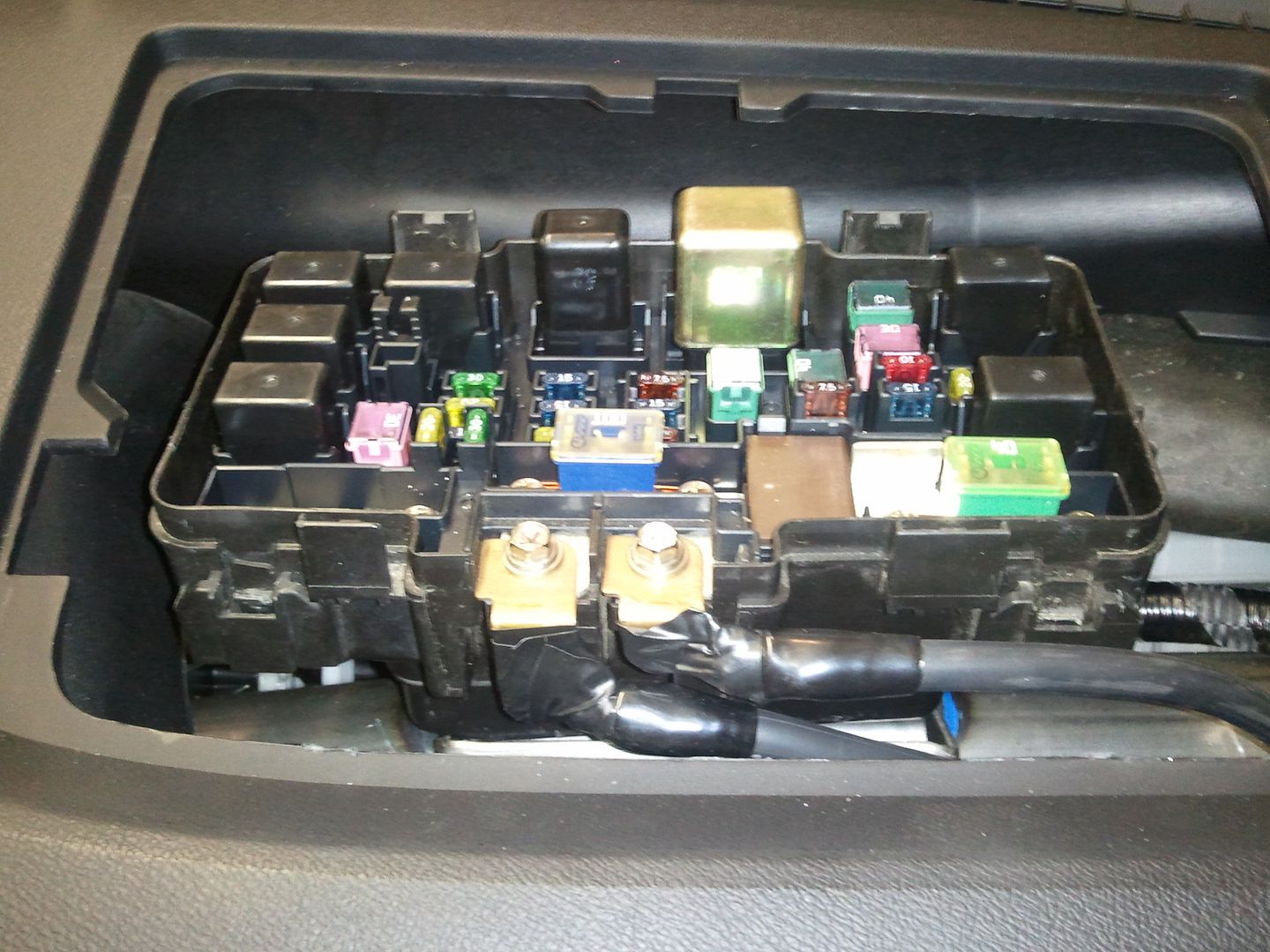

But god damn did it make my life easier!!! Now I ran the harness to the other side for the fuse box
http://i918.photobucket.com/albums/a...ps98925407.jpg
and out the top
http://i918.photobucket.com/albums/a...ps59b297dc.jpg

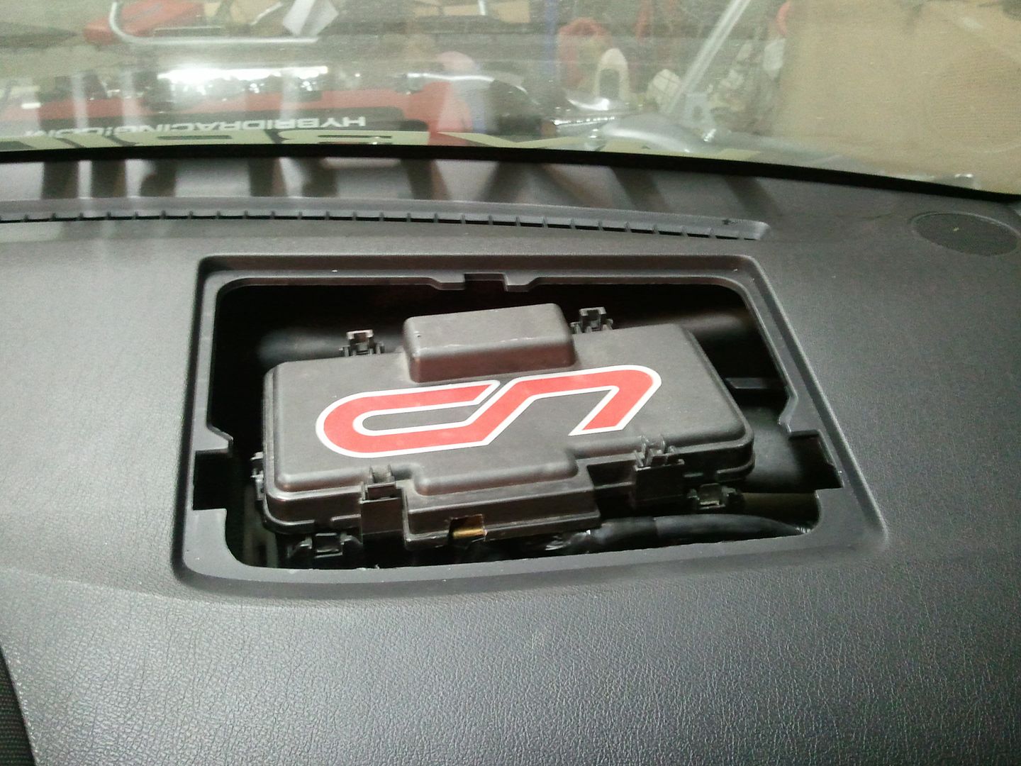

Boom finished with fuse box!
http://i918.photobucket.com/albums/a...psac2c97e3.jpg

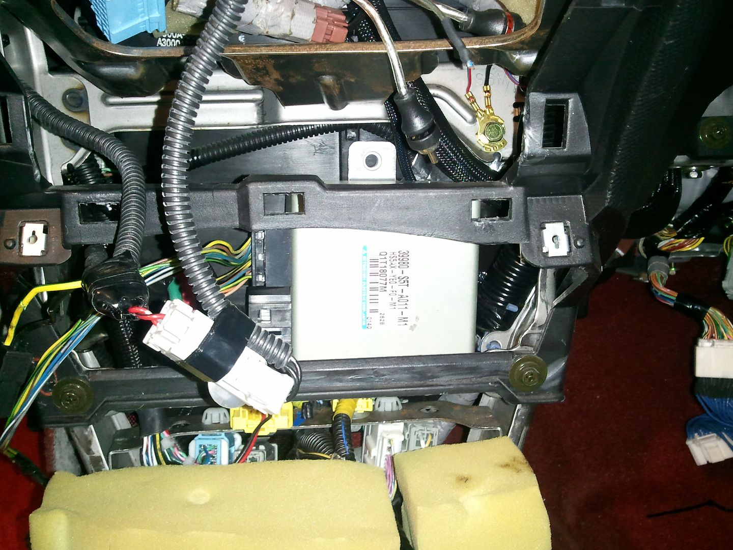

Then decided I was going to tuck away my EPS module in the center console
http://i918.photobucket.com/albums/a...psc7ed60ff.jpg
Re did the power pin but haven't full finished so I'll leave off here
http://i918.photobucket.com/albums/a...psdc007035.jpg

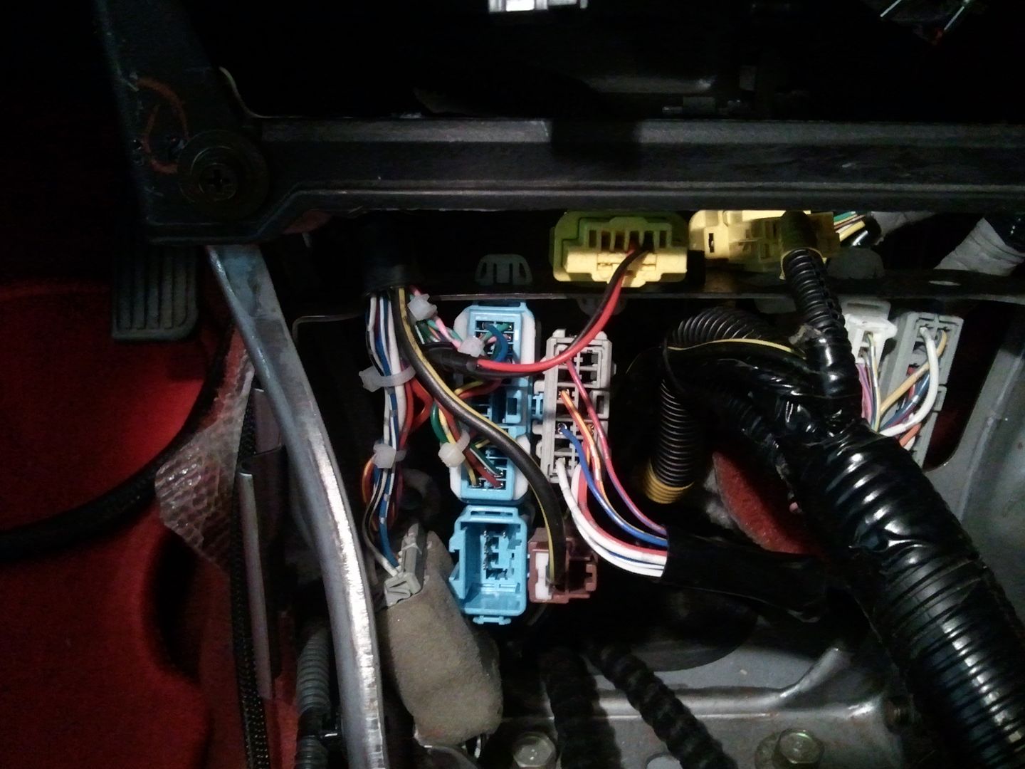

But also..... does anyone know what connector this is that has nothing plugged into it lol I cannot remember! (bottom blue one)
http://i918.photobucket.com/albums/a...ps67fe2317.jpg

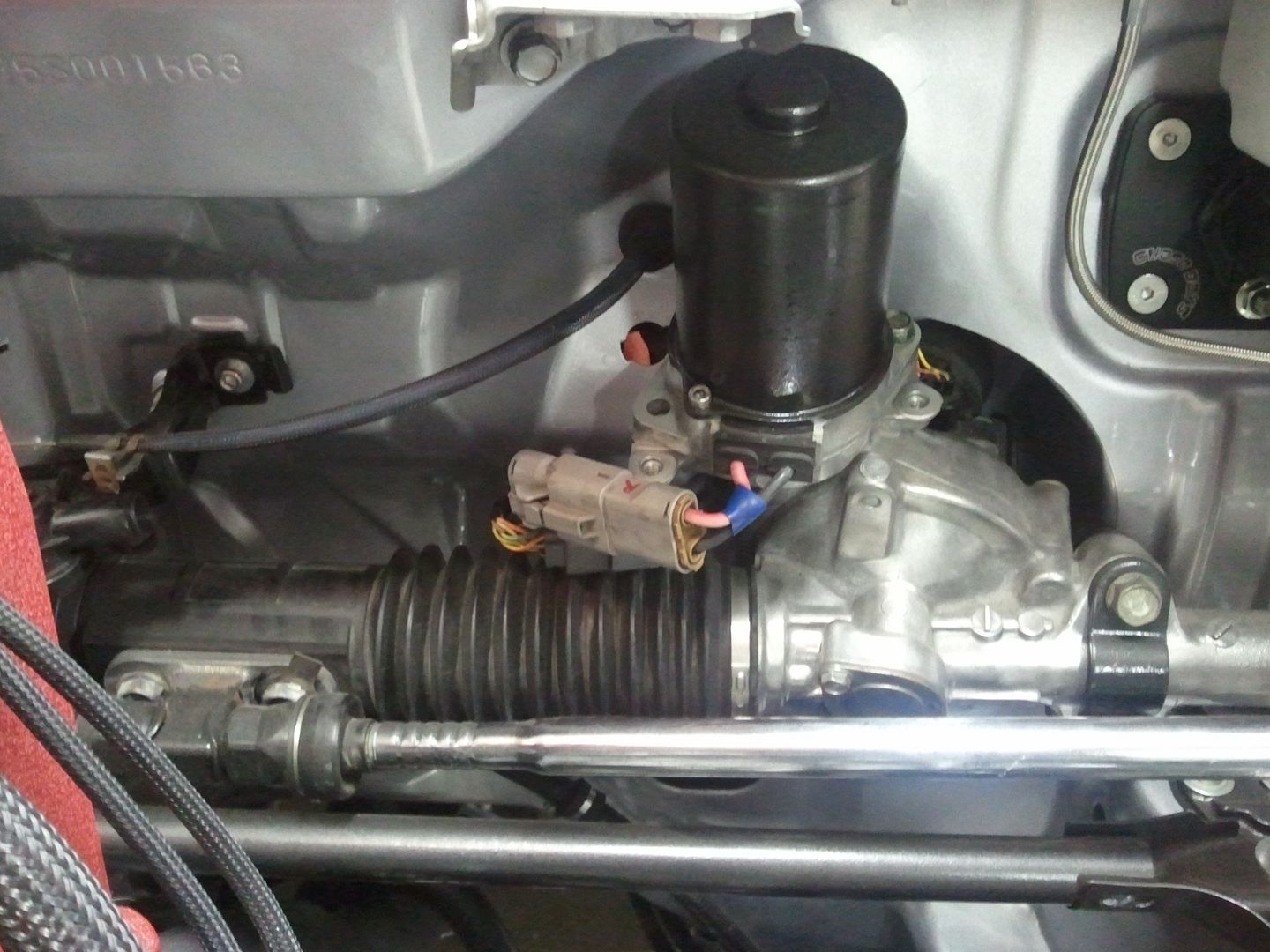

So I finished wiring up my EPS.... put my new power line in the connector and ran it to the module
http://i918.photobucket.com/albums/a...ps703d0be7.jpg
http://i918.photobucket.com/albums/a...ps0bbbf1f3.jpg

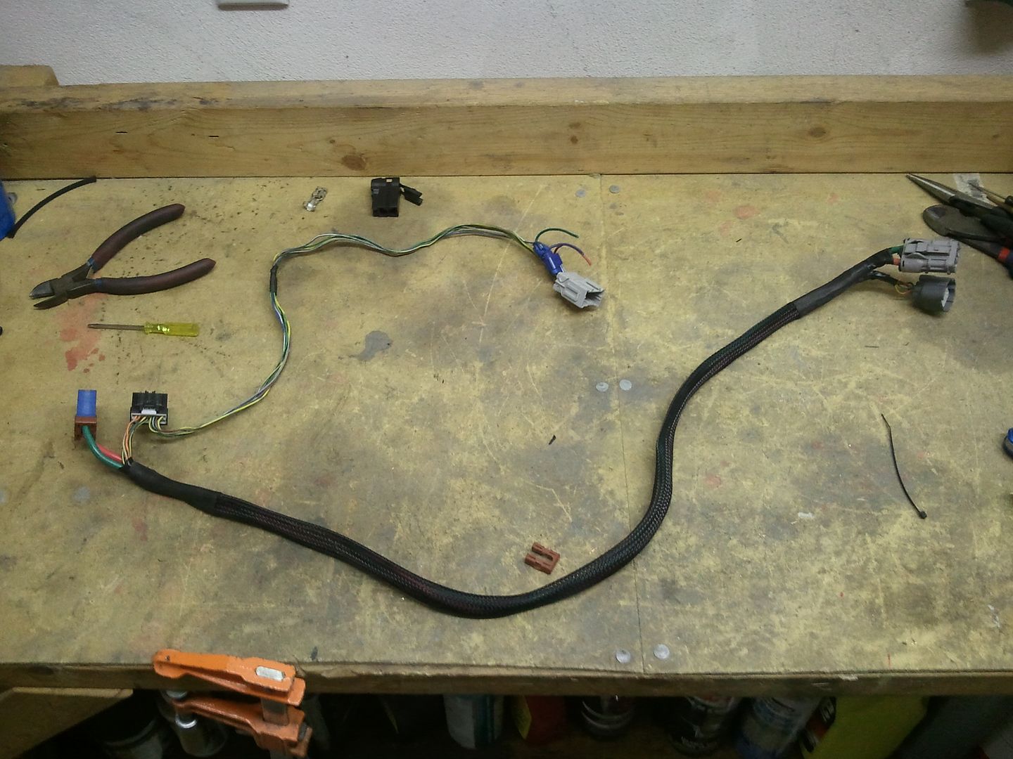

I then made a new piece for my EPS loom
http://i918.photobucket.com/albums/a...psf3a2dd33.jpg
added a grommet
http://i918.photobucket.com/albums/a...ps0cc1d1d5.jpg
Then installed
http://i918.photobucket.com/albums/a...ps1590f762.jpg

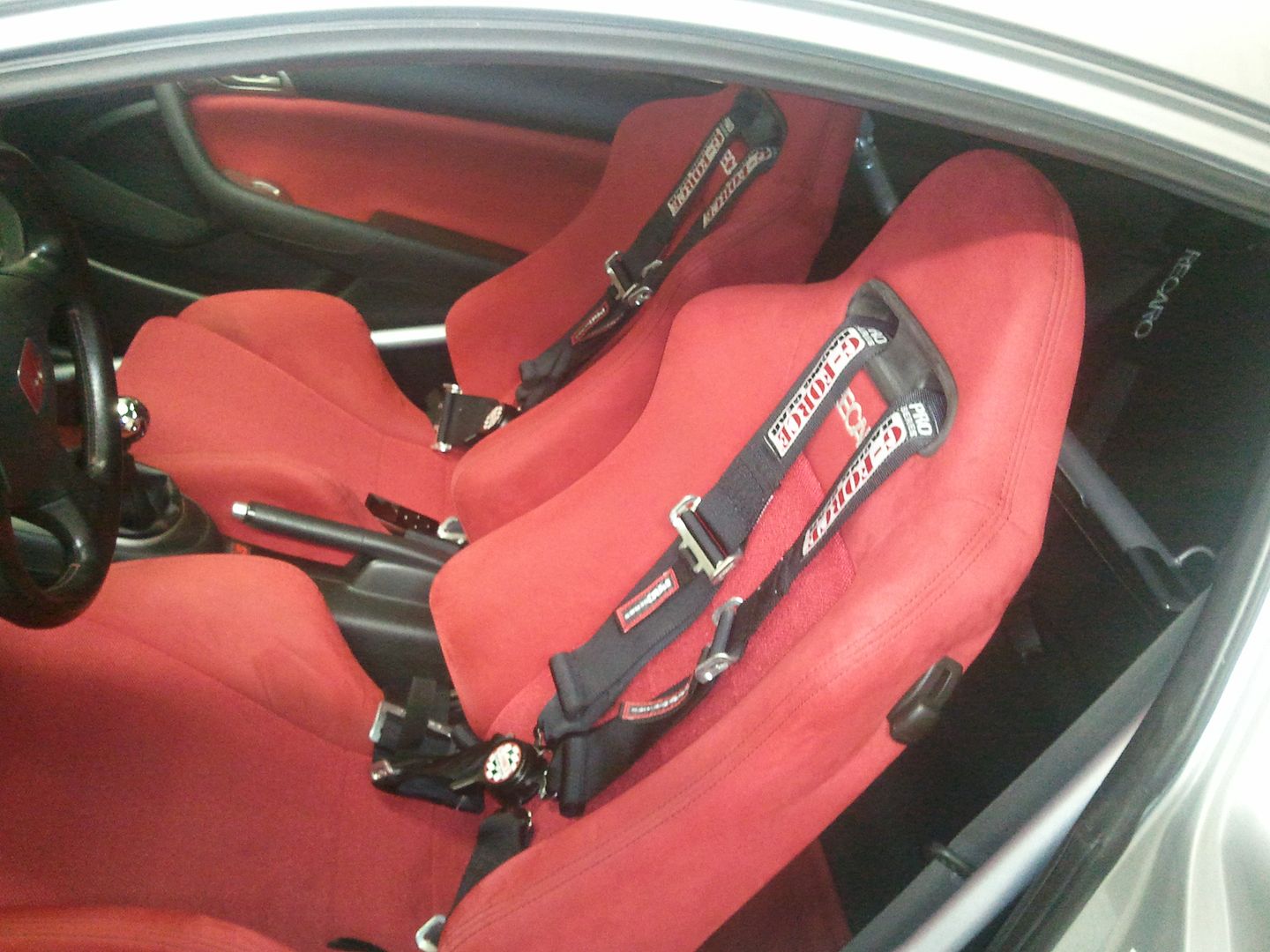

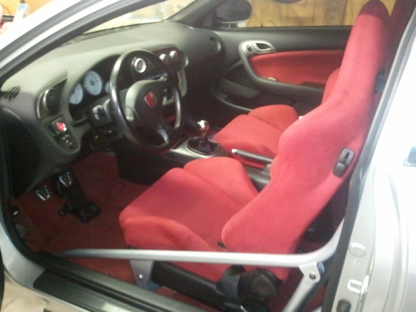

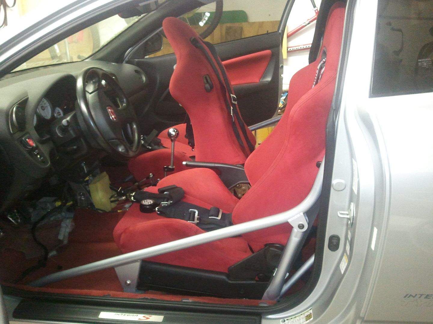

Then finished off my interior... some of you will hate it.. but I was sick of all the mis matched off colors... so I painted all the bars SSM which I'm extremely happy with! I think it's super clean and more subtle... some loved the stand out of the blue but I didn't like all the different shades and colors
http://i918.photobucket.com/albums/a...ps695e7e37.jpg
http://i918.photobucket.com/albums/a...ps988796f5.jpg
http://i918.photobucket.com/albums/a...ps2e2fd62a.jpg
all finished
http://i918.photobucket.com/albums/a...psd4296bec.jpg
