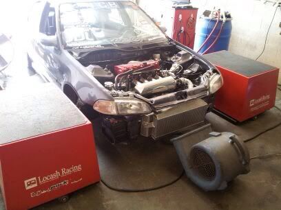

the only problem with the 8th gen civics and that there is no one willing to lend their car to use it for mock up in phoenix. bodyman will get a manifold shortly to dyno it with his water to air setup. i was told yesterday that locash racing will MAYBE dyno the four door this week, thats a maybe. once i get any boost graph i will post asap :thumb:
the car is from phoenix. this manifold setup was on the car for wekfest and eibach and we took it the nisei this pass weekend

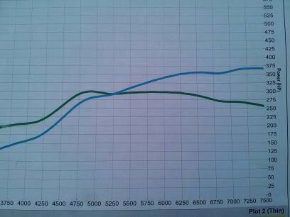

370hp 300 trq 12 pounds on spring ... As soon as I get the graphs from my buddy I'll post up
I expected more at 12psi from that turbo. Is this a built motor? Im really contemplating going to AZ to get this done, it would have to be a hell of a price though.

Looks like it needs more tuning if possible ?
12lbs on that turbo should have been over 400Hp in my opinion. Who is the tuner
Yeah that is a large turbo.... I made that much power with a much smaller turbo, on a log manifold, and at 15 psi....
It's definitely NOT DONE TUNING ..
Ok well then that's the reason! You should be making north of 400whp probably even 450 with that turbo!
It doesn't matter if its gate only or not, its still 12 psi..... And yes of course it was tuned on gate only then boost was increased.
:yeahthat: But it's still not done so let's stay in for reviews. There are other factors as well, such as charge pipe size, intercooler, fuel (I assume this is pump 93), so let's see what happens. So far it sounds great!
