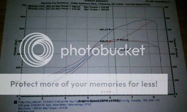

Any dyno graphs fellas?
I think this is the right graph we went fro z1 cams to the kelford b cams gained 97 hp and 80 ft lbs at 6300rpm s this was on Q16

Wow that is an amazing gain!
Any valvetrain upgrades?
oem valves supertech springs , seats , rets , seals and arp studs my car is currently apart and I am goin to be doing supertech valves and bronze valve guides as well this time due to a machine shop screw up the end power result was nearly identical but the mid range gains were very impressive to say the least and it was very noticeable haha
