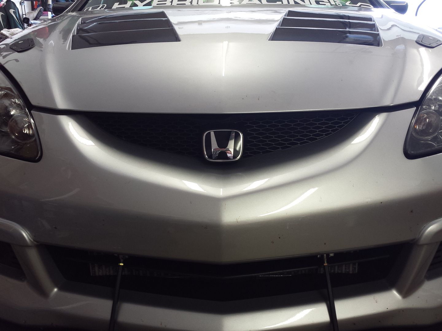

Decided the red stands out to much in the front badge with all of my black accents
http://i918.photobucket.com/albums/a...ps6ygsohiu.jpg
So I did a black vinyl overlay
http://i918.photobucket.com/albums/a...psphfv2vci.jpg

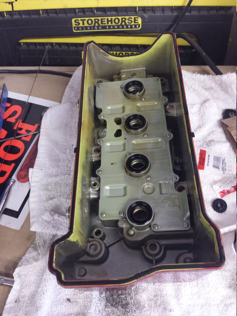

Then decided to search for the mysterious oil leak. So off with the valve cover

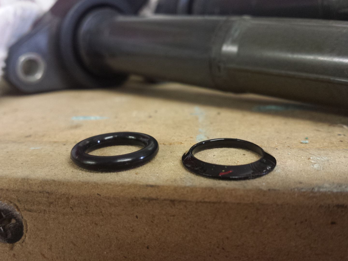

New oring verse old one from skunk2... they flatten pretty easy lol

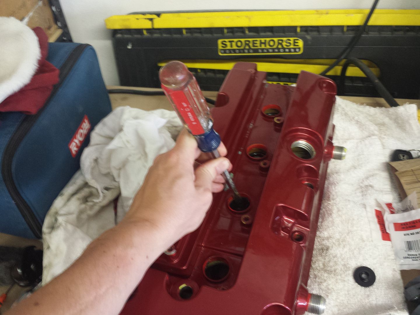

easy way to pop out those spark plug gromments

Why not use factory seals there?

yeah those orings are for the Skunk2 grommets... they leak like fucking crazy PITA
