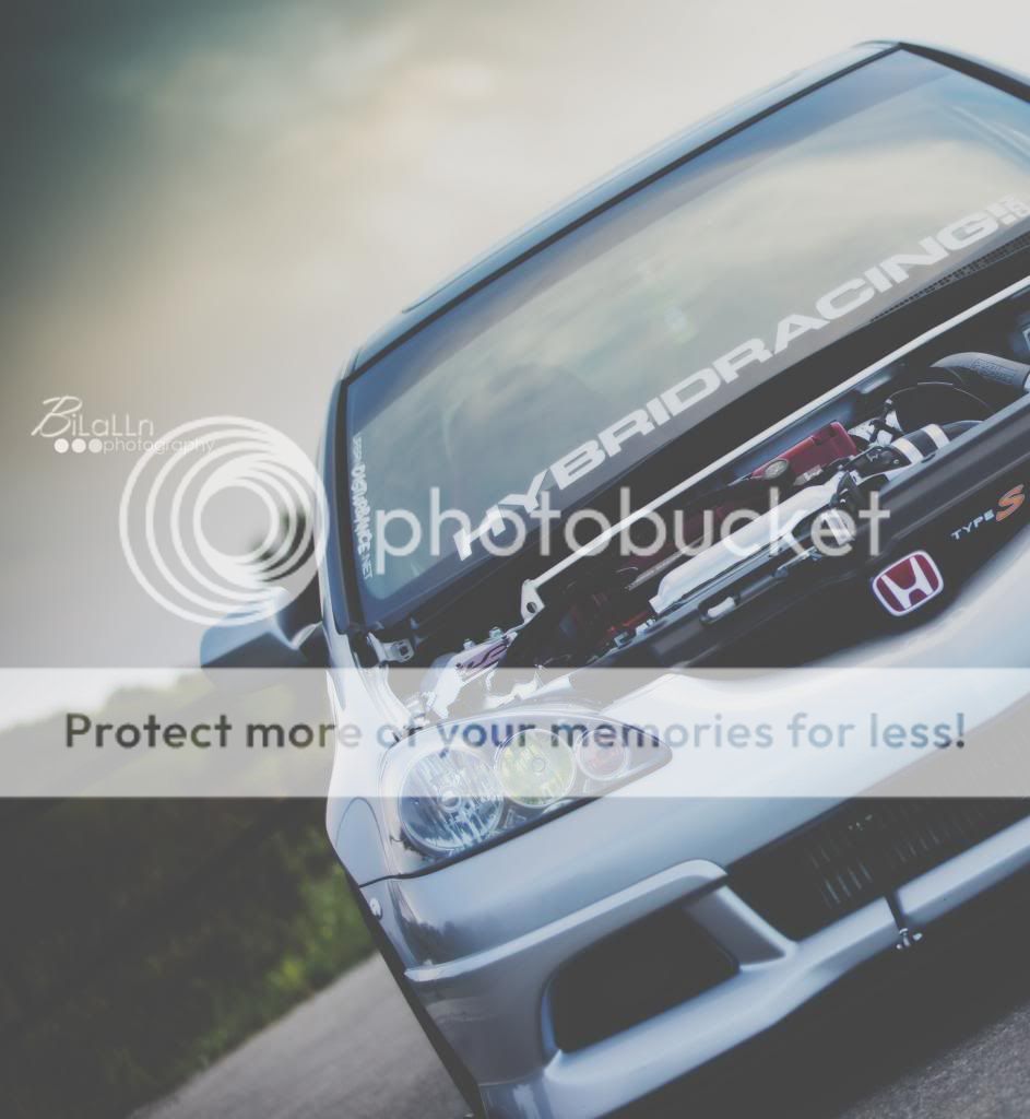

Ok here they are... final end of the year photos... Love them! Special thanks to B1LaLLn

love this rear shot!

wow those came out nicely! Im never been a fan of those wings, but it fits yours well.
your car always looks so great! nice to see its back to boost.
so awesome!

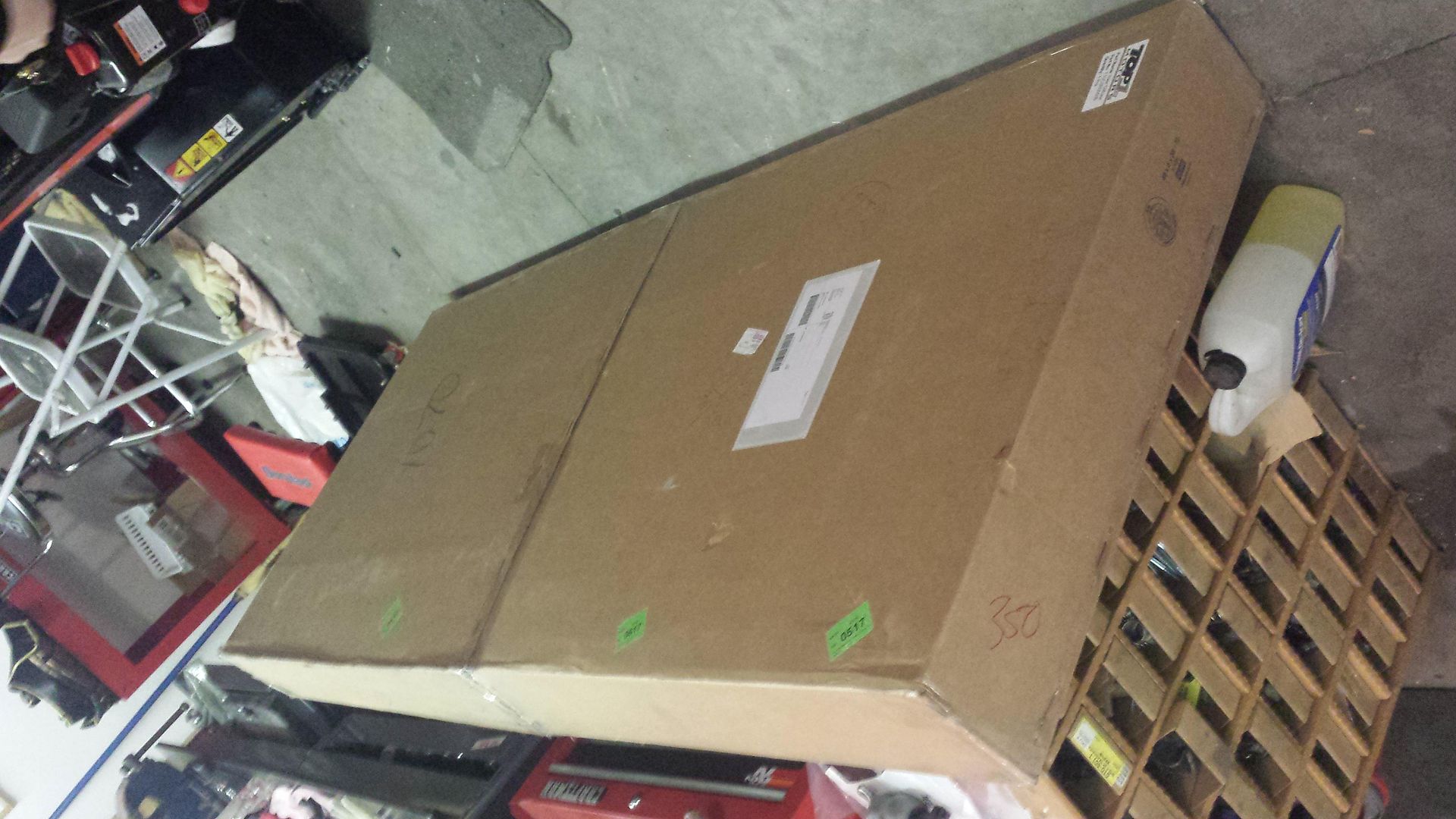

Alright so I come home from New Orleans and I find this in the garage
http://i918.photobucket.com/albums/a...ps4773e53a.jpg

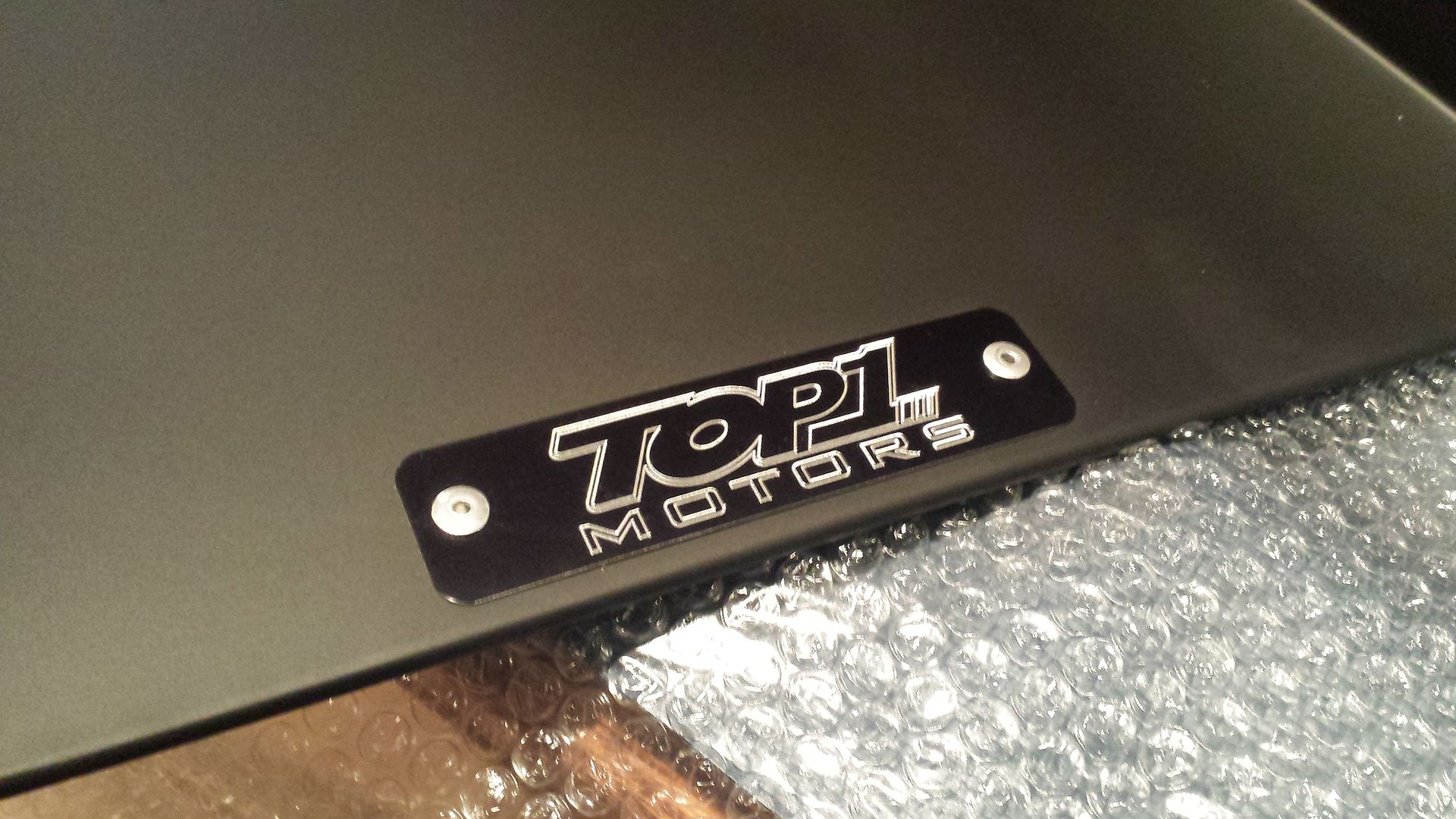

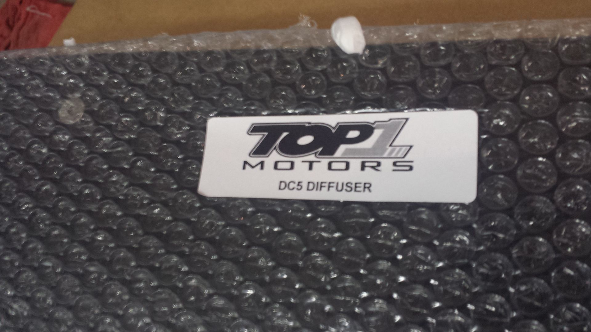

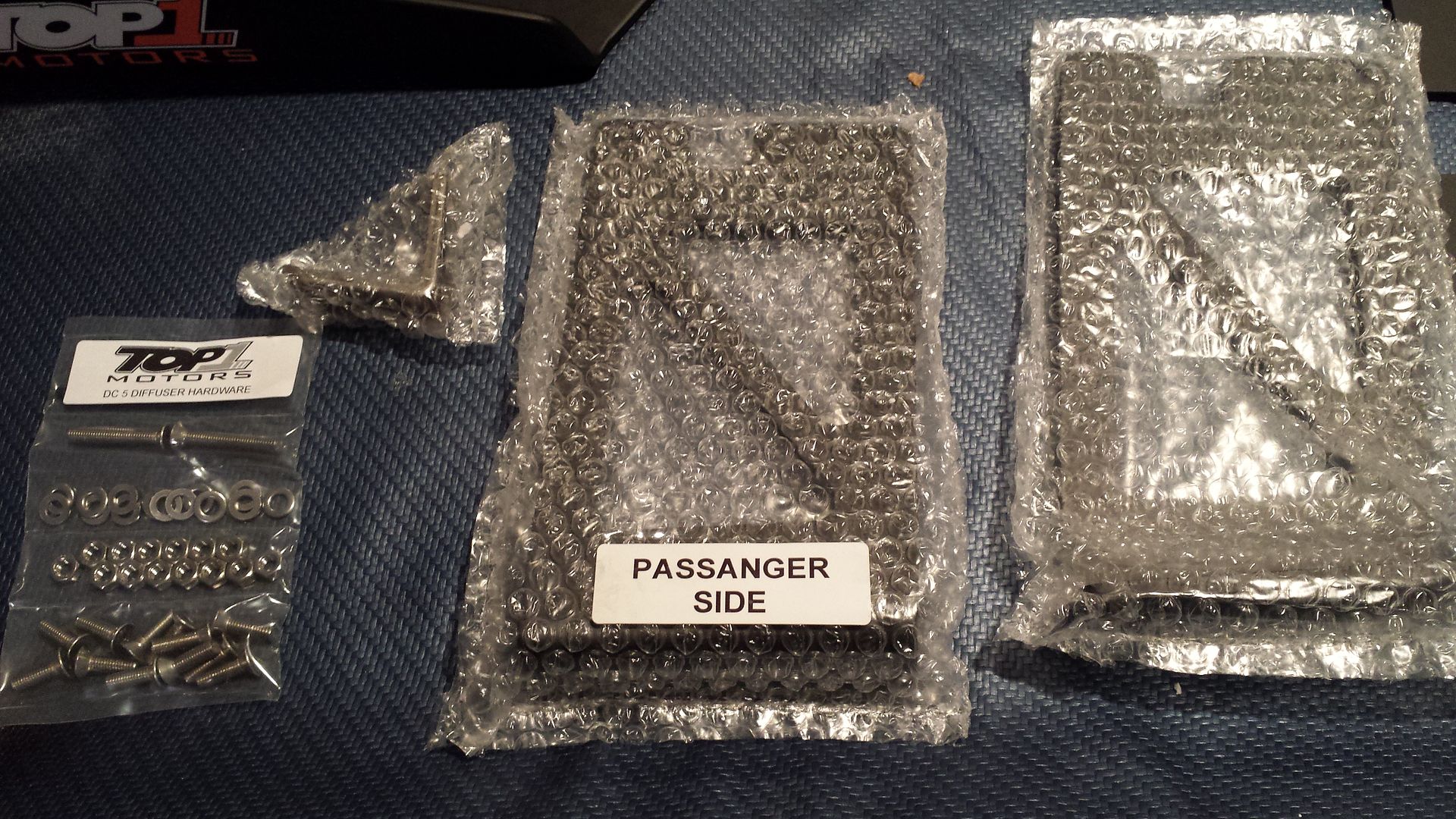

So I got all excited and started unboxing it all
http://i918.photobucket.com/albums/a...ps4cdc5eaa.jpg
http://i918.photobucket.com/albums/a...psf18603b6.jpg
http://i918.photobucket.com/albums/a...psad594ef0.jpg
http://i918.photobucket.com/albums/a...psb6cba415.jpg

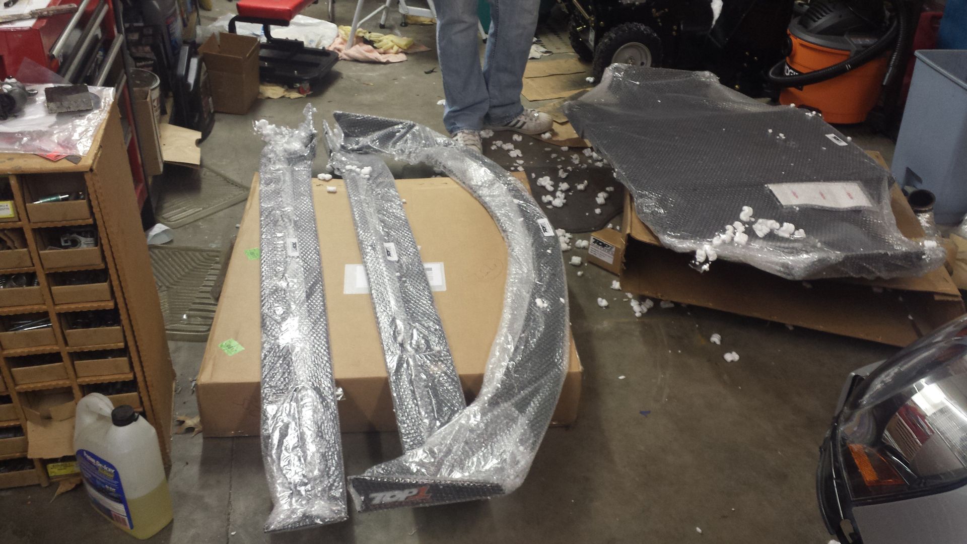

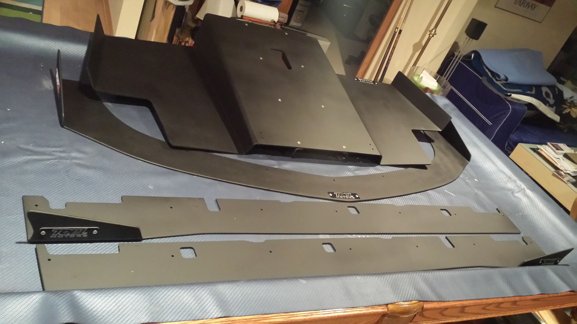

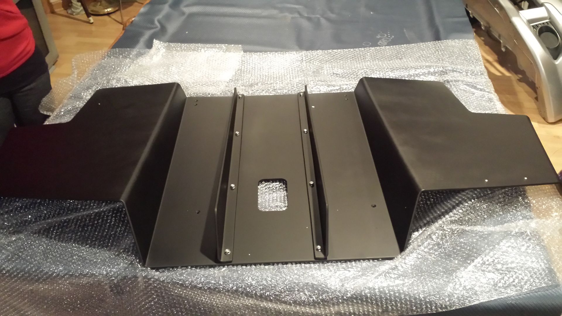

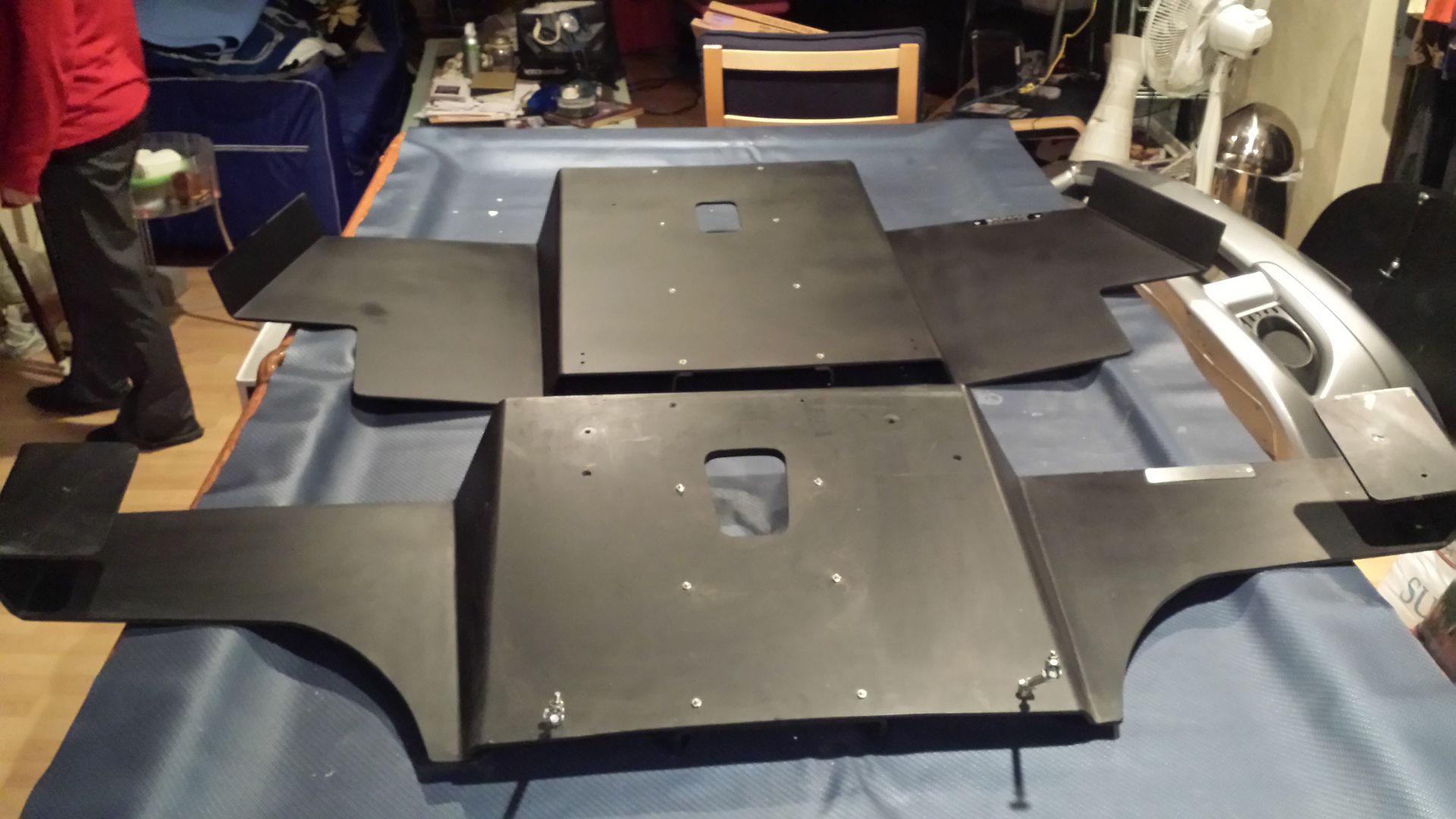

Then took it all to the basement to unwrap and compare them to the old ones. Put my girlfriend to work :)
http://i918.photobucket.com/albums/a...psb023fdd2.jpg
Look at this sexy beast...
http://i918.photobucket.com/albums/a...ps2ca638d7.jpg
http://i918.photobucket.com/albums/a...ps53692090.jpg
http://i918.photobucket.com/albums/a...psaea9fead.jpg

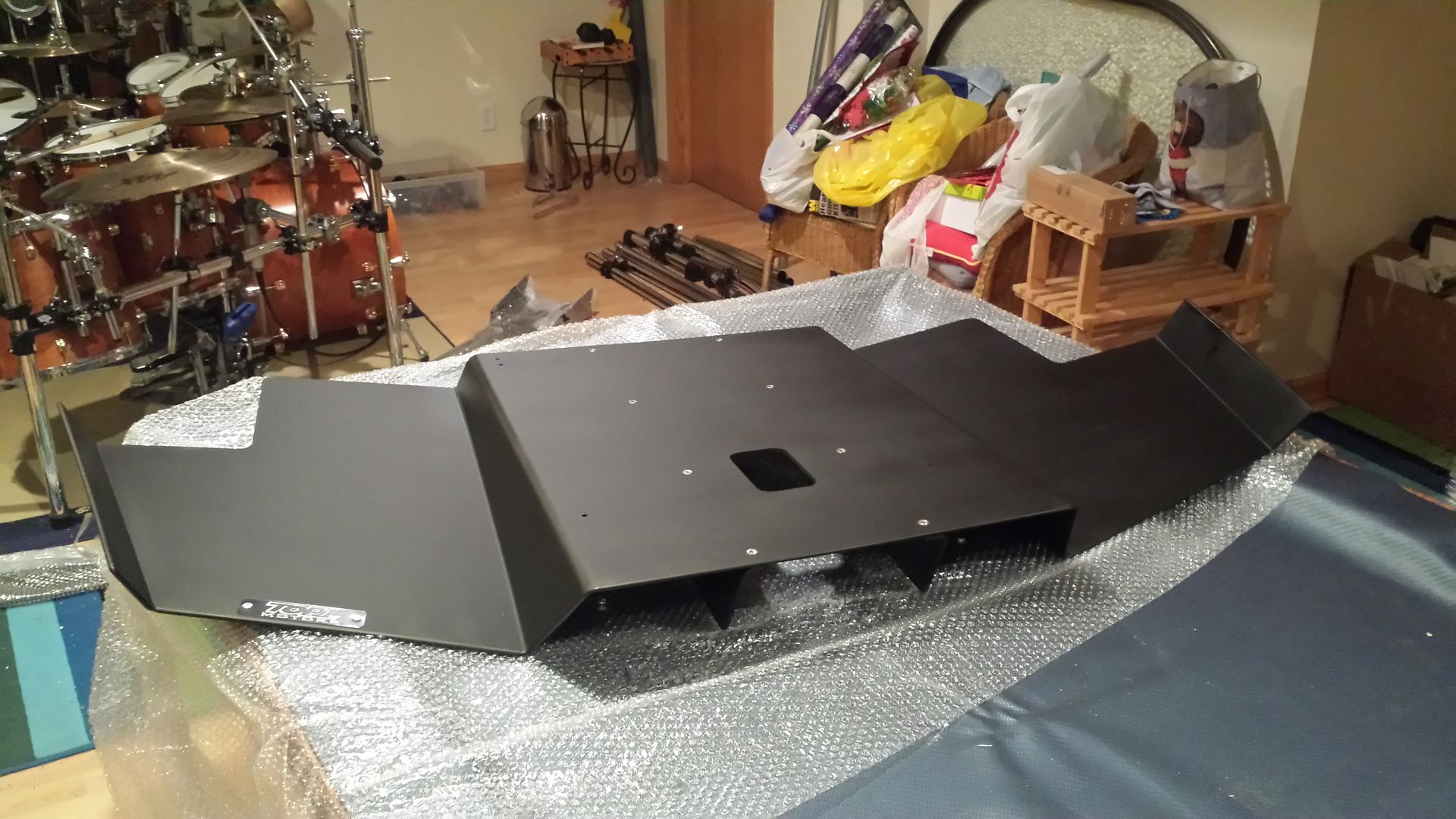

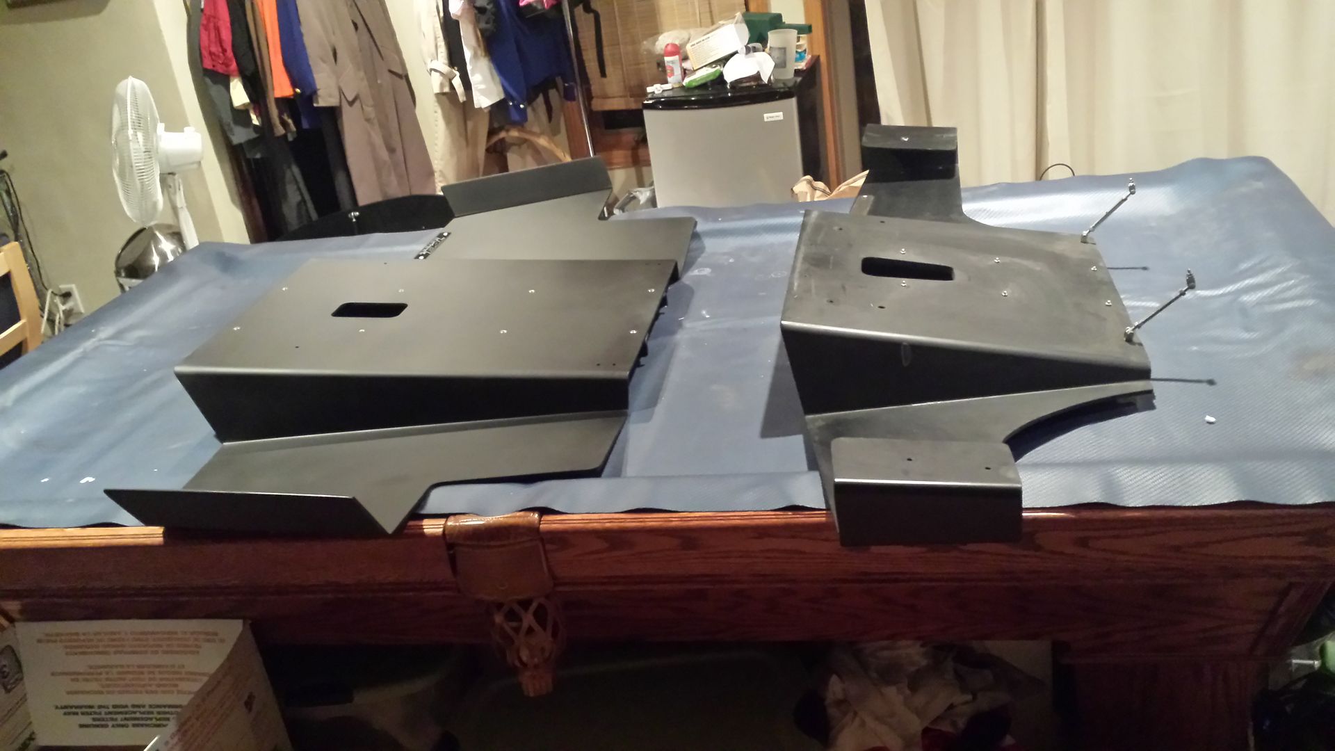

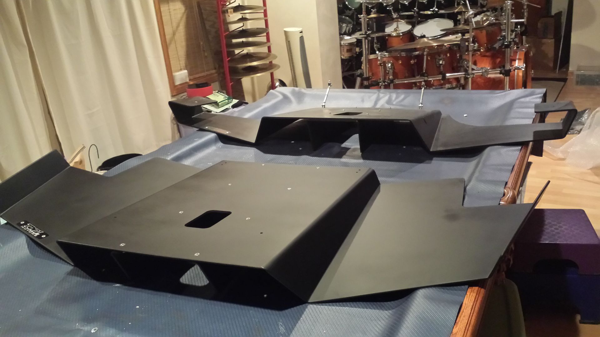

The new diffuser is HUGE compared to my old one...
http://i918.photobucket.com/albums/a...pse4865900.jpg
http://i918.photobucket.com/albums/a...ps9ecf504f.jpg
http://i918.photobucket.com/albums/a...ps816270ff.jpg

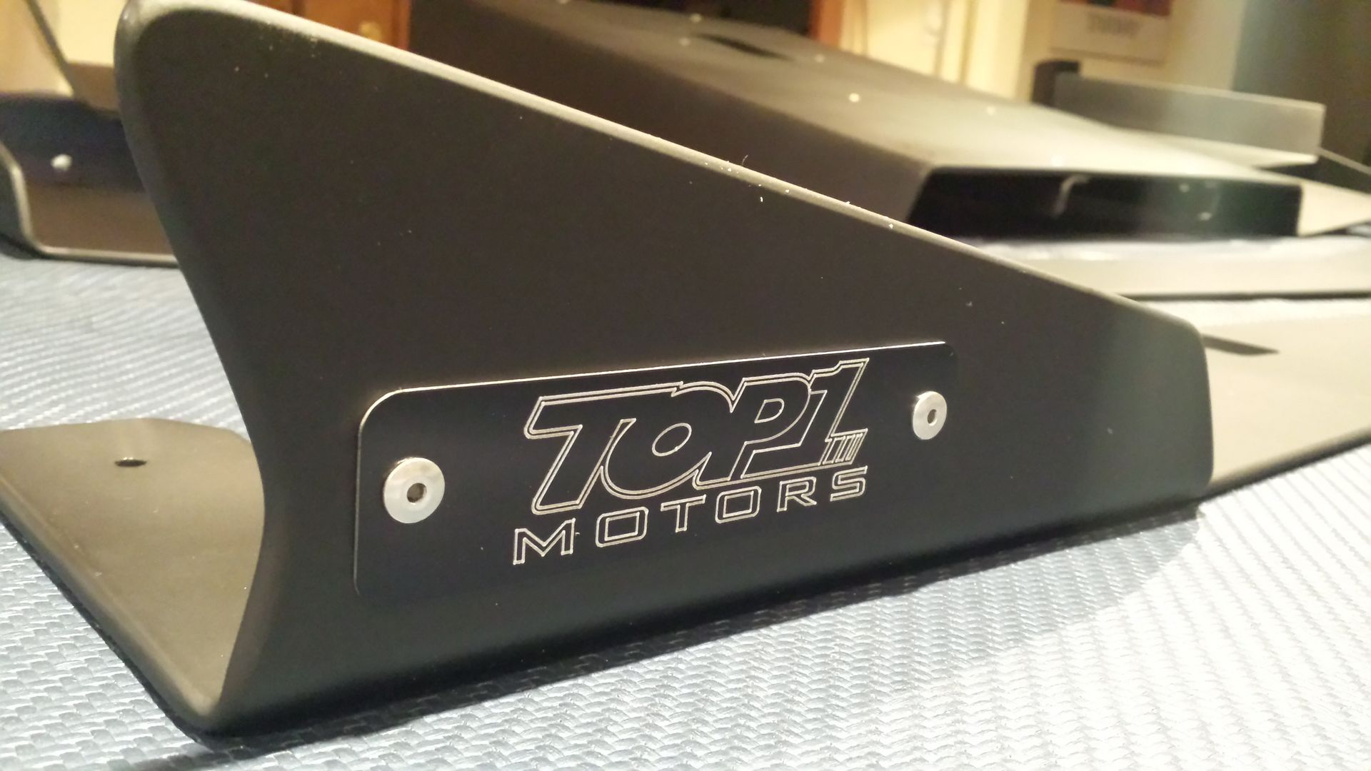

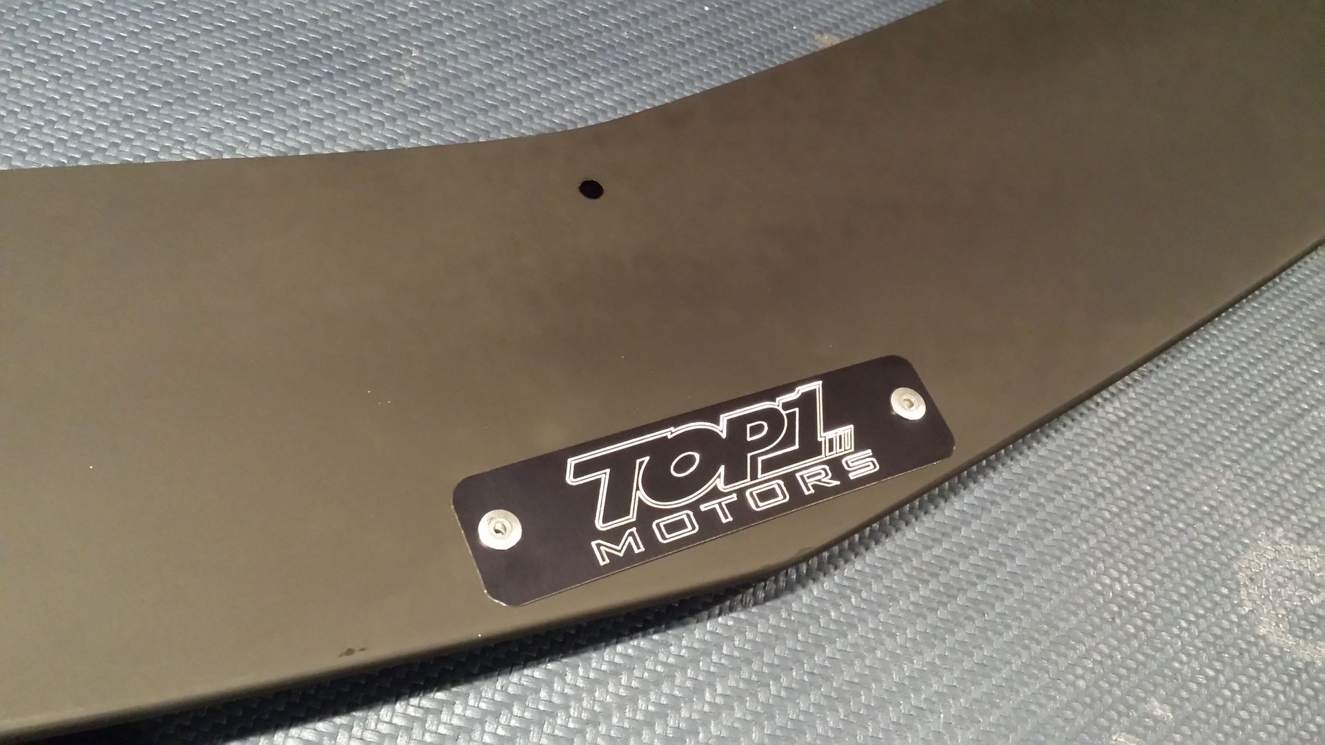

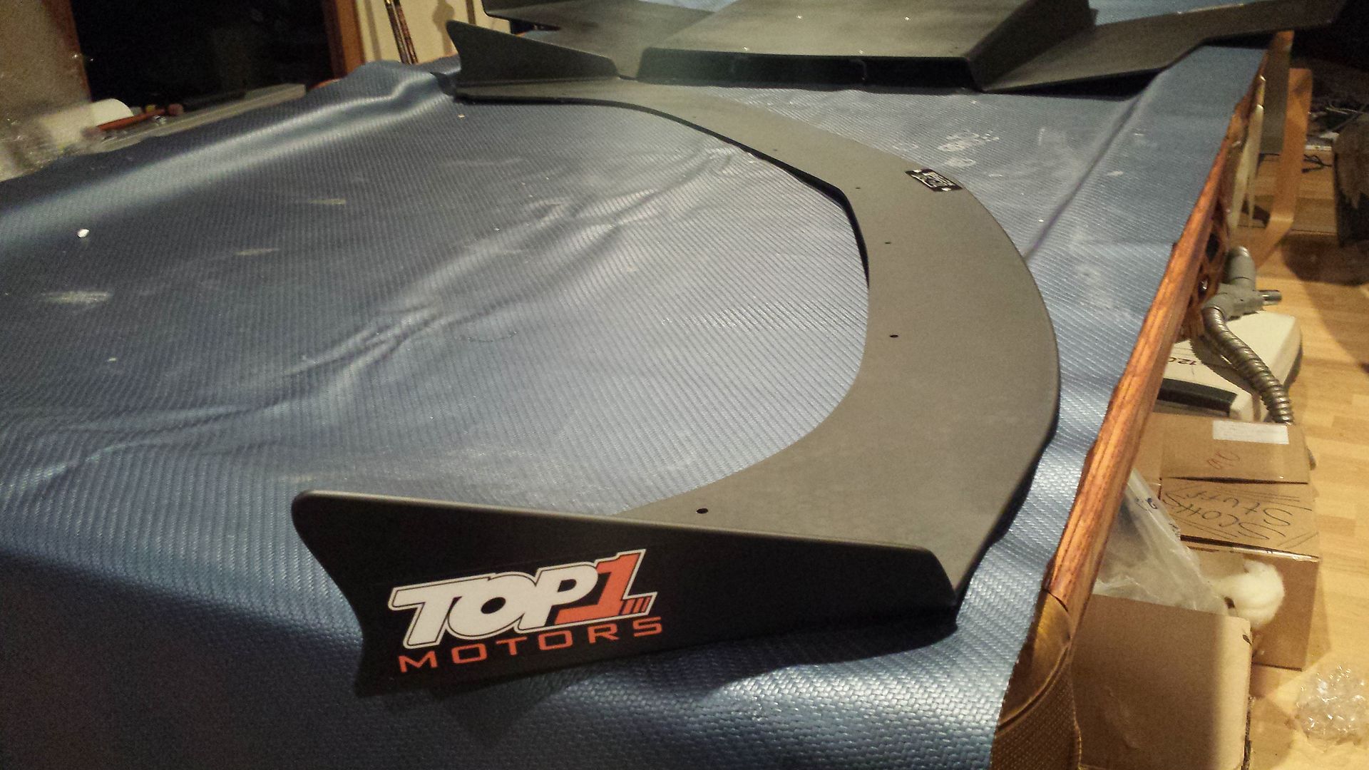

The new front lip with built in winglets...
http://i918.photobucket.com/albums/a...ps55992bb7.jpg
http://i918.photobucket.com/albums/a...ps99200304.jpg

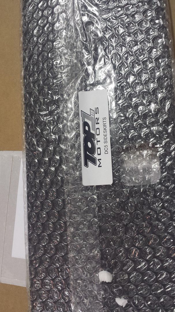

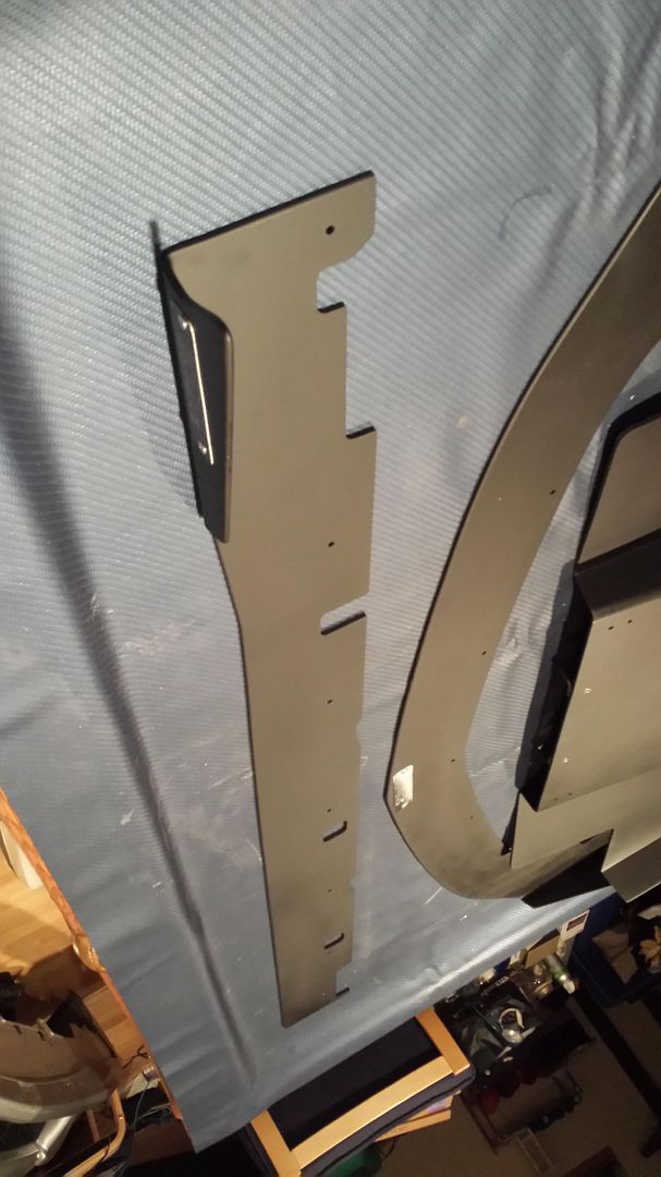

and sideskirts
http://i918.photobucket.com/albums/a...ps6afc6ae0.jpg
http://i918.photobucket.com/albums/a...ps585f27b8.jpg
The new TopOne full setup
http://i918.photobucket.com/albums/a...pse809b4f6.jpg
and then all the mounting brackets
http://i918.photobucket.com/albums/a...psf487e0c4.jpg
