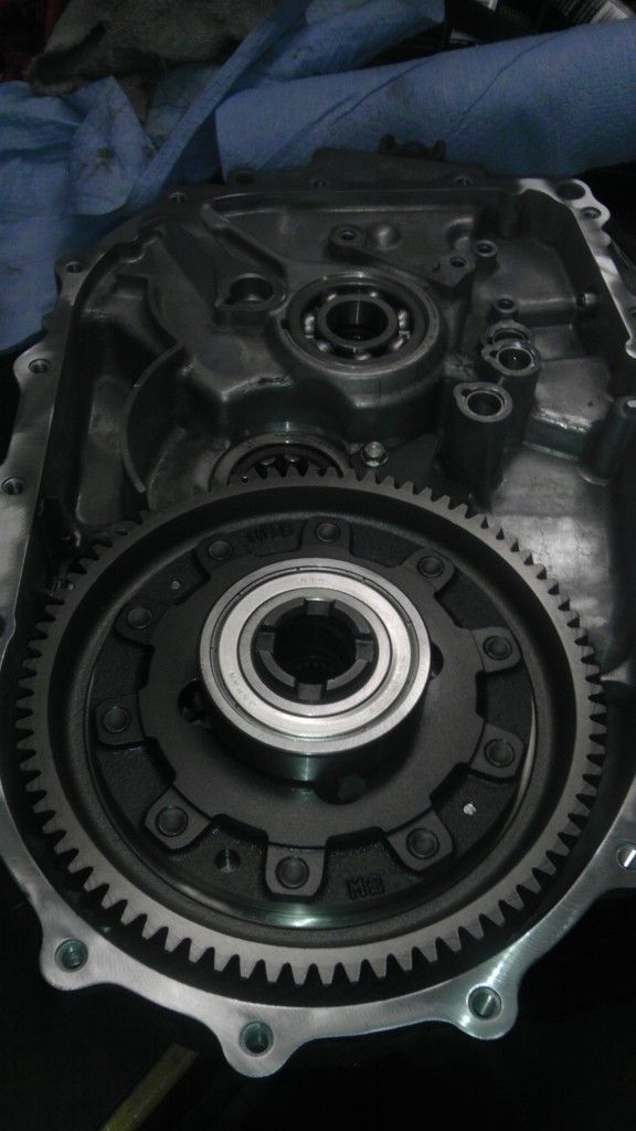

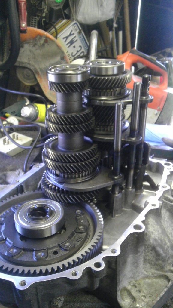

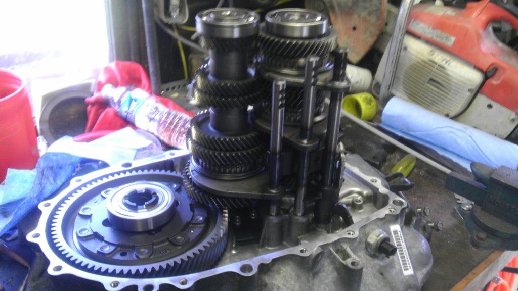

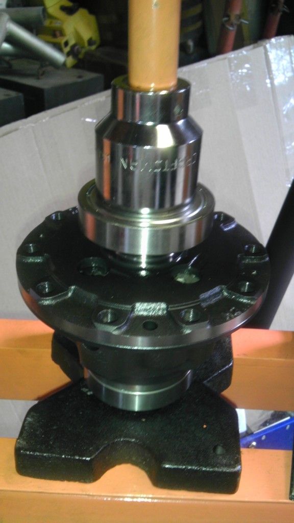

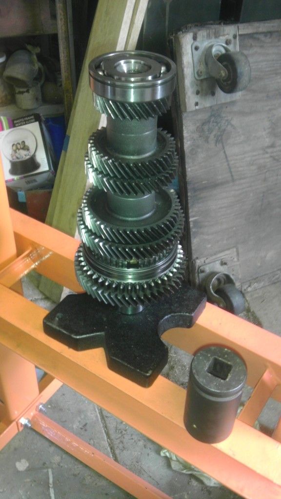

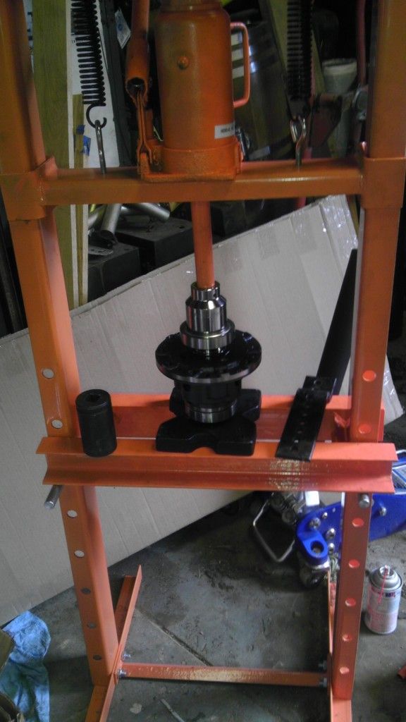

got the gears/syncros/tranny shafts all pressed together as well as the new bearings on the LSD and final drive torqued back on!
http://i901.photobucket.com/albums/a...d/IMAG0474.jpg
http://i901.photobucket.com/albums/a...d/IMAG0475.jpghttp://i901.photobucket.com/albums/a...d/IMAG0478.jpg
http://i901.photobucket.com/albums/a...d/IMAG0479.jpg

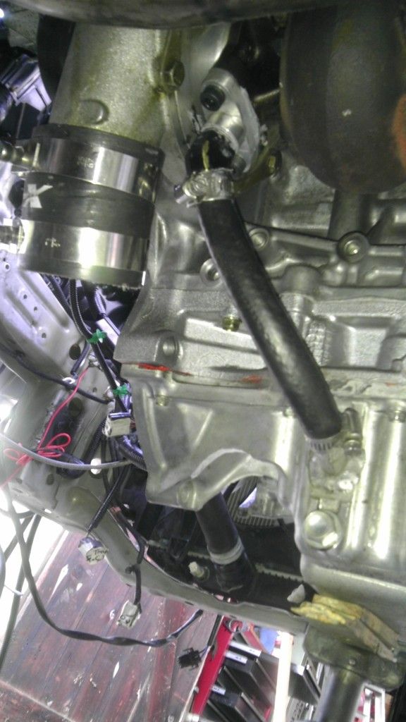

Some final pictures of the build:

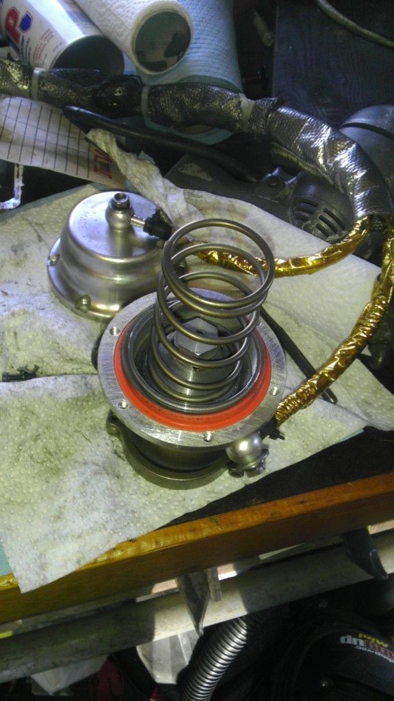

Installing the 4.3psi wastegate spring
http://i901.photobucket.com/albums/a...d/IMAG0483.jpg
A very nicely angled oil drain:
http://i901.photobucket.com/albums/a...IMAG0484-1.jpg

The final trans pictures before re-sealing the case
http://i901.photobucket.com/albums/a...d/IMAG0488.jpg
http://i901.photobucket.com/albums/a...d/IMAG0487.jpg
