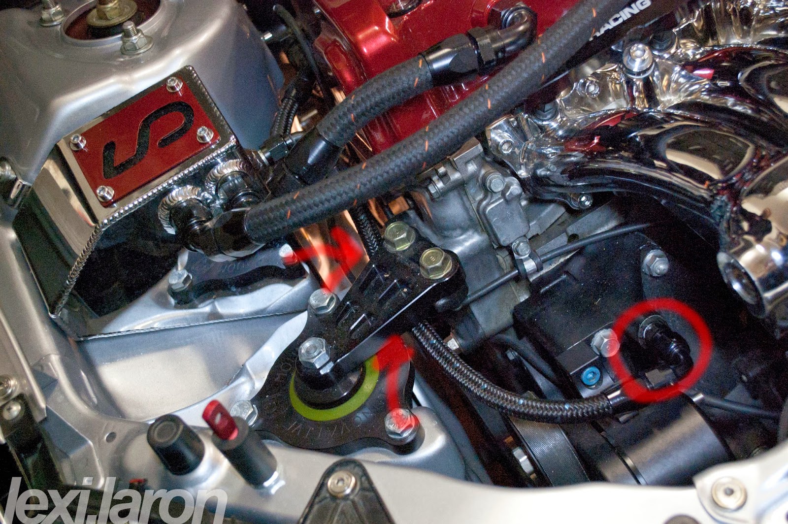

Very excited to be able to put my sway bar back on this season! Rewelded a new bung on the downpipe to clear O2 sensor from sway bar.
http://i918.photobucket.com/albums/a...pschrlx7ok.jpg

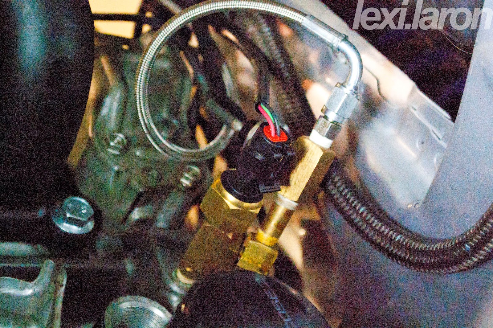

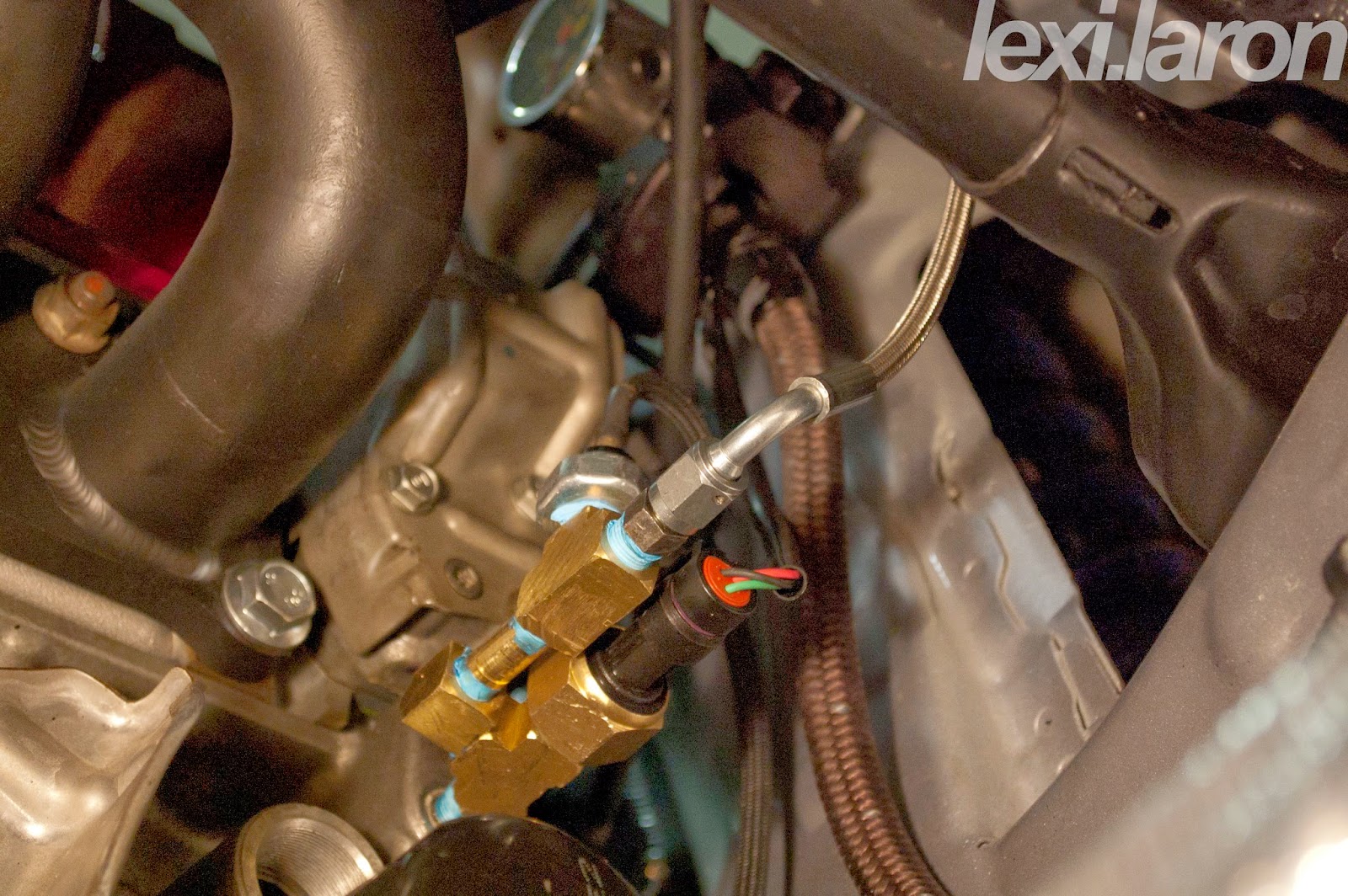

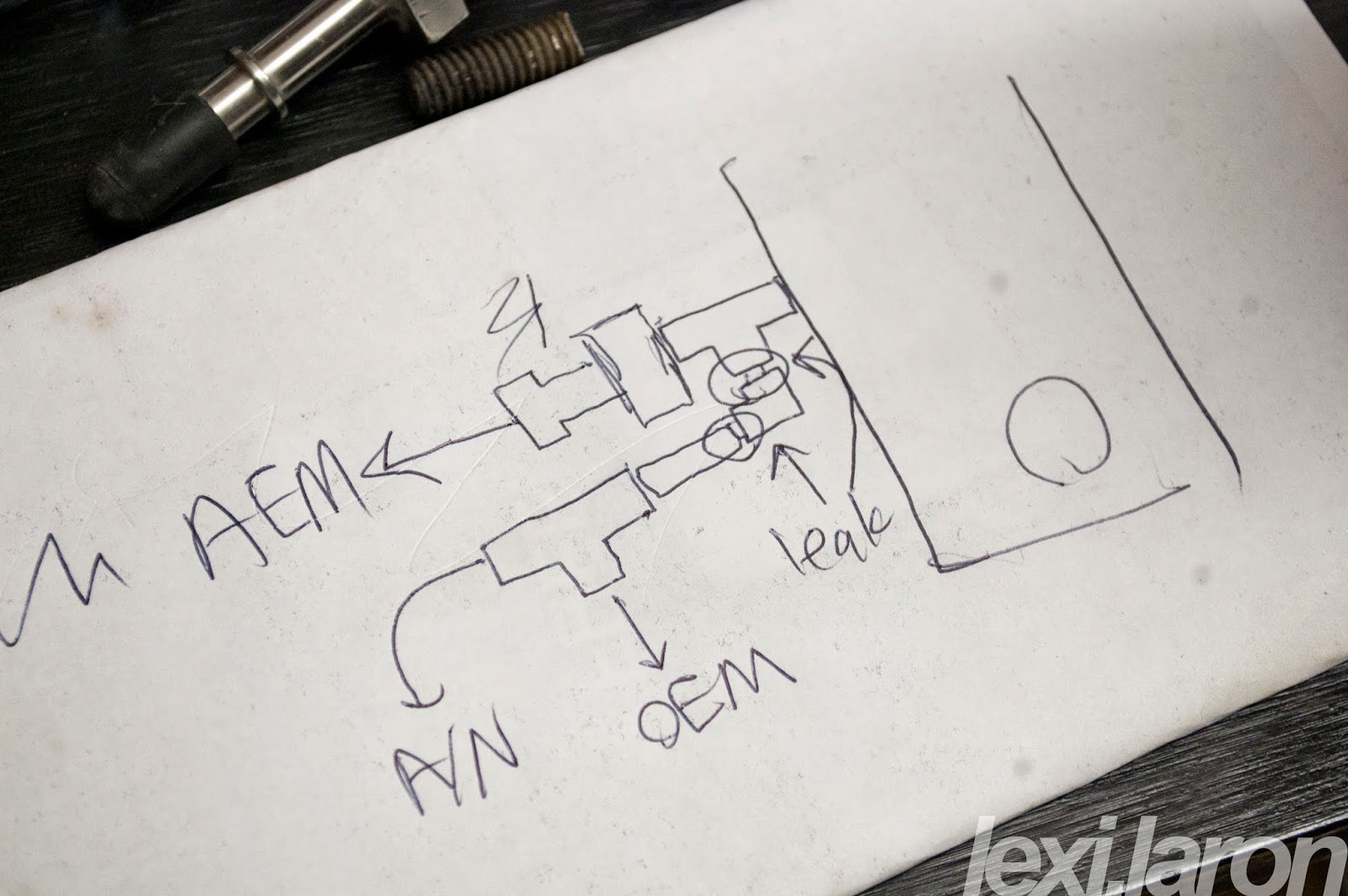

We started out the day by fixing an oil leak that Zack chased down to a "Christmas tree" of plumbing tees for his AEM oil pressure sending unit, OEM sending unit, and turbo feed line. Here's where we started:
http://4.bp.blogspot.com/-cZ24boJZiL...g+the+Leak.jpg
Good idea of where the leak was at:
http://4.bp.blogspot.com/-3lwbEb48hX...d+the+Leak.jpg

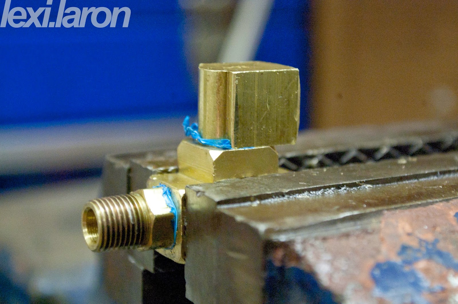

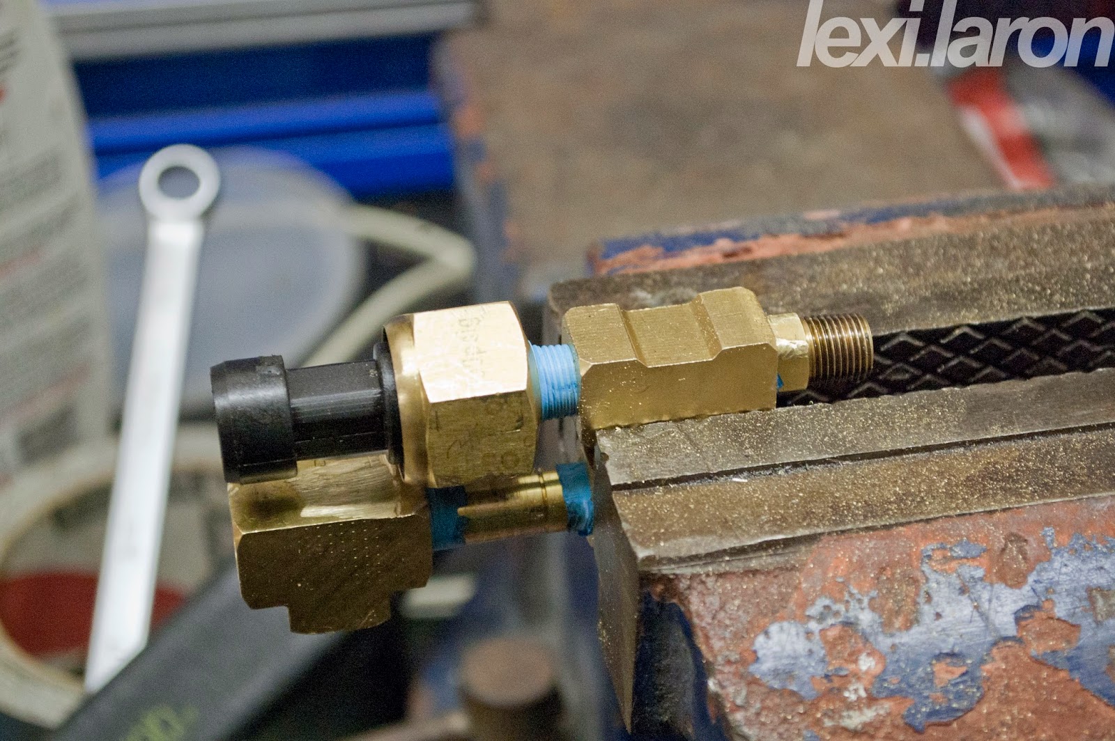

So I wrapped some "heavy duty" teflon tape around a brass elbow fitting and put it back into the tee as tightly as possible.
http://3.bp.blogspot.com/-g3tItyjsJE...nd+the+Tee.jpg

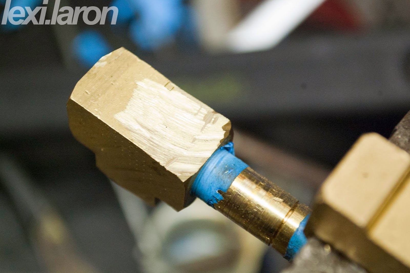

To allow the elbow to connect to the AEM Sending Unit I had to grind down the tee's backside:
http://3.bp.blogspot.com/-48W7hS4Wfs...e+AEM+Unit.jpg
Voila
http://4.bp.blogspot.com/-sTxVPOTAZp...e+AEM+Unit.jpg
Got under the car and went Santa on this b*tch...puttin' Christmas trees up in this b*tch.. :fyea:
http://3.bp.blogspot.com/-YGh9po7HZb...d+Fittings.jpg

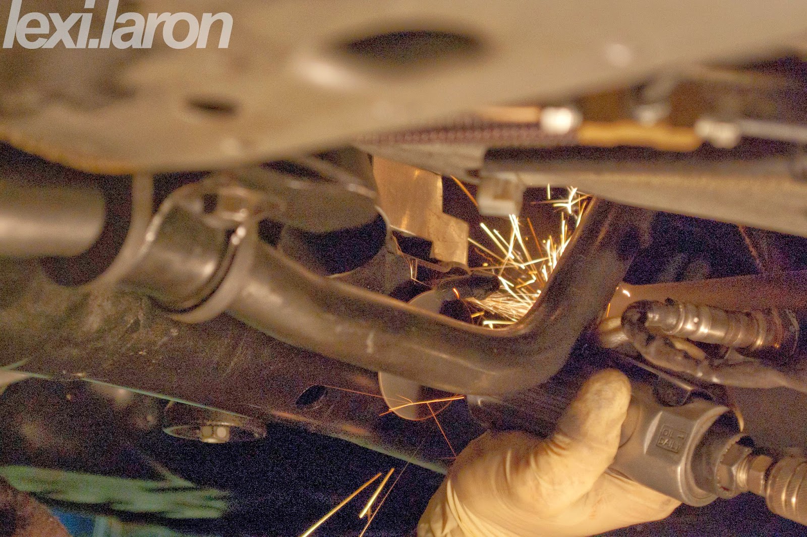

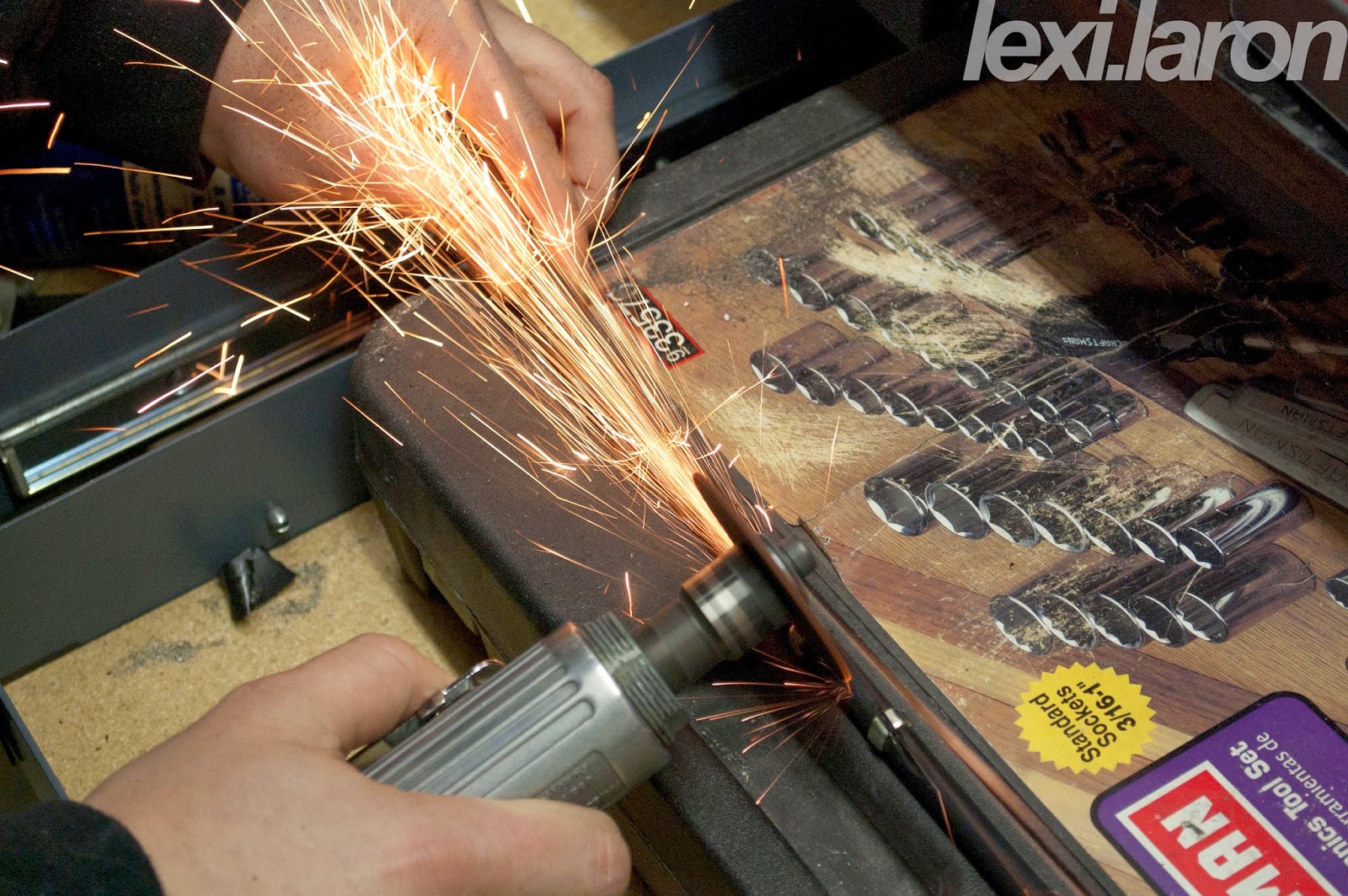

Some other odds n' ends we took care of include a new throttle cable which you can see Spaz cutting metal crimps off of here:
http://2.bp.blogspot.com/-kUwxWeqd02...the+Crimps.jpg

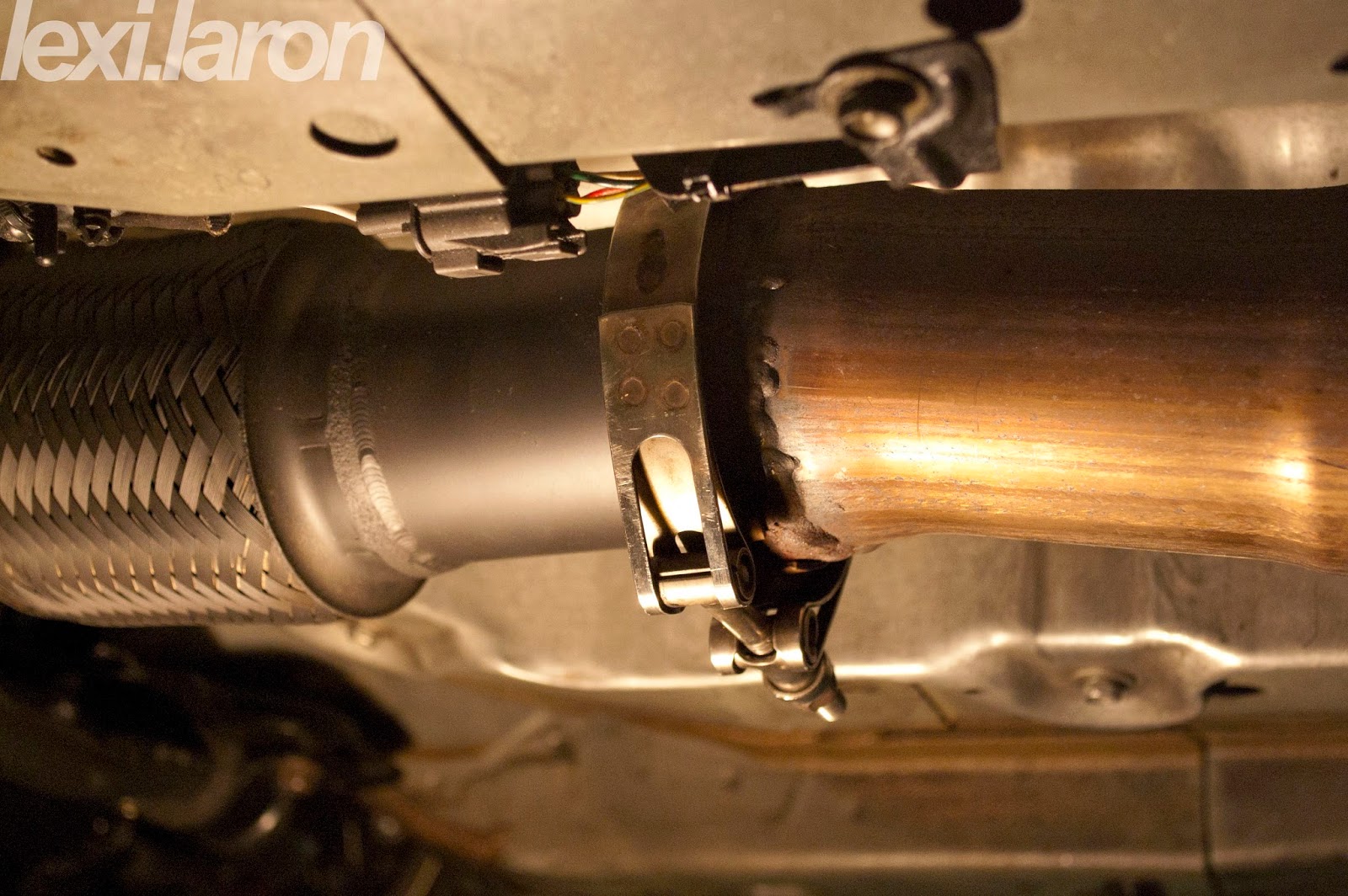

Clamping up the DP:
http://3.bp.blogspot.com/-BM78AUv4Ai...he+Exhaust.jpg

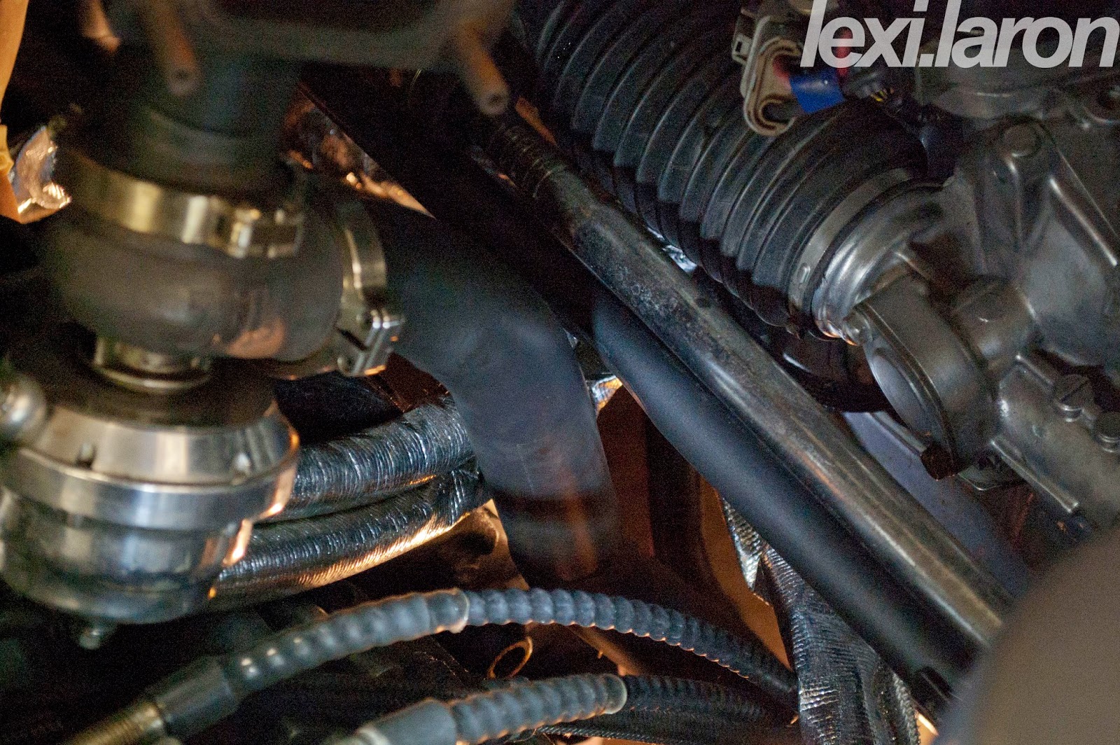

Mocking up the turbo with the painted cold side and ceramic-coated hot side:
http://1.bp.blogspot.com/-AKNyl6aRfN...+the+Turbo.jpg
